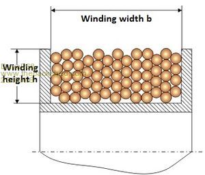

There seems to be a bit of a misunderstanding of how wire diameter affects the power output and/or efficiency of F&P stators.
Yes thicker the wire the higher the current output but lower the voltage output of the stator. So the 100s has the larger wire diameter of 1 mm.
In fact the most efficient stators, that also put out more power are the 60s 42 or 36 pole copper stators.
The main reason for this is how much the total volume of copper that can be wound on each pole.

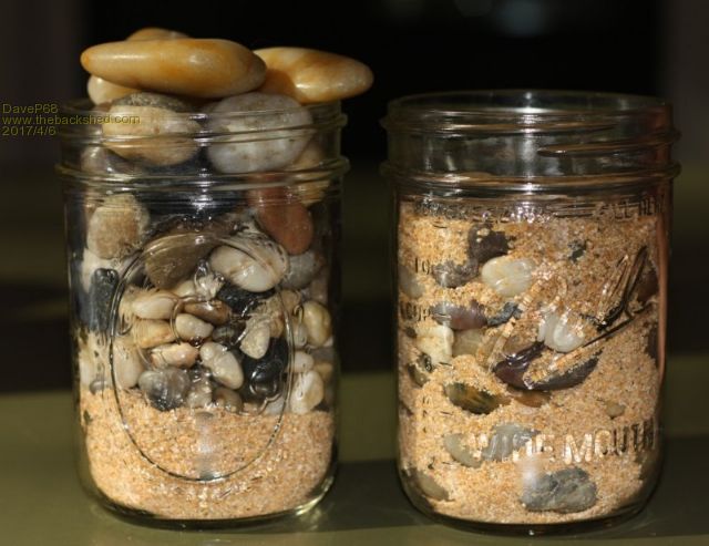

Please refer to the pictures below.
Notice the air gaps between the wires of this coil cross section.
Now your probably thinking I'm nuts showing you 2 jars in the lower picture with small rocks, stones and sand. What these illustrate is that as the wire diameter is made lager the air gap between wires grows at a disproportionate rate. So if we fill a jar with just sand most of the space is taken up. Hence 60s stators have 0.6 mm wire diameter so are closer together with less air gaps.
