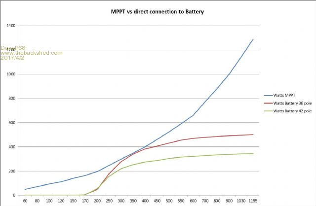

Refer to the table below for how MPPT actually works on these stators. Please note no reference is made to RPM.
Having done most of my testing with 36 pole copper stators with black rotor caps I find them the best. That is due to them being 'Factor Decogged' and having 12 poles per phase they can be re wired into more combinations 1x 12p, 2x 6p, 3x 4p, 4x 3p, 6x 2p & 12x 1p. The 42 pole stator can only be wired into 1x 14p, 2x 7p, 7x 2p, 14x 1p.
With the above conditions met the 36 pole copper stator can output 41% more power than a 42 pole 60s & 80s and 47 % more than a 100s for the same RPM.
I'm not saying the 42 pole stator are no good, just pointing out their limitations as they are after all older older technology.

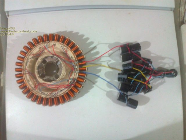

Refer to the Photo of my crude setup which isn't as tidy as Phill's.
The capacitors are 280 uF AC (2x 560 uf 250 VDC). Voltage was 87.5 Volts at 8 Amps. Fred has a 45 - 90 VDC input Grid Tie Inverter so that is why I did it in that configuration to prove it would be compatible for 1 of three different stators he plans to put on his new Wind Turbine build.

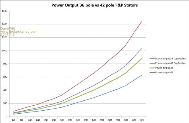

Yes the 42 pole stators can put a bit more power out than I got before due having the corrected capacitor values in the capacitor doubler, now that I've fixed the error in the formula.
Here's a graph with revised output data 36 with black rotor cap vs 42 poles.

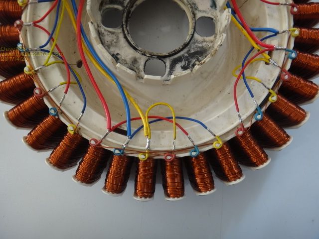

Here is a photo of the finished stator re wire (note the coloured coded wiring).
It looks like a birds nest but works as predicted.
Yes they can be a bit harder to re wire with 0.6 mm conductor size and goes to show that wire diameter doesn't limit the current.

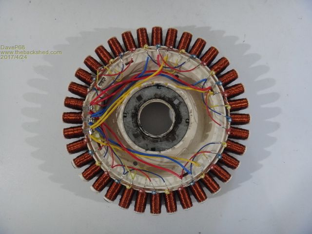

Here is a close up of the wiring configuration on that 36 pole 6x 2p Delta stator.
Note the wire lengths are all the same on connections phase to phase "Red-Blue, Blue-Yellow, Yellow-Red". This keeps every as uniform and/or symmetrical as possible. If there was even a small current flowing when output is open circuit I wold notice it as a form of cogging even at low to medium RPM. Have noticed anything like that so far.
I'm still going to take your point on board by opening the delta loop and measuring the voltage and circulating current across the break.

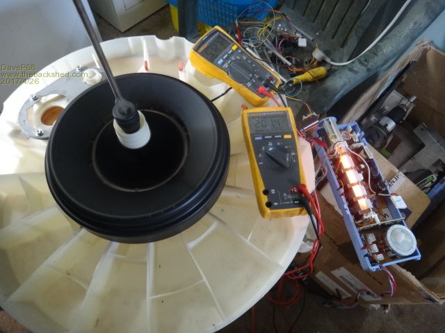

That is some serious current, 100+ Amps DC...
Personally I don't know why it seems to be just Fred & I on here who have done lots of testing with these newer 36 pole copper stators (don't touch those aluminium ones). Getting 40% more overall power when load matched correctly with black rotor cap has to be a good thing.
In my opinion they are just a better all round stator with the black rotor cap. They are factory decogged, so no need to get the angle grinder out to decog those older 42 pole stators.
This is why I've published so much data on them, so one day a few may find my results of use.Edited by DaveP68 2017-04-26

Have a new approach to this concept using a 36 pole stator 4x 3p Delta but with 2 outputs feeding in 2x capacitor doublers.
Each capacitor doublers can then be high speed switched using FET's to put the outputs in series 2x 6p or parallel 4x 3p at a 260 RPM switching point RPM going up or 200 RPM going down.
Example;
The default state the switched stator is ste to a start up is 2x 4p with o/p's of cap doubler in series and cut in is around 80 - 90 RPM. It's peak current in this mode will be 4.5 Amps. At 260 RPM 4x 3p delta 57 VDC with 6 A ~340 W.
Meant time the second stator set up as a 6x 2p delta is cutting in at 260 RPM with same volts with 3-4 Amps. At say a peak of 500 to 550 RPM the current will be at 22 - 24 Amps which could work out to be a power of up to 1250 - 1400 W form a dual stator on a 2.8 - 3 m set of blades.
The FET's need to be high power fast switching and very low on resistance, with a make before break switch over so stator doesn't see an open circuit condition.
There is a bit more to the switching system than what I've explained here. As the make before break will put the switching stator into a resistive load at change over so things don't get carried away voltage wise. Also the switch back happening at a lower RPM of about 200 RPM using a form of hysteresis.
This configuration will provide the best load matching set up to a 48 VDC batter system so no stator goes into saturation.
Got some of my new inspiration from what you posted back on 4 April using an a feed forward system with wind speed with an anemometer quite independently of the main wind turbine.
What are your thoughts?Edited by DaveP68 2017-04-26
