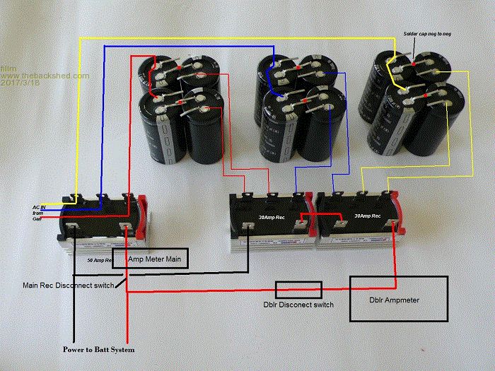

The illustration below is how to correctly configure the DC Caps , by putting them bac to back -++- or +--+ in this configuration turns them into an ac capacitor , The Capacitance Value will be ½ that of what is on the individual Cap , so if we have a 680uF 230V then it becomes 340uF 230V when reconfigured to AC Coupled . Higher voltage caps must be used that will clearly give a margin of safety if the mill becomes unloaded. People have used little uF / voltage caps and wonder why it doesn’t work.

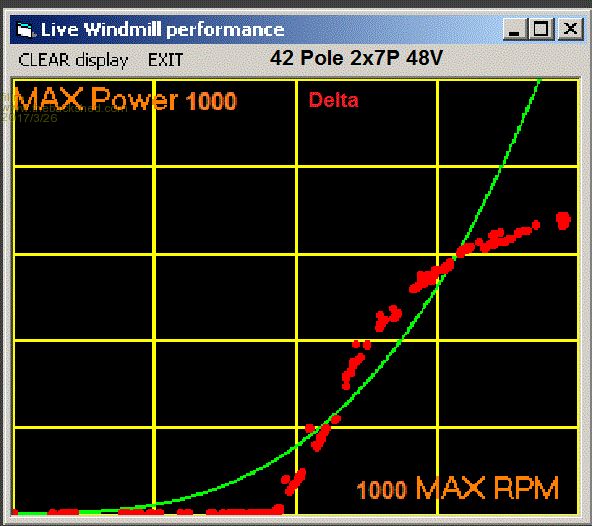

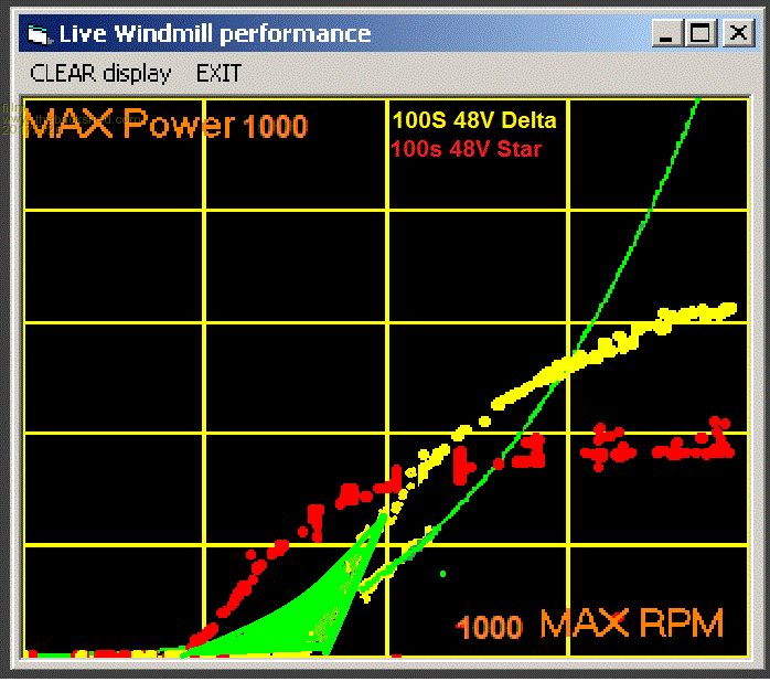

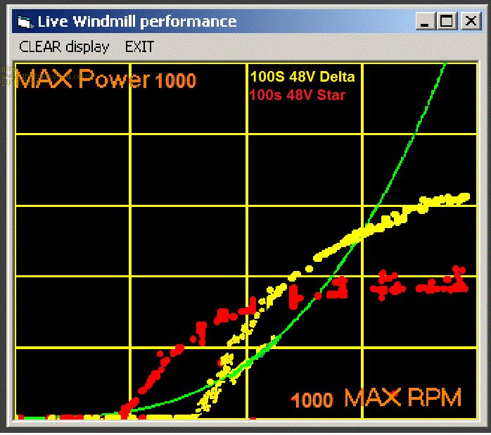

Below is a good example of what the doubler can do , the red trace line is on the right logger is a 2kw Huaya with the 3.1M GOE222 . It can be clearly seen the curve up to the point where the main rectifier starts at normal cut in. What it also shows is a complete shift in the power curve. These are 1600uf and the blades are still kept in a good operating range. The Left is the identical with std 3.2M Fiberglass blades , putting a doubler of this capacity on this would be detrimental.
As I have pointed out before, if the blades can give power and you don’t over load them it can work perfectly . BUT also what gets given in better low wind also limits high wind performance, that can also be seen above.

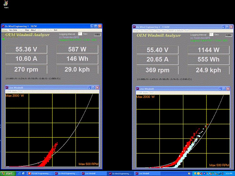

I have done some retesting on my test bench recently to see what the Black Cap rotor , these were done up to 960RPM on a few different configurations 6x2P 4x3P and even 12x 1pole and as Dave has stated there is an increase in power over a 100S , Yes there is but it definitely does not rule out 42poles as a waste of time . If set up correctly as a dual both will perform the same I given the same blades and matched winding resistance. The black will output more in higher wind speed.
In reality with a F&P dual powered with the GOE with black rotors or 42 pole at over 2.8m Blade and not severely over loaded there is no problem with outputting very good power and with the right combination of I can easily see 1.5 kw @ a 48V system and a bit lower for 24V AT Rpms in excess of 800Rpm . If you have ever been close to one doing that it’s a scary site.

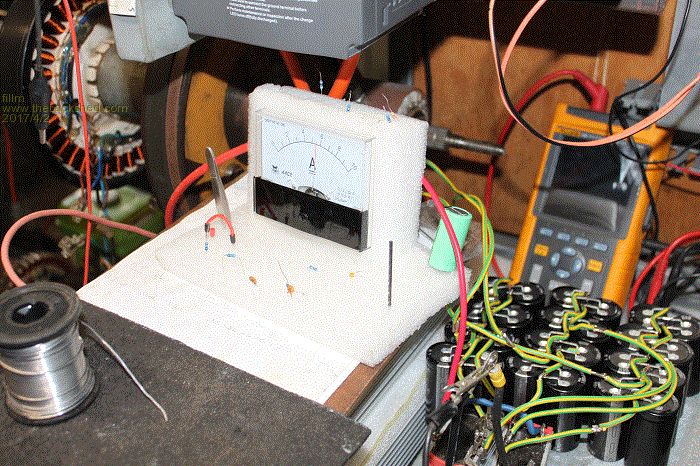

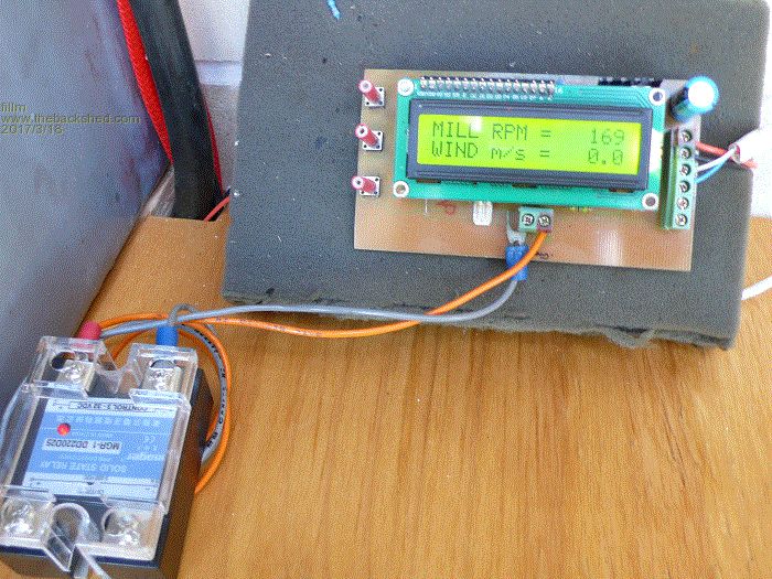

Below is a pic of a RPM & Wind speed monitor that Pete is the brains behind. It can also switch a relay at a given RPM but he modified the program to be NC until a set RPM. Here I was playing with turning the doubler off at X rpm and this allows a bit better upper output. That’s as far as it got and lives under a bench.

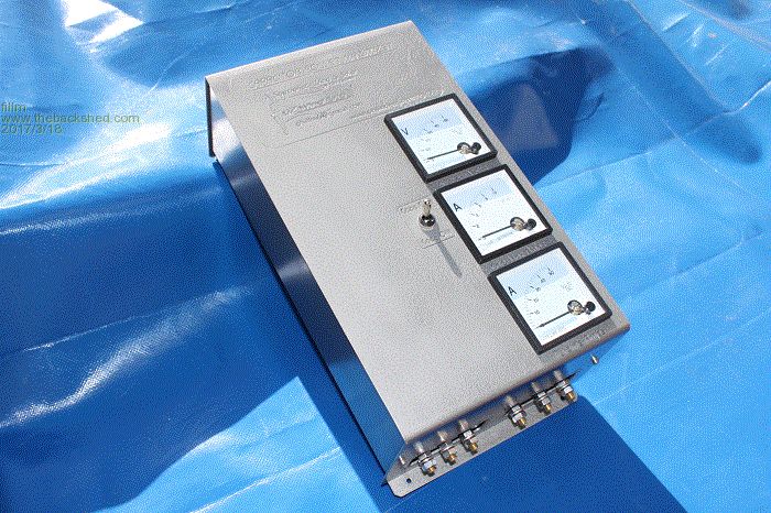

Below is a complete Capacitor Doubler I have done for some in the past, re-badged as the “Capacitor Power Maximizer “ and it has all contained in and gauges on both . The doubler can be turned off just to show it works.

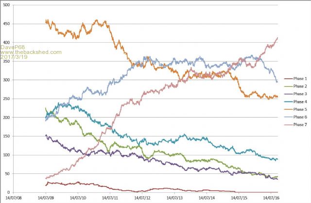

As you will already know I service the very F&P washing machine all these stators come from and below is a graph of numbers of machines I've seen over 9 years (rolling annual total) as per each version made. You must have a big stash of the 100s, as I haven't seen one of those Phase 1 machines for 2 years. The 80s (Phase 2-4) are still around in good numbers as per the graph 12% of total units I've serviced in the last year.
The Phase 7 machines that have the 36 pole copper stator account for 35% (Have removed Phase 8 + Phase 9's models from graph as they have Aluminium stators which are of no use).
My advise is to start switching over to using 36 pole copper stators, as you are going to be forced to sooner or later.

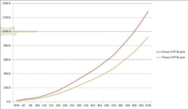

My test results show into the "same load" a 36 pole copper stator with a black rotor cap will produce 40% more power than a 42 pole stator over the same RPM range (60 to 1155 RPM). Refer to the graph below showing difference in performance between the 36 and 42 pole stators.

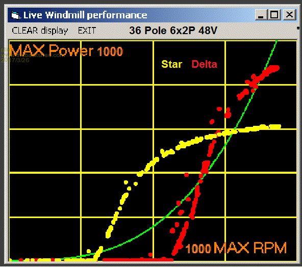

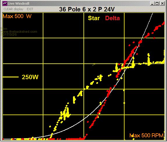

Here’s one of many test’s, this is the 36pole copper at probably 54-55V into Lithium Batts. Yes they can deliver more at the top end but as shown here its barely 20% over a similar impedance in a 100S. At the upper RPM the 100S is at 850W and the Black 36 at 950W, at that given point its probably 12% and its not going to change with higher RPM as both are reaching saturation. And given the 100s has a slightly lower cutin would help as a good candidate for a doubler. I have stated before a 80S and a 100S as a dual is a great combination. The main problem is 100S are rare now but an 80S can be set up to almost be the same .
I do not test into factitious dummy loads but more where the reality of normal simple battery systems operate.
I also do not dispute that in an ideal situation the the 36 pole Black Rotor can deliver over 1kW but again its not going to happen as a std stator due to the fact its .6 wire. This then calls for your so called "Cuts" or Re-Wires as we know them over here in Aussie Land.
* The above graph is in 500W / 500Rpm Scale , also the risers in the yellow is the voltage difference in the dump as th@ 24V is on a small LA Batt Set .
Again this would give a good result with a doubler as a dual for 24V ( dual Delta = Doublers ) and can easily get to over 800W @ 500Rpm. Even better would be one star and one delta no doublers required , this would give a good over all performer.
Above would be the a good ideal solution for a 100S Std in Delta and if the correct capacitance was used you would get close to what is shown below in the green fill in , this would give " Power where before there was none " and not cause excessive loading.

Why I put the graph of number of machines serviced on the post is very relevant to the topic if you are making any reference to F&P 42 pole stators. The point which you seemed to miss is that the number of 42 pole stators being available is dropping off! The 36 pole stators are now available in big numbers...

  fillm said   And in that condition it outperform the best 42 pole by 40%, fair enough that is your opinion and it probably is a fact.
It's not my opinion it's just a fact.

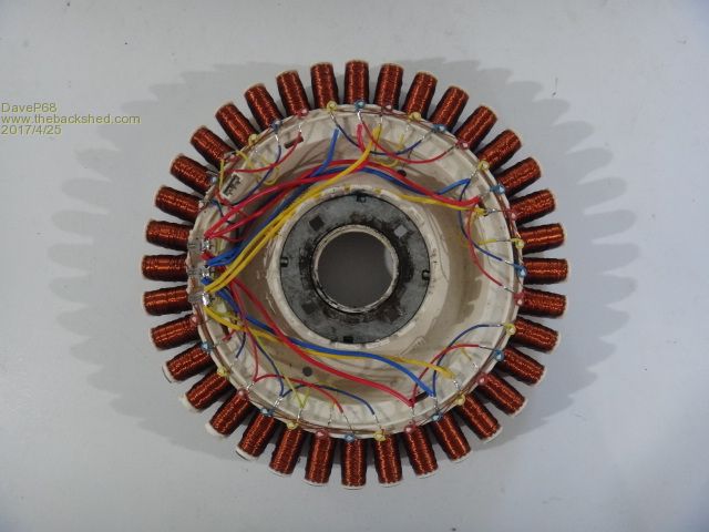

  fillm said   As A bit of an add in - I have been putting together various forms of DC Engine powered Generators. One version is F&P based with a Dual black 12 x 1 Delta and is capable of 2.2kw but at 1300 – 1400 Rpm and is one of the options I am looking at designing for fast charge on lithium.
Phill are you sure you haven't set up this Dual black as a 12 x 1p Star? By my calculations from all my experience of these 36 pole stators you should be getting 3.2 kW of power to fast charge your lithium batteries.
  fillm said   So did some tests on your Cap Calc Recommendations - Stator 6x2P 1600uF AC Cap Dblr , not sure if you want the results.. That's a 10A gauge from the dblr into Lithium ... and its also data logged
Looks to me you did the same here too, the stator in the above photo seems to be wired 6x 2p Star. That will go a long way to explain the Amp meter reading of just under 6 Amps.
My set up clearly stated to use a 6x 2p Delta to get the 59 VDC at 12 Amps. My own test results from yesterday prove I was correct all along. The capacitor size didn't matter so much after all if the stator was correctly set up in the first place. Understanding these F&P stator matters if you want to get the best results from them.
In case you need to see how to wire a 6x 2p Delta stator I've included a photo of how I wire mine. The colour coded wiring does make it much easier to do.Edited by DaveP68 2017-04-28

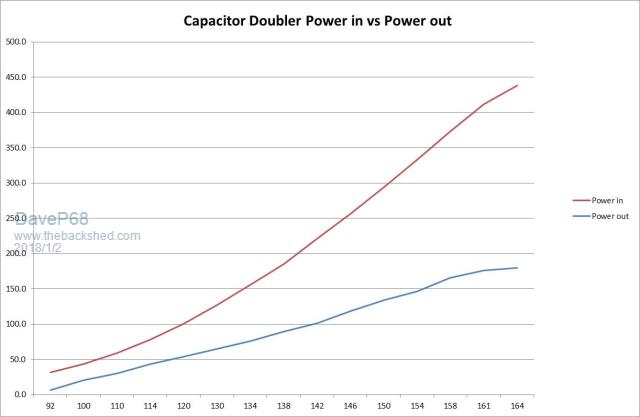

  fillm said   Unintentionally it became a very good form of MPPT at Low to mid wind speeds.
Gordon who also designed his own MPPT Buck / Boost solely for wind at the same time that worked in real time stated there was minimal difference between the 2 .

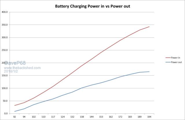

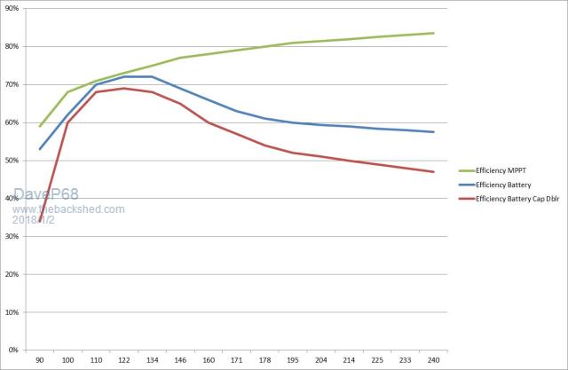

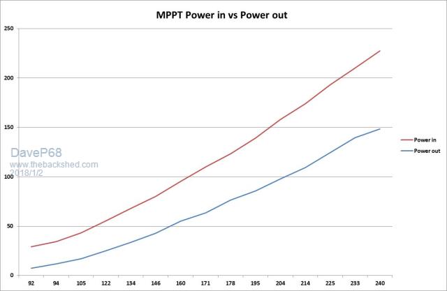

Phill would like to ask if efficiency graphs like this one were ever logged back when all the extensive testing was done on Capacitor Doublers by you and Gordon?
There is a problem with Buck / Boost converters if not set up correctly will take too much current from an F&P stator and limit the voltage rise to the level it needs to go to.
Was it a true comparison to made between a MPPT Buck / Boost solely for wind and a capacitor doubler on 2 identical wind turbines in every other respect?
  fillm said   When I get time I will put all the graphs along with the efficiency torque curve that gives the correct input power.
Phill did you ever get around to graphing the efficiency torque curve that gives the "correct" input power?
Here are 3 of mine so interested to compare what you are able to show from your test rig.
Note the worst result comes from the stator connected to a capacitor doubler!
  fillm said   In real world it comes down to simple and effective matching of blade power to the alternator, chasing the “ IT Can Do XXXXX Watts “ is good to say but in reality count the number of times your wind turbine is sitting at that level . Although some do have serious wind lucky in some ways but it can be tiring I am told, but generally if you have a steady 15 ~20klm Average you have a good site.
Well all I can say is with MPPT you can have the best both worlds. With an efficient power transfer over most of the operating RPM range "will" give way more accumulated power
