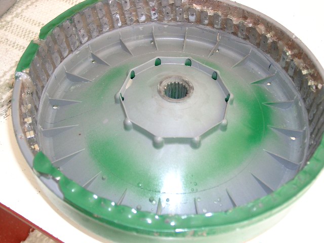

Well,, I finished the new neo Magnet rotor conversion ,,looked perfect ,,nice and smooth inside ,painted, a real joy !!.
Was fitting it on the splined shaft for the final testing , bang!!! it fell off and started rolling down the paddock. I couldn't chase it ,,too steep . I just watched as it rolled down into the bush,maybe a couple hundred mtrs.

I found it this morning under a log,being painted green ,yesterday afternoon was a bit difficult.
It's f-u-c-kay'ed with 32 magnets broken out of it and 3 radial cracks to the housing .. Must have hit every goddammed rock and tree on it journey--we live in pretty wild country up here.
Anyhow ,,Gordon phoned me and came up with an alternative suggestion --go back to ceramics and a stock standard 80 series /dual in parallel. So ,I'll try that .Lucky I have plenty of these F&P stators/rotors here.

Looking at your picture I have a question: I was diddling with two identical neo magnets to see how they behave when placed next to each other.
They did NOT want to sit next to each other on a bit of steel. One magnet always moved to maintain about 5mm between them.
So, how did you manage to place your magnets so close to each other? It must have been a real nightmare to space them on your rotor blank.
Also, did you check that each magnet has an adequate return path for its flux from the magnet face > aligned pole face > nearby pole face(s) > next magnet > ferrous rotor ring?
I think you have too many magnets there but may be wrong. The way I read it one magnet should be distanced from the next so that when the first aligns with a pole face the next should be no closer than halfway past an adjacent pole face. That way the return flux is shared by the adjacent pole faces and attracted by their corresponding opposite polarity magnets.
Edited by Tinker 2008-03-12

Posted: 09:18pm 10 Mar 2008
Tinker,,
Obviously you haven't built one of these,with respect to your comments.. I have built three ,2 for the original stators and 1 for the new style stator ,,which failed. That was because of the size of the magnets ,,too narrow to cover the pole piece,,wider magnets would have been fine ..
What intrigues me is your statement that "you can't get the magnets close to each other" Ahhh,,there are 224 magnets on that conversion,every one of them is firmly and correctly placed--I don't know what you are doing !!.
Anyhow,,we move forward,,Bruce

Hi Bruce.
I am with you.
I can only think that tinker is commenting on the magnets behavior between the 2 rows. These are aligned alike, in pairs, that alternate around the rotor.
cheers, Gordon.

  GWatPE said   Hi Bruce.
I am with you.
cheers, Gordon.
Gordon, its the 2 alike aligned magnet pair IN a row.
I am toying with building a PM magnet rotor. I have 24 identical round neo magnets. Trying to figure out magnet spacings I find I cannot place two next to each other. This way: Both magnets placed a piece of iron, both magnets have the same pole face up - they will not allow placing (without constraint) so that the magnets sides (ends) touch each other as in the picture above. One will always move away about 5mm as soon as the fingers pushing them together are removed.
To use my magnets the way I want to (2 magnets as pairs to get the slanted effect) I will have to make some elaborate magnet spacing device.

Posted: 09:11pm 11 Mar 2008
Hi Tinker ,, I think you will have to make a drilled out aluminium former to "cage" your magnets --Zubbly has shown how to do this ,,and dinges (peter from Holland) ..
Mine are long rectangular ,,so they have definate poles . ,,recovered all of them and will clean them for another go ,soon.

Thanks Bruce.
I am presently fitting the dividing head to the lathe so I can accurately drill the spacing former. Its a slice of a PVC pipe end cap which happens to be just the right diameter. Making an Alu cage is too much work
Well done finding all your lost magnets, did you use a metal detector?
BTW, all magnets have 'definite' poles, even round ones. What I suspect is the round footprint of my magnets provides less stiction than your rectangular magnets so the like poles of the magnets repel each other even though most of their flux lines are parallel to each other
