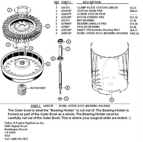

Just received stator 426454p. Work of art. 42 poles. Do you know the part number for the proper shaft fot the 36 pole rotor? I assume that it is more important that the rotor matches the shaft...so I need the rotor for the 36 pole...right?
Gill
Joined: 11/11/2006
Posts: 669
Posted: 01:35am 30 Aug 2008
Great stuff Barney, now you have the electric bits, lets get the mechanical supporting parts sorted.
With ref to Tinbenders parts pic:
I suggest the following:
Shaft 8
plates 1 x2
nut 5
bearings 6 x2
spacer 7
rotor nut n/a (suit the old rotor)
Further comment,
Some of these parts (bearings & spacer) depends on just how you intend mounting the shaft to the mill.
I like to use a hacked out piece if the Bowl 9 but don't recommend this to you for cost reasons. Glenn uses a different bearing arrangement and this supports the shaft closer to the prop which is a structurally superior design. I have never used this design but feel it better suits your lack of F&P resources. Glenn's construction details are on this site.
I think you could also use the new shaft as it's rotor spline and all other aspects are the same EXCEPT for the bolt and mating shaft hole for securing the rotor. The old method used the threaded shaft end and Rotor nut as shown in the parts pic. So either new or old shaft with their corresponding bolt or nut will do the job. Your choice really.
Cheers Gill _Cairns, FNQ
