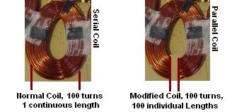

I like the Idea of the Dual-Rotor Axial Flux Alternator(DRAFA). I believe that is what I'm after. Some folks have had good results with it. These folks here made a DRAFA for their steam engine, which they say was almost exactly the same as the one they build for their Windmill, except for the way the coils were wound.Duel-Rotor Axial Flux Alternator otherpower.com group
Something they said got me thinking about something. "The stator is identical to those we build for larger 17' diameter wind turbines with the exception...and wound the coils a bit differently. These coils are wound with 4 strands of #15 gauge wire (equivalent to 9 gauge wire) and there are 40 turns per coil."
What came to mind was when a coil is wound with smaller gage wire, it produces more power but there is more resistance and heat losses and a limit to the amps a given coil can carry without fusing. So.. My question is... if a coil was wound with small gage wire with many turns, then cut through all the wires at one end where the magnet's flux doesn't pass, and connect all the ends together, would this solve the problem of resistance and let a higher amperage to be carried over many parallel single loop coils? Here's a pic..
Using the coil on the left for example is a normal coil, but it is really just many single windings all hooked in series, so I will refer to it as a serial coil. The one on the right has been cut at one end and as in the picture has had the ends wired together so that all the single loops are wired in parallel.
So what I am thinking is that the coils in a stator can be wound with many turns of fine wire without worry of amps burning out the wire because there is very little resistance in a 1 loop wire. what, maybe a 5 inch loop?
Now that I fried my brains thinking this up, tell me what you think.

  Tinbender said   What came to mind was when a coil is wound with smaller gage wire, it produces more power but there is more resistance and heat losses and a limit to the amps a given coil can carry without fusing.
Hi Tinbender,
The coil you describe will produce a higher voltage. The power is related to the load applied to the coil.
The coil structure you have proposed with your photo will perform very badly. The individual strands of the parallelled wire will not be in the same magnetic field strength. This is basically why the original 100 seriesed turns produce a sine wave voltage output. What you have proposed will be effectively shorted turns. A single turn will also only provide one hundredth of the voltage with 100 times the current.
The Flux design from otherpower produces a sinisoidal voltage output also.
I spent the better part of 1994 designing and prototype testing coils and magnets before I settled on my 4 phase ironless axial flux design. I have previously described many of the aspects. Wire cross section becomes an increasing problem as magnetic field strength and flux alternating frequency increases.
The final product is a usually a compromise with an air cored design. I found that the increase in magnetic field strength as the air gap decreased was offset by the reduced mechanical strength and number of turns in the copper coils for a designed operating voltage. I settled on a 3mm airgap with a total of 187 turns per phase giving a loaded output of 30V @ 4A at 500RPM per phase. I did find that overlapping coils provided a higher mechanical strength and so a thinner airgap could be used, with the advantage of less coils and a higher volts per turn.
I also found that the geometry was especially critical if any coils were parallelled. I settled on a series arrangement of coils, due to the difficulty of making a coil/stator that had no rigid former.
