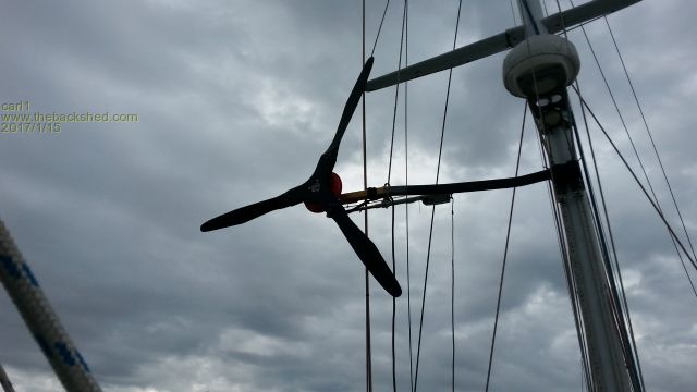

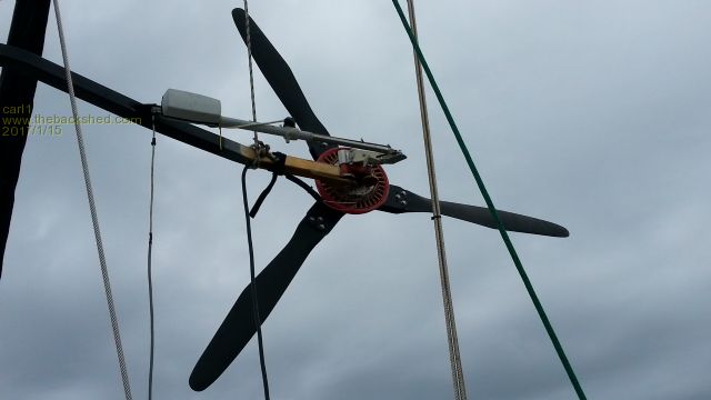

Harald
Posted: 12:04am 15 Jan 2017
That's a big wind generator for a yacht
The furling is ingenious,it looks like an electric ram from a medical plinth was used.
I use a similar ram for remote steering (from the bow) on my yacht.

Btw: a week ago in a gust at Inskip , 35kts, 35amps , 1.6m 3-blade , the whole mill crashed down on deck when the pivoting pin sheared off. Lost my best blades (old frg) from a German " Black 300 ", extended to 1.6m.
