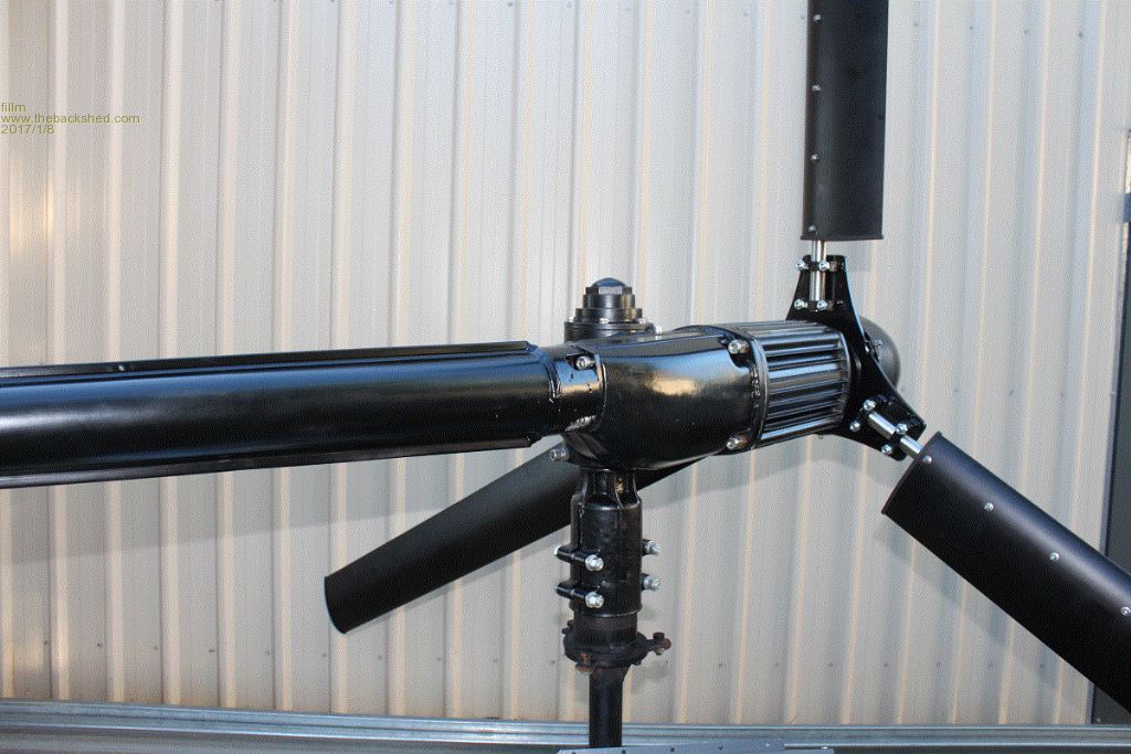

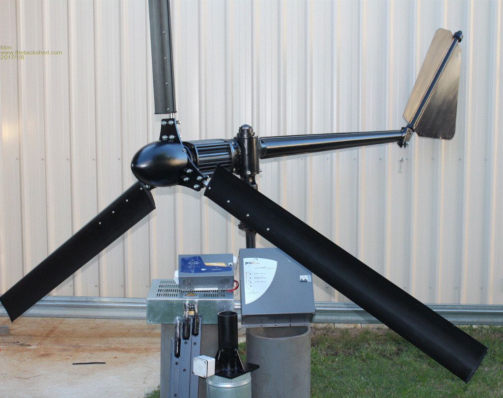

Seeing there is a bit of discussion on Grid Tie Wind here's a couple of pics of one of the turbines that I have just built and finished for a customer. Its a 2.5kW Turbine coupled with the Latronics Turbine controller and their 2.5kw grid tie Inverter.
In the last extrusion run of the GOE 222 I decided to get some black anodized so it more or less just all lined up at the time , when I told him about the blades he instantly made the decision to go with a total satin "All Black" paint job, hence the nick name. Now its finished I like it, so I am doing another 2.5kW 48V the same for myself and see how it stacks up against the other OZ Wind 2.5kw units I have in the air. Shunting 5kw into Lithium Batts is no problem.....when I get wind.
The blade set is only 3.1m Dia which is a fair bit undersized but the customer is not overly concerned if it underperforms a bit. Its destined to live in the back hills around Melbourne so will get a fair hammering and I predict it will get to max out fairly easy. He wants a wind turbine but no batteries. The set-up when competed and installed by a competent person meets AS/NZ Standards as does the GTI and TC96 meet AS4777.
I had the unit in the air for a good 4 months of testing and seeing how well the TC96 works, I trialed adding extra capacitance but it really made its connection and the loading perform worse so all in all it works well enough as is.
The PMA is a 180V 2.5kw, so it turns the GTI on at around 105VDC/100 rpm where the GOE likes to kick in and its all said and done by 550rpm . If the grid goes down or the voltage goes over 160-180V power is instantly diverted to the 2.5kw Rated Dump load.

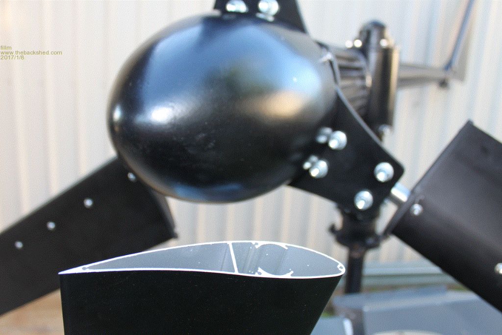

The black anodized GOE222. Anodized or Mill Finish when these are strapped on it's like a completely different turbine compared to the std twisted taper fiberglass blades.

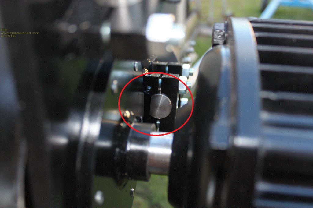

Looking at the back of the blade hub shows how I now mount these blades. the shafts are solid 431S/S that has the same tensile strength as 4140. They extend 30% into the blade and held by 4 x M6 S/S hex bolts . The laser cut blade hubs are 10mm plate with 16mm clamp halves with M10 Hex Bolts
All the blades are match marked to their position and a milled flat allows for perfect realignment for the AOA when reassembled . They are balanced to within 2 grams and tip run out under 5mm so run perfectly smooth.
The PVE2500s come up quite often on the gumtree and ebay and can be picked up quite cheaply , the rest is up to the individual on what is added , wind hydro , batteries, 96V is a bit uncommon but the function is there for battery mode as does the PVE1200 which is 48V.
