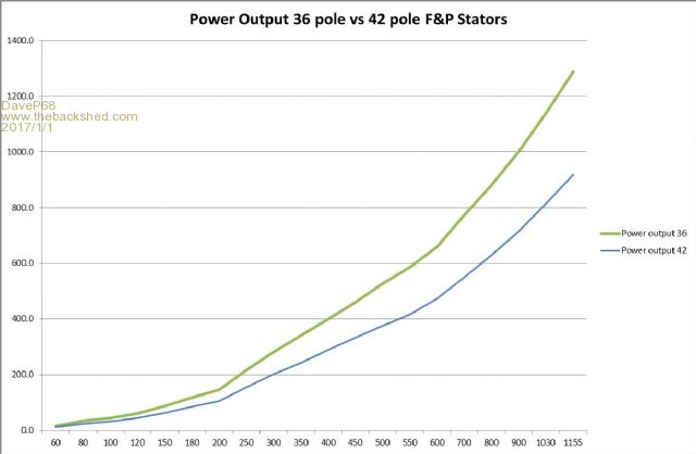

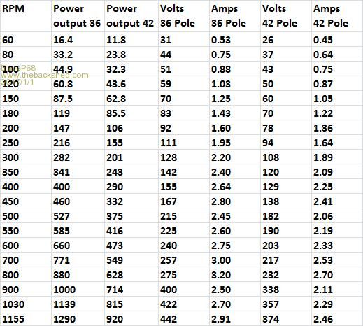

After months of testing, I've got data to prove that a 36 pole copper stator with black rotor cap has a 40% higher (linear) power output compared to a 42 pole over same RPM range. These tests were done with both stators wired uncut Delta mode.
Here is a graph and complete set of data tables (RPM, Power, Volts & Current.

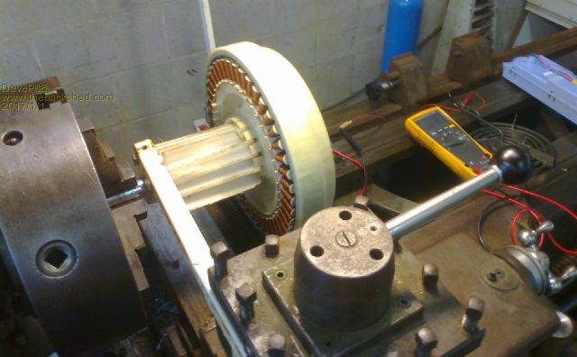

The photo above is of a 42 pole stator set up as for the first test run. We ended up using both the 36 and 42 in Delta as voltage on star got over 500 VDC under load and our rectifier + capacitors are only rated up to 500 V. Max RPM reached was 1155 RPM with peak power output of 1290 W on 36 pole with black rotor cap. Only got access to this Lathe last month hence why I've been able to complete far more testing and publish a complete set of data, including the "F&P stator cut in Volts vs RPM tables".
Yes the test voltages at high power are high and for practical use the stators would need to be cut into different configurations (i.e. 6x2C or 7x2C). Like I've described in my tables of "F&P stator cut in Volts vs RPM tables".
I have seen comments on this site stating the best stators are the 80s and 100s depending how they are used.
I would be very interested in seeing how a 42 pole stator can be configured to match this 36 pole stators (with black rotor cap) data or better it. I'm not referring to the modified 7 phase wired to use a black rotor cap as the wiring is quite complex pull off and once done is hard to reconfigure.

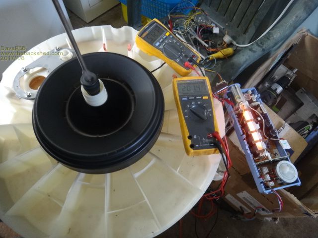

An update on this 36 pole vs 42 pole stator testing for those that may be interested.
Added a "Capacitor multiplier" as per Gordon's design and got a some good improvements in the low to medium RPM range up to 400 RPM both 36 & 42 pole stators. Yes this is where better performance is needed anyway.
But even using a "Capacitor multiplier" on a few different 42 pole stators I couldn't get as much power out as a 36 pole copper with Black Cap. By far the 36 pole copper "Factory Decogged" with a Black rotor produces more power output overall.
Let's say you put a "Capacitor multiplier" on a 42 pole and state it will out perform a 36 without the "Capacitor multiplier". That isn't a fare comparison as one just needs to add a "Capacitor multiplier" to the 36 pole and it will just put even more power than 42 pole. The laws of Physics are what are...

Dave, thanks for the very useful table you have spent time to produce. It gives me a good idea of how the stator can be used.
I have a few here now, and have not had the time to get an idea of their dynamic range.
I do appreciate the high rpm, and natural voltage figures, as I would not use these in the mode that folks here do. I would run them natively.

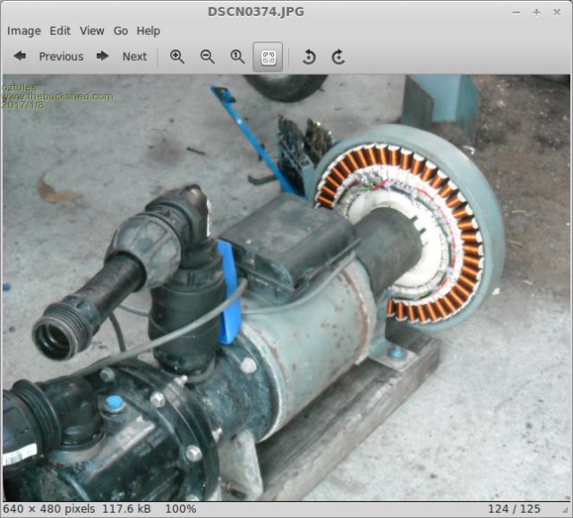

Eg.. here I used it to drive 1k5 hp mono pump...used the original motor as a bearing block
It runs on solar panels the same as a normal solar pump would.
So am familiar with driving them ( I used a moc33033 chip, not the F@P, as it was for a 48v unit.)
I think breaking would be very simple, and not require the "breaking" circuit, as if we match the synchronous impedance, we will probably get as good as we need. It will not run away like a short circuit would do, but act as a dynamic brake... slow but not stopped I suspect.
The inductive reactance is what would normally do that runaway bit with a dead short. People would have noticed it is probably best not to direct short it, but to put a big resistor across it instead, and that slows it down until the TSR drops off, and stops it. It can also be seen as a eddy current reaction, so is inversely proportional to the rpm.
