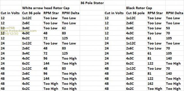

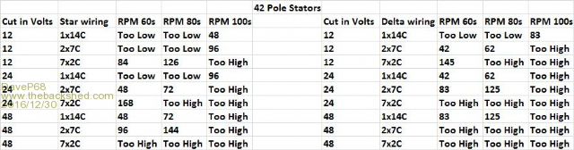

I've created 2 sets of tables for calculating what the RPM will be for the 3 common battery voltage systems described on this site.
These tables are an additional reference to F&P stator rewiring page.
The first table is for the 3 different 42 pole stators (60s, 80s & 100s).
This second table is for the 36 pole stator but with the 2 different rotor caps, white vs black.
*Please note where it states "Too Low" refers to RPM below 45 and "Too High" is above 165 RPM. Too low RPM is the possibility of stalling the wind turbine blades at start up. Too High the turbine will likely be free wheeling and produce little or no power in light winds.
Hope this provides a rough guide to those new to here.
There is always a chance of choosing the wrong rewiring system will likely render the stator useless!
DavidEdited by DaveP68 2016-12-31

Where it states "Too Low" I mean a Cut in RPM of 12, 18, 21, 24 or 36" I have included 42 RPM on the Delta side so should have said 42. It's there for all to see on the Delta table anyway.
For "Too High" Cut in RPM I'm really referring to above 192 rather than the 165 (there is a 168 in the table). I just so happens 192 is the next highest RPM level above 168. So I chose not publish it and anything above that.
Here are some Examples of "Too Low" RPM cut in levels;
60s Star 12V Cut in RPM's are: 1x14C is 12, 2x7c 24 That is way too Low.
80s Star 12V Cut in RPM's are: 1x14C is 18, 2x7c 36 still too low.
Here are some Examples of "Too High" RPM cut in levels;
60s Star 48V Cut in RPM's are: 7x2C is 336 RPM That is way too High.
80s Star 24V Cut in RPM's are: 7x2C is 252 RPM That is too High.
100s Star 12V Cut in RPM's are: 7x2C 336 RPM That is way too High.
100s Star 24V Cut in RPM's are: 7x2C 672 RPM That is off the charts too High!
100s Star 24V Cut in RPM's are: 2x7C 192 RPM too close to your 200 RPM limit. As it turns out
Calculations are derived from measuring the Volts at various RPM levels. Example a 42 pole 60s factory standard star is around 1 VDC per RPM out of a 3 phase rectifier. So 100 VDC out is around 100 RPM +- a volt or so (no load). 80s is 66.6% (2/3) of 60s and 100s is about 25% of a 60s (1/4). It's just simple math to create the tables. All very predictable when the stators are not under load which is exactly where cut in happens.
Remember these RPM numbers are "cut in" values and don't represent the higher RPM operating range (above cut in) that power is "going" to be extracted from.
I'm going to leave the data table as it is. Not wanting to cause any confusion to those who are new to here and that is exactly why I published in that format.
DavidEdited by DaveP68 2017-01-01

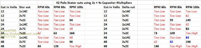

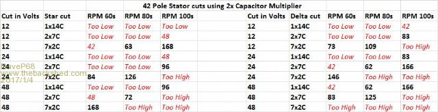

A word of caution re using the above tables. They are NOT to be used with the "The capacitor voltage multipliers" described on this site. That is why I put the "Too Low" and "Too High" entries in as to not cause any confusion.
They where ONLY ever meant to be used for calculating cut in RPM for direct feed into rectifiers that are charging batteries or an MPPT inverter.
Here are 2 new tables for use when using "The capacitor voltage multipliers" (2x & 2x + 4x) which by the way will give a significant increase in power output to charge batteries.
The "Too Low" and "Too High" entries still exist to simplify the use of these dedicated tables.
Also cut in RPM will very much depend on floating battery voltage. I.e. a 42 pole 100s stock standard wired Delta mode will cut in approx 83 RPM using the 2x + 4x Cap Multipliers into battery at 48V. With a good charged of 53.2 V on battery would shift the cut in approx 92 RPM same setup.
"The capacitor voltage multipliers" can be a bit tricky to build as the correct choice of component values is required for each different voltage operation i.e. 12 or 24 or 48V.
More tables for 36 pole etc, to follow soon.
You can find the details here Gordons Cap Mod. Edited by DaveP68 2017-01-07
