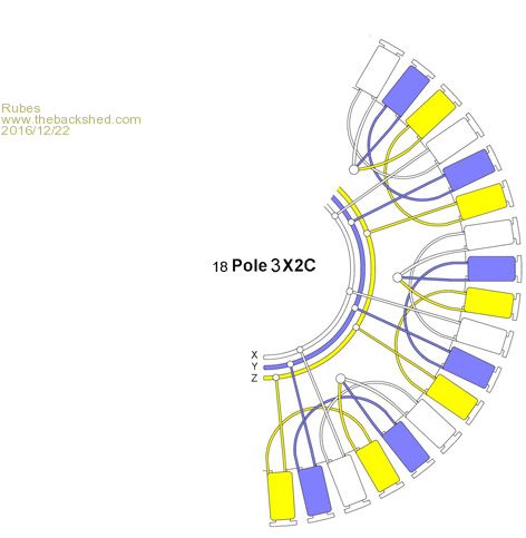

Hi Guys, just completed a micro Hydro project and because of limited head (17 metres dynamic) I have had to play around with the stator and have found an 18Pole3X2C
seems to give me optimal performance via bridge recifier as here of 95v open circuit or around 100 watts 45 v connected to a 20 Ohm dummy load. Question is, is this stator putting out acceptable 3 phase ac or is this not the correct way to reduce the core, I have tried other full stator wirings (42pole7X2c and 42Pole2X7C)these give me far to high a Voc (over 200v)at the rpm. Intend to use a 150v MPPT controller for battery management and no dump load as the no load rpm is acceptable.

Hi rubes, why not use the whole stator in 14x1c, or try a 36pole stator for some diffrent combinations, and or fit a tap in line above your hydro for rpm control? how many watts output are you after? how many batteries and what size ?Fred

Hi flc1, 100 watt output would be a great addition in winter to feed a solar charged 300ah battery bank for the offgrid shack, still waiting for my controller but a brief test of full stator wirings direct connected to the bank causes significant rpm and power loss because of the high load and limited power input to hydro plant, the limiting factor being price of MPPT controllers that can handle the high Voc of full stators. No doubt there would be other wiring methods or rotor height adjustments that could be done as well but I need to know if my current stator wiring is acceptable.

Rubes, I would wait untill you get your mppt controller,and then start again with a full stator,cut to say 7x2?? and let the mppt do its work,with meters to see whats happening, trail n error I guess?your stator wireing looks ok, Fred
