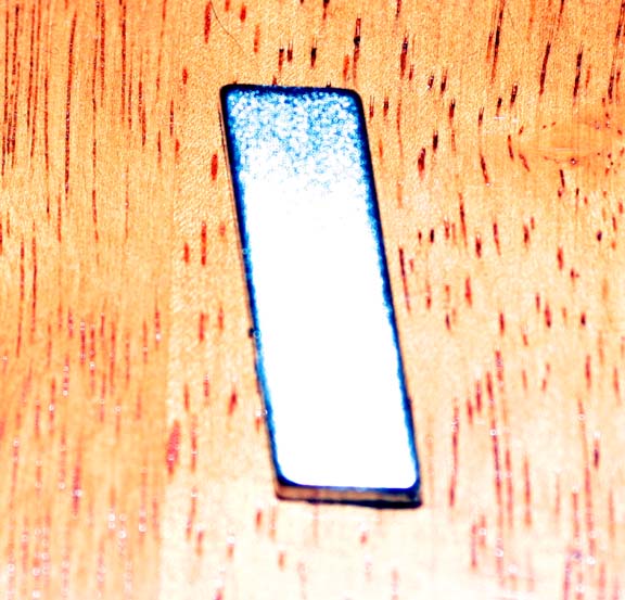

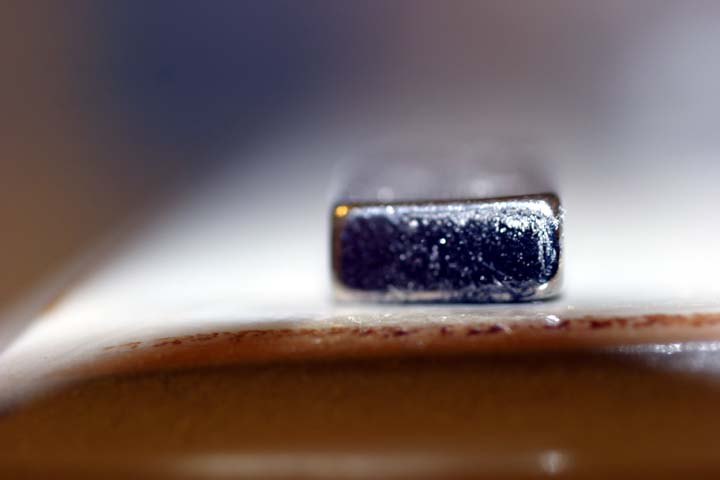

I just got my magnets. They are slanted to reduce cogging and they are curved to exactly fit the curvatur of the F&P rotor. There is no clicking or bad seating; it is perfect. I am hoping the tight fit adds to the strength of the rotor so there is no warpage.
Here are some pictures. It is subtle, but note how the second picture slightly curves up on the righthand side off of the table. There is an arc incorporated into the magnet design.
If these work out would anyone be interested in purchasing some for their F&Ps? I can have more fabricated.

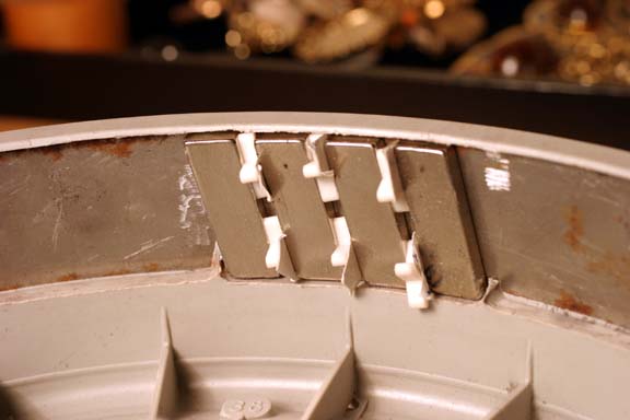

Here are my updates so far...
Starting the process using 3mm tile spacers plus two sheets of paper per spacing.
Rotor ready for fiberglass sealing
MyCattMaxx
Joined: 24/02/2008
Posts: 8
Posted: 02:06am 06 Apr 2008
Looking good. Thanks for pics.
Posted: 03:02pm 06 Apr 2008
  imsmooth said   Here are my updates so far...
Re sealing magnets, has anybody tried this idea:
Magnets assembled as in picture above. Hub mounted on horizontal shaft so that the shaft can be driven to rotate slowly via variable speed control.
Spacers are removed and hub spun up.
Resin is dripped on the spinning magnets. It will evenly disperse outwards by centrifugal force, no dam is required if there is still a lip on the open side of the hub.
Keep spinning until the resin has set.
I have not tried that with magnets but on some other job and it worked well enough as long as the rotating speed was fast enough to stop the resin running to the lower end.
brucedownunder2
Joined: 14/09/2005
Posts: 1548
Posted: 09:19pm 06 Apr 2008
Hi Klaus,, Interesting concept, be nice to see your idea work . The resin on the surface face of the magnets,,would you take this off ??
With my luck ,I'd get resin all around my workshop and the space suit ,I'd have to wear ,lol.
I ,ve made 3 of these and ,using cloth backed "Gaffa" tape as a dam ,they have all come out nearly perfect. The ordinary plastic tape is a disarster,don't use it.
Anyhow ,the magnets look good ,so you left those little bits of plastic around the inner circumference for ease of spacing ??.
Good work
Bruce
Bushboy
KiwiJohn
Joined: 01/12/2005
Posts: 691
Posted: 11:11pm 06 Apr 2008
I suppose while the rotor is still whirling in the lathe (or whatever) and the resin is liquid you could use something like a paint brush to wipe the magnet faces? I was going to say a rag but that might lead to injuries.
imsmooth
Joined: 07/02/2008
Posts: 214
Posted: 12:00am 07 Apr 2008
Well, here is the update. I sealed the rotor as follows. I put lamination paper around the outside of the hub and fixed with tape. I removed the spacers and spilled some resin into the gaps, letting it cover the magnets up to the inner lip. I let it set and rotated the rotor and poured in more resin. I repeated this process of pouring, setting, and rotating until I finished th whole rotor. This took a day. I had tried using various tapes on the inside, but the surface wasn't smooth and I couldn't tell if I was making too thick of a coating. I used a file to shave off fiberglass resin where it was too thick. Here is the picture.
Now, I loaded it onto the stator hoping it wouldn't warp. The end result - absolutely no warpage. As I hoped, the perfect fit of the magnets reinforces the strength of the rotor. Also, the thickness gives a little more distance from the iron core, reducing the pull. Using formulas, I calculated the the pull in pounds for the ceramic magnets is 0.6lbs; the pull-force of the neos is 6.83lbs. We have an x11 difference in pull. However, despite the added force, the rotor kept its shape with no special effort on my part!
