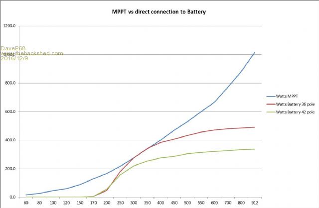

The follow is a graph of power outputs of a 36 pole 48 magnet black rotor cap using MPPT vs both a 36 pole 48 magnet black rotor cap and 42 pole 56 magnet rotor cap directly connected into a 48V battery system.
These results speak for themselves, if a form of MPPT is used the maximum power output can be extracted from an F&P stator.
Please note the large power output difference between the 36 pole and 42 pole into batteries. This is mostly due to the 20% stronger magnet black rotor cap but also each pole is larger on the 36's that don't saturate as much.

I have a few now for testing and my VFD test bench can go to 1000 rpm , the BIG problem is they are .6 winding and the very best that can be done as " conventional " battery charging is 12x1P and as Dave has shown there is about a 20% better output. Second Big prob is wind turbines do not run @ 1000rpm and in Dave's testing where the blue and red meet is more where power it should be stated at around the 300 - 400 rpm and is clearly the most efficient in both cases.
As far as running them straight into a resistor to show 1000W @ 1000 Rpm it is mostly not the norm and really a bit of a mythical figure.

Phill, can you explain how a 42 pole .8 f n p will out perform a copper 36pole .6 f n p with a black rotor cap ? the f n p all produce about the same stock standered, untill you fit a black cap to a 36 pole copper, then you get a gain of around 20%, plus the 36 is factory decogged, Im yet to see any home decogging of fnp that matches that,so better performance in low winds, which is what most turbine operate in, so overall,the 36pole copper with black cap is the better fnp for a windturbine, and like most large turbines,to get your 1000 rpm, you simply gear it up,and with mppt why would you want to rewire a stator?,that mppt technology is easily found online and can be fairly cheap and reliable, Davids test showing 1000w simply shows what a fnp can do, with the right setup,or mppt, its no myth, Fred

I Need actual results to prove it had a better output than a 36 pole copper with a black rotor cap. The results in the graph posted in this thread are the best I've got so far and there is room for improvement.

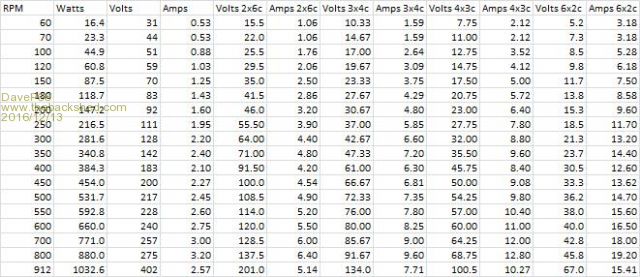

For those that are interested here is the full data table that was used to create the MPPT part of the graph. Please note the other configurations in the table which are 2x6c, 3x4c, 4x3c & 6x2c are just scaled results from a 36 pole copper stator wire delta with black rotor cap.
