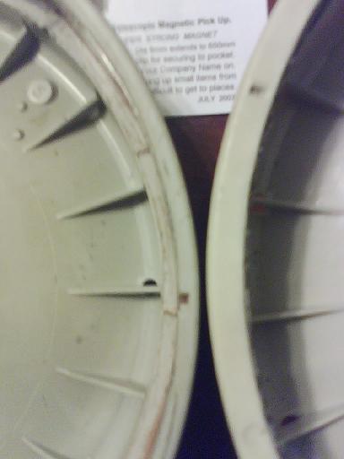

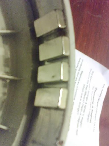

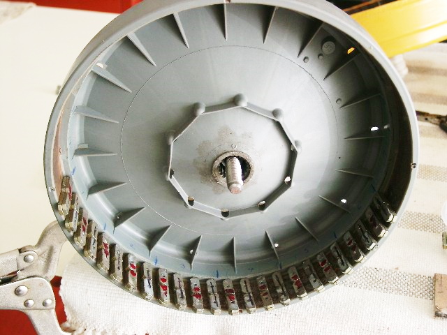

Yesterday I started fitting 224 small Neo magnets around the inside of a stripped F&P rotor. This will be the standard 3 Phase rotor configuration for a dual stator/rotor mill I am building.
A very messy and time consuming task,as I had to clean all the magnets of their polyester resin from a previous failed attempt.. Sore fingers also,lining them up on a slight angle to reduce cogging .
Bruce

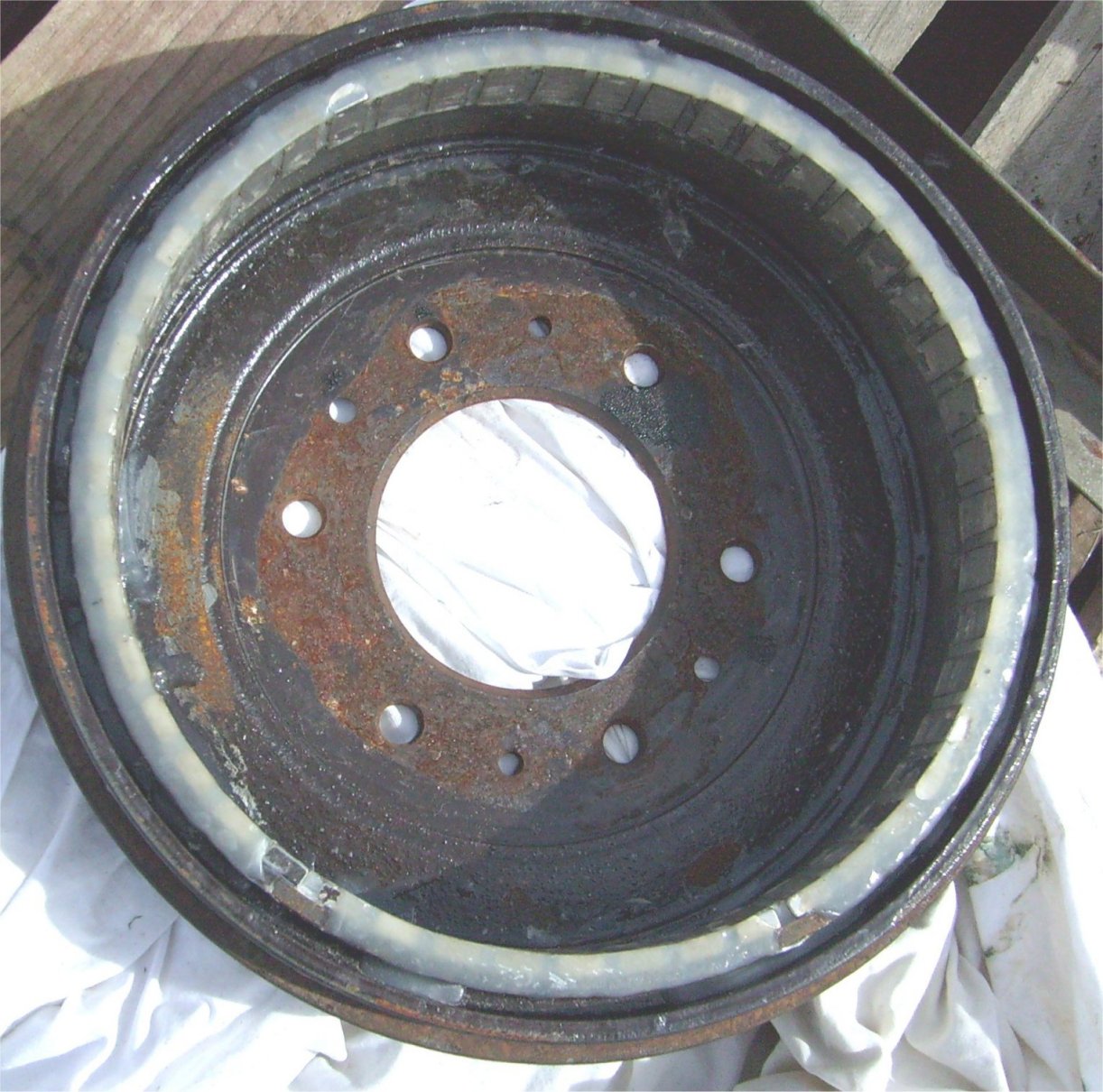

looking good so far, how did you remove the original ceramic magnets? i have some magnets comming soon, was thinking of using a brake drum, is that the old steel bands still in place? im getting 6mm magnets it looks like you have 2, 3mm together so should get similar results.

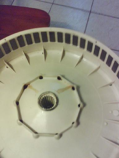

Hi Martin,, crack the first ceramic magnet out with a 6mm chisel and hammer carefully.. The rest should pop out by levering them off the steel band --the glue is not so strong.. Then clean up any bits and pieces of plastic that will get in the way ,finally a brisk sandpapering around the inside .. I don't glue mine in ,,they stick very firmly anyhow. Leave the steel bands like they are.
I think they are 12mm X 6mm X 3 mm Neo's..
take it very easy,,it's utmost important that you get the poles correct--udderwise,,it don't workie !!

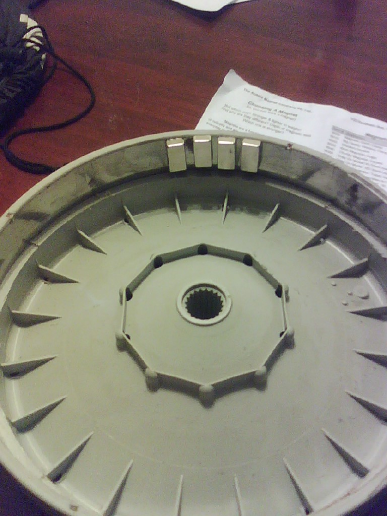

ok got the old magnets off ok, new ones arived today there 6mm * 12mm * 25mm neo, very strong magnets tryed to locate on rotor but the forces were pushing them apart so i couldnot get the spacing i required. might need to glue as i go. what about the wall thickness, i have read that these original hubs will flex out of shape under the load of the neo's. will you strenghthen it? also i was wondering whether more steel lamination is required becouse of the stronger magnets? from a electronic point of view not strength.
you mentioned an angle on the magnets. to reduce cogging i guess, how much do you think i should allow.
sory for some simple questions but this is the first neo conversion i have done and i want to get it right, better to learn form other peoples experience i reccon.
you seem to use 4 magnets for every 1 that i am using
is there a reason or is that becouse you are re-using some old ones you have salvaged?

Cut some strips on wood or alu the width you want to space the magnets should help in the placement.
Posted: 01:51pm 04 Feb 2008

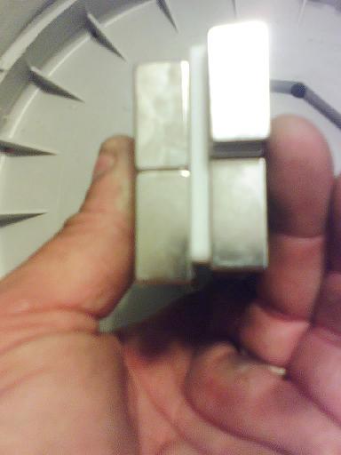

Looking at these neo conversions makes me wonder if you guys did consider fabricating suitable spacers (out of PVC perhaps) to keep the magnets equally spaced and perfectly aligned. Was this a case for the too hard basket ?
Also, I notice one rotor shows small magnets stacked 2X on top of each other and also next to each other.
Does this create a magnet 4 times as strong? I would be interested to hear from somebody to whom permanent magnets are very familiar what the result of PM stacking is.
Intuition and playing with small disk magnets here tells me that a vertical stack has not the (lifting) power of stack # times the individual magnet. Surely there would be some losses at the meeting surfaces?

Hi Crew,,
have used spacers before this mod,,but ,for me ,it dosen't seem too necessary , as I place a piece of wood(chopstick) adjacent to the finished magnet as I sit the new one down . Ok, you get some that wander, but not many.
stacking,,well,thats what I've got many small ones,,(they were cheap). Dunno about the power Etc. Just know these are "Bloody powerfull ! ".
Strength of rotor case-- yeah,is a bit of flex,may back it with a 6mm Aluminium disc ,,we'll see.
Just discovered I'm 2 or 3 magnets short- "Bummer" another trip to the big smoke to scrounge a few..
have fun
Bruce

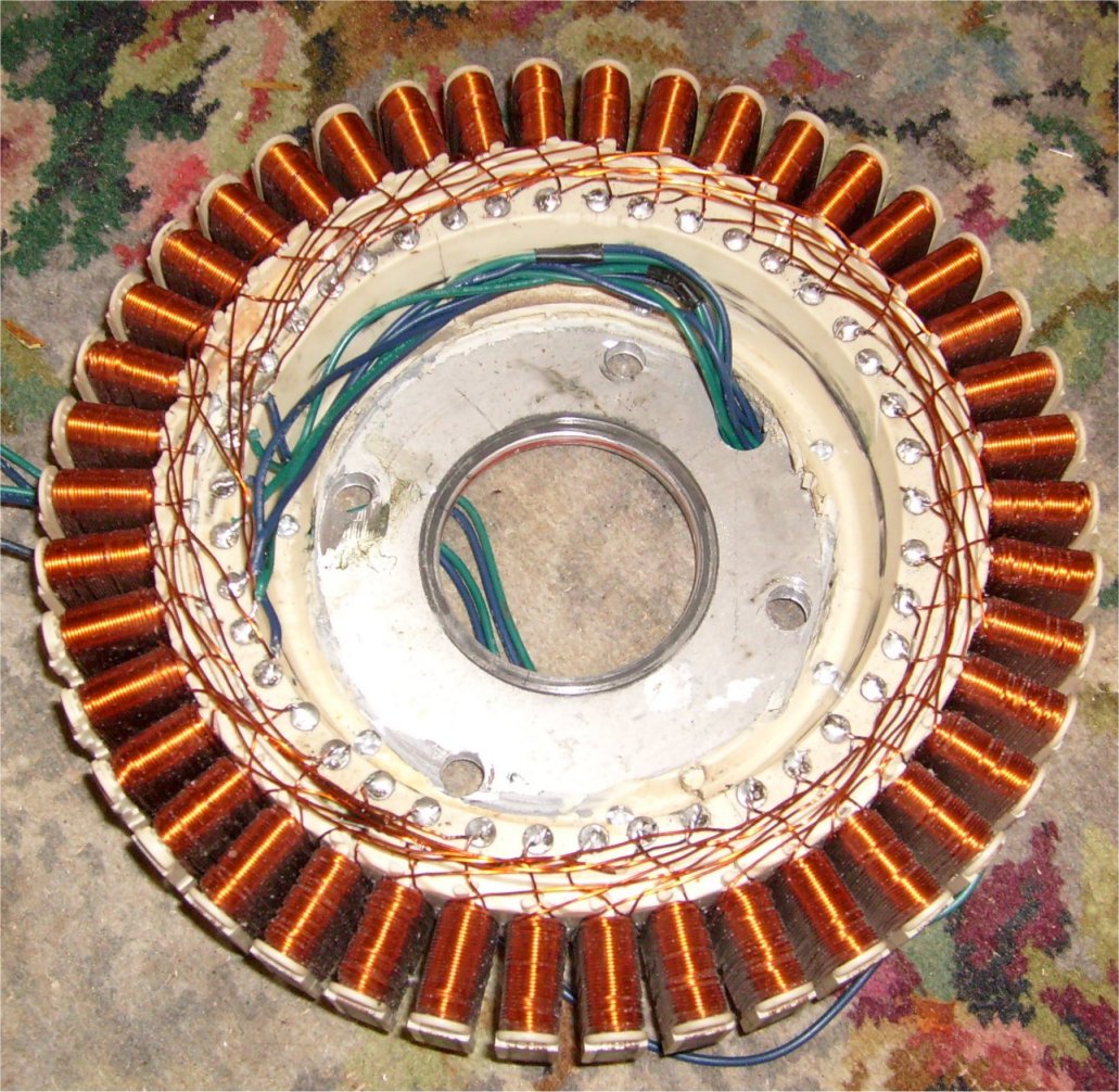

sory for the 1st lot of pics guys, glen could you edit for me, forgot to enter after 1st pic. ta
i think spacers would be a good idear to ensure accurate alignment. i will do a lot of test runs b4 actual resining in place magnets cost me 100 dollard inc delivery for 50 not too bad but i dont want to stuff them by rushing.
i also have a 100 series rotor and stator, i was wondering if the rotor is stronger as it uses individual magnets. see pics
from my reading on neo's having 2 on top of each other increases power by aprox 60 to 70% dosnot double it, but you use what you can get, i have thought of the magnets found in old hard drives, they are 3mm thick with north and south on the one side, you will need to break them in half and twist one half over to align the norths and souths. but there very good, easy to get neo magnets.

Hi,, Martin ,, I tried removing those individual magnets in the 100 series rotor-- for me it was a failure-they are somehow bonded in very differently from the block ceramics and are also impossible to get all of the material off the steel backing,,if I remember !
There is a rotor that I imagined to be stronger--a brownish fibre composite rotor--only have ever scrounged one in my 20 or so "finds". Look for it -twisting by hand ,it seems to be stronger-dunno !!.

No,, thats not Blood,,it's Ilda's fingernail paint --I dabed a spot of red on one set of magnets then a black felt pen mark on the adjacent row ,,all around all of the rows.. that way you can make absolutely sure of the polarity ,north,south,nort , south Etc.. I f you get it wrong and resin them in ,,it's a bugger of a job fixing them ,,and you'll know,,it won't work !!.
The chopstick idea works well for a temporary spacer--What I did was divide the inner surface equal to a ceramic tile and mark on the plastic ,,that way u can be fairly sure of being within a half mm or so ..Then when you are finished inserting all the magnets ,,eyeball the finished job to make sure you have all those spaces between the magnets as near equal as possible,,check the poles them gaffa tape the inside to form a dam for the resin.
Warning--- Use the cloth inpregnated gaffa tape--ordinary plastic tape will melt--believe me --
