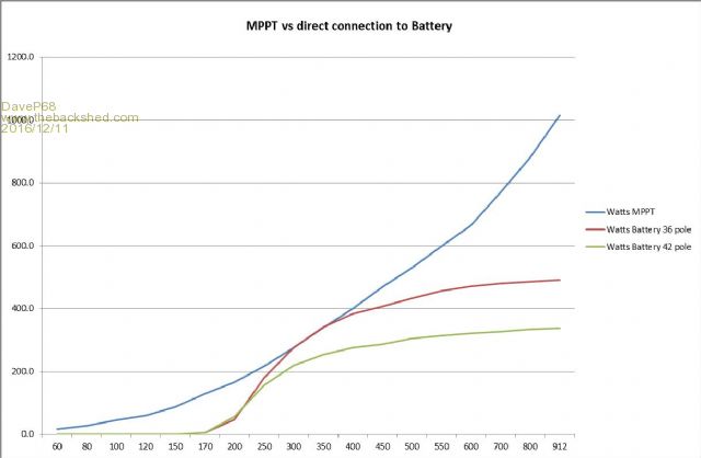

What Downwind wrote re "a device with a 10 to 1 ratio will give more output power than a direct ratio of 1:1" is not understanding how the F&P stators are designed to perform. They are what they are, not a poor design as previously stated.
Trying for a 1:1 system, knowing that there are whole lot of other variables i.e. wind speed, stator operating voltage over wide RPM range etc etc.
Wind under any conditions is variable, so take an average day say 2.5 - 10 m/s, that's a 4 to 1 ratio. With the cubed law of power output over that same range added in that becomes 64 to 1 under ideal conditions looses excluded.
The F&P stator |(ALL types) have a very dynamic output voltage range of more than 10:1 with a flatter current curve when used under correct operating conditions.
When directly feeding into batteries a higher cut in RPM is required before any current can be extracted at all.
Please refer to this graph with MPPT results speaking for themselves...

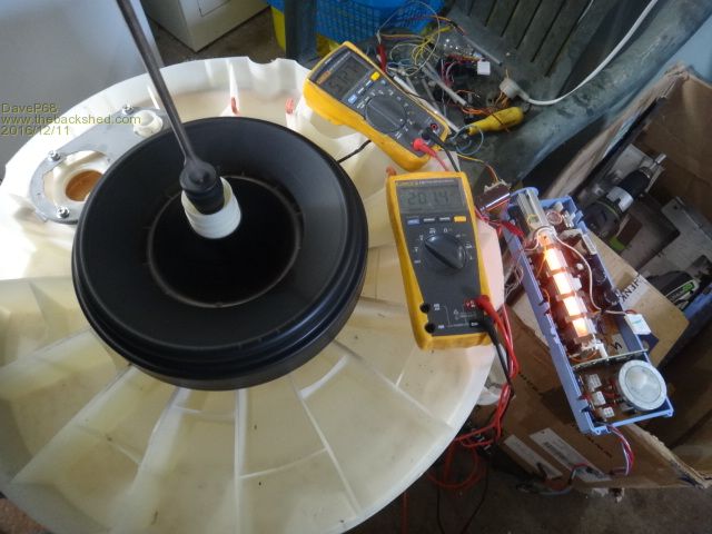

For those interested, below is a photo of my test set up with Fluke Multimeters + Electronics (Modified F&P Phase 2 Blue Motor Controller). Results recorded were loaded into a table to create the above MPPT graph. Stator 36 pole wired 2x6p Delta with Black rotor cap.
Fluke multimeters are showing 201.4V & 5.127A DC respectively giving a peak power output of 1.032 kW @ 912 RPM, so 1000 W can be extracted below 1000 RPM...Edited by DaveP68 2016-12-12
