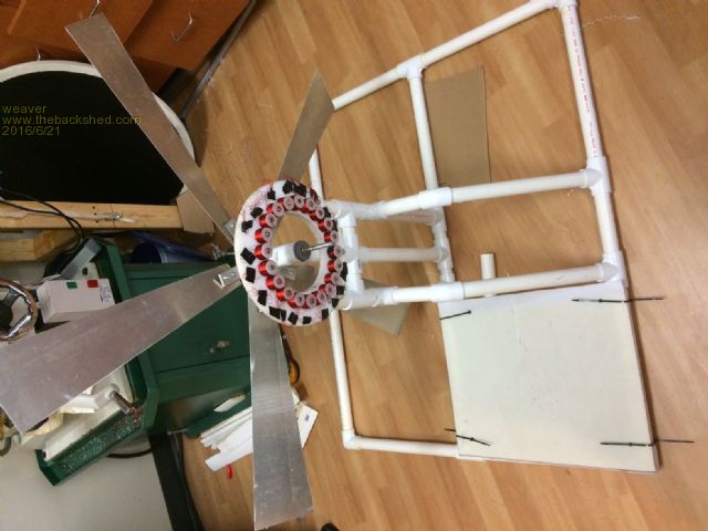

Hello, i recently took the time to build my first small windmill and have been having lots of trouble with it. To start off I built a pvc frame that i would upgrade if i got it working right. And I bought 20 magnets that are 20 by 20 by 25mm and they are n52s. Then I made coils to hold my copper on about 1 inch diameter and .800 wide. So 20 of them accounted for about 2 1/2 pounds of 26 gauge copper.But not i can not get it working properly. I tried wiring it in 3 phase star but it only made about 3 volts so i just tried a parallel connection and got 1 volt??? Hoping you guys could give me some help on what im doing wrong. Also those voltages are taken after the ac to dc rectifier. Could it be that the copper gauge is to small?

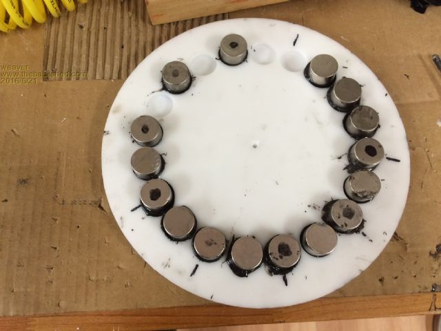

A bit more info like - How many magnets to how many coils and how have you mounted them as well as a picture will give people info to better advise you.
Ahh your pics just loaded, you can not have 20 magnets and 20 coils , they need to be in correct ratios like 12 magnets to 9 coils or 16 /12 and so on also the magnets need to be mounted on a steel plate to complete the Flux Path. Then it seems you are trying to build an Axial Flux you will need another set of magnets on the opposite side with the coils in the middle so then your magnets required ar 24 / 9. Then you need to make a test coil to establish Volts to Rpm before you go ahead and wind all your coils only to find out its all wrong. When you get to that stage there is a formula or set it p with a rectifier and capacitor.
I would strongly suggest searching on the net to see how others have done it this is a link to my last AX FX AX320 and it might give you an overall picture.
when you get it up and running would turn the blades around the other way with the small end out and pit a slight curve in them.
Looks like you are pretty handy so there is nothing to hard just have to do a bit more info gathering before you leap back into it .... Edited by fillm 2016-06-22
Posted: 01:16pm 21 Jun 2016
Can you measure just one coil, by itself. Let us know what voltage you get.
The design of your windmill is not a good one, but it will teach you a great deal. Use this one as a learning tool, dont invest too much time and money into it. The magnets are good and can be used for a better design later on.

you can make a dual rotor axial flux alternator with ten poles per rotor .
you will need two iron/steel rotors for the magnets to sit on
these metal rotors will contain and concentrate the magnetic flux.
your magnets look to be cylindrical 20mm in dia. by 25mm thick .
Yes?
if so,
10 mags x 20mm dia. + 20 mm space between mags = a circle of mags 400mm in circumference .
400mm /3.14= 127mm dia. circle
add 20mm for the width of your mags,you will need two steel disks about 6" in dia.
your mags are small in dia but thick and powerful so you will need the mag rotors thick enough to contain the flux.
1/4"steel should do it .
you can use all your mags on one larger metal rotor but you will need another steel rotor to rotate in sync with the mag rotor .
your trying to make an area between the rotors of very strong magnetic flux with your copper in between.

You will have to scrap this one ... Sorry but that is learning. As I did say and ED1 has pointed out, first you have to concentrate the flux lines and put the magnets on 2 steel plates with the magnet forces trying to pull them together. you then need to separate the plates the width of your coils + air gap. they must also be configured N,S,N,S
1/4 plates will do for mucking around but I doubt that will contain all the flux on 20mm NE52s and would be more like 16mm . The easiest way to check is put a steel pin on the back of the steel plate and if it drops off then there is no magnet flux radiating and you have contained it.
If you do this then you wont have the problem of the magnets popping out as you have now. You will need to devise a way of lowering the 2 plates together and keeping them apart with the coils which are usually encapsulated in resin in 100% of axial flux designs.
If you want to make good power to charge your batts this is how it must be done, with the emphasis on Good and Must. Sorry but its not going to happen with plastic.

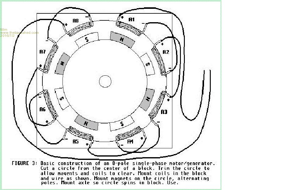

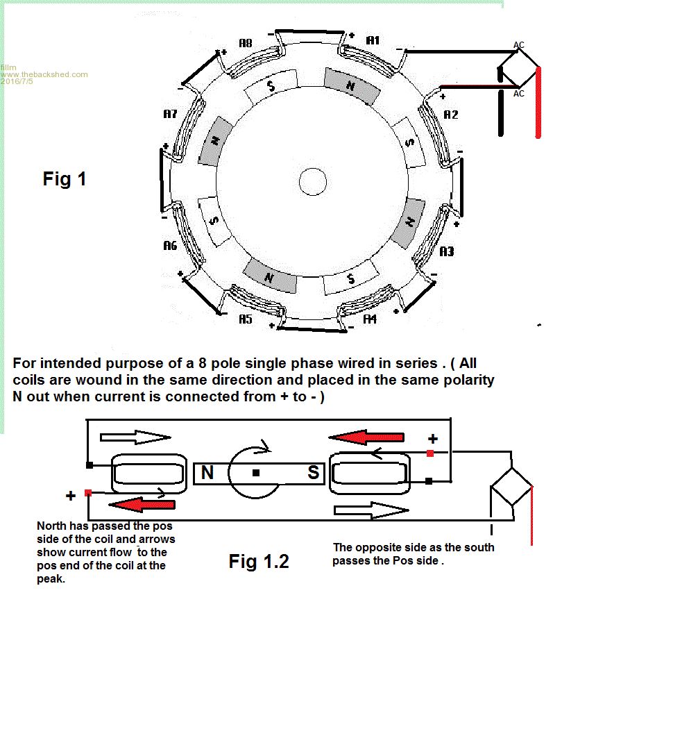

well mr. film you can wind the coils in one direction but if you were to wire them that way; nose to tail, to nose to tail, you are going to be disappointed.
you re think it
fillm
Joined: 10/02/2007
Posts: 730
Posted: 01:06pm 02 Jul 2016

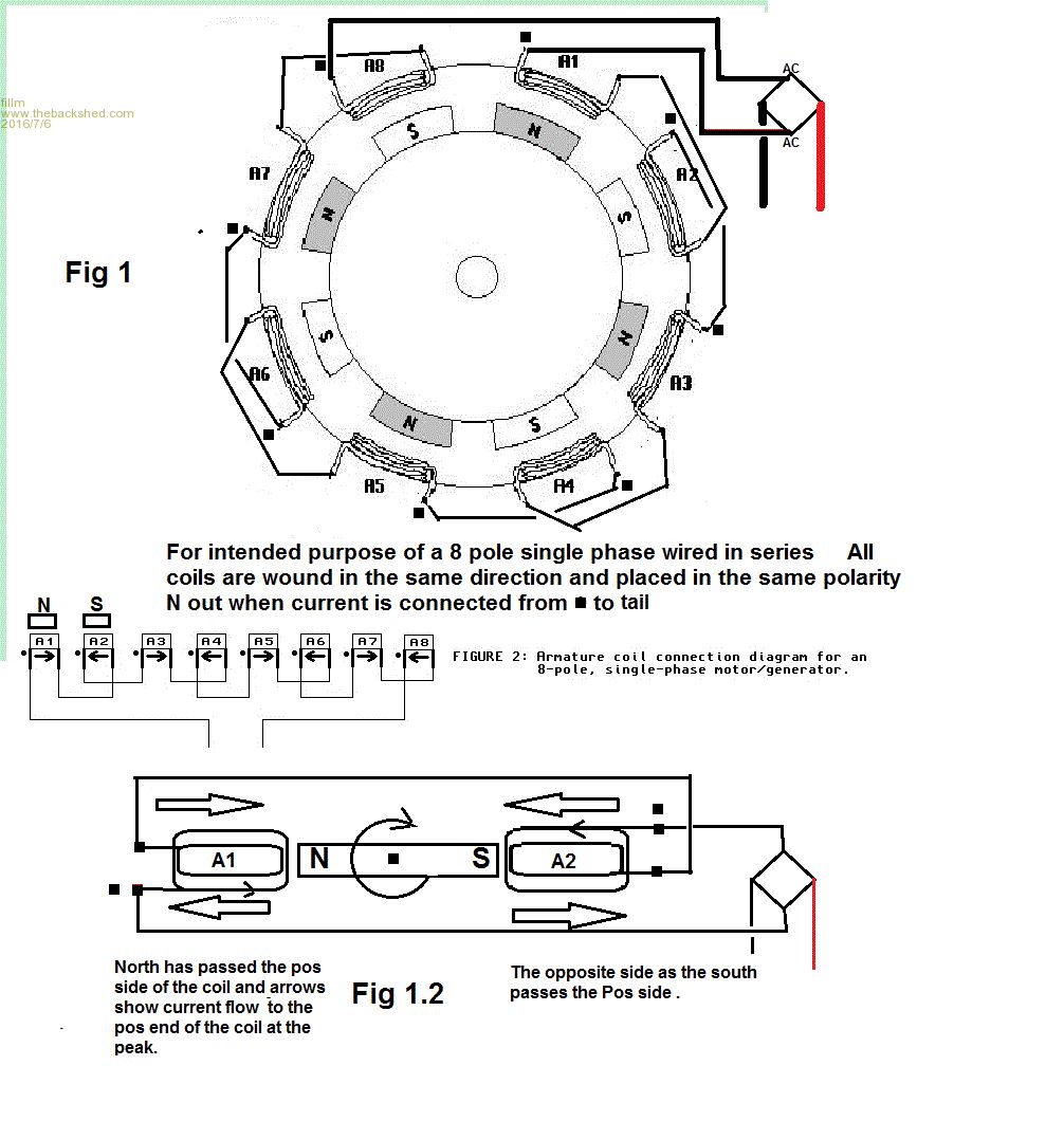

Do you mean like this, is the nose to tail mean n-s ? Please explain a bit more on reversing the second coil and your theroy on single phase set ups . If i were to build a single phase generator I would keep all the coils wound the same way and orientated the same way depending on how many you want in series then they would be connected across a rectifier and the magnets in a N-S-N configuration as shown. I can not see the benefit of having all your magnets the same way and reversing the 2nd coil. Maybe I am missing something between the lines but if the magnets are all the same way would that also play hell with the flux.
Edited by fillm 2016-07-04

The picture above is wired exactly as Electrondaddy has explained.
The plus and minus signs are confusing, and are a representation of the orientation of the coils, not of the output polarity at any time in the sequence.
(In fact with the magnets in that rotation position, all coils have no EMF, as the change of flux is in a static point as far as the coils are concerned.)

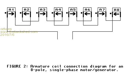

We want a cumulative effect from the coils, like the batteries in a long torch ie + - + - etc until we get the voltage we are after.
So if we have alternating magnets and we don't reverse the connection to each successive coil, they will cancel.... so we reverse every second coil.
The diagram is misleading as you are likely to think the + and- means emf.... and it does no such thing.
If you have the orientation of all the coils as the same, but the magnets are NSNS... then the potential of every second coil is the reverse of the next coil...they cancel.... so we need to change the wiring going to each second coil as they have done......
The proof is that four of the coils are the same orientation when say the N pole is passing them.... and yes they are adding, so it makes sense that the four south pole ones engender an opposite effect and so needs reversing by the wiring, then they all add up.
So that alternator circuit works, but the + and - is not the output of the coils, as thats not what they are getting at with the + and -..... they should have used A and B perhaps, the plus and minus is confusing the issue.
I guess if you mentally change the + and the - in that picture of each second coil, you will have the additive effect we are after.
If we were to use the magnets in all the same polarity, then we would have effectively doubled the pole count of the magnets.... because we can't have a unipolar rotor...
So it will create a phantom south pole between the N pole magnets... we use this to advantage particularly in three phase 1400rpm motors. In this case it would require a major rethink on the coil and magnet spacing.

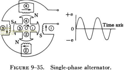

From avstop.com .... a simpler version, so easier to see perhaps
Note the arrows, and what has been done to make them all apparently have the same orientation... we reverse the wires of each second one.... call the head end of the 4 arrows positive for example....
Note also the sine wave graph. Thats for a single rotation (360 degrees), and note also the wave ends in zero when the magnets are under the coils exactly.... It may be maximum flux density at that point, but from the frame of reference of the coil, there is no change of flux that can generate EMF in the coil/s ( actually from internal cancellation within the coil windings itself.... one side of the coil cancels the other side at that point in the cycle... so no terminal output to see on any coil. )
The real reason is that the terminal voltage is a vector addition of all the wires in the coil, and they all see the field slightly differently. As the magnet comes towards the coil, the emf will be one polarity, but as it gets to top dead center, both sides of the coil are now seeing the magnet as equally coming towards the windings or leaving the windings ( it's in the middle )... which will stimulate a different polaritys in each side of the winding, and at that point as many wires see the magnet coming towards them as leaving them... so no emf at the terminals. This is the same for both pictures, but easier to envisage with the 8 pole unit.... imagine what each side of the single coil sees as the magnets come and go.
It is actually easier to envisage if we have a single point coil ( no physical size ) and see what the velocity the field will look like to it, as a magnet on a circle or linear for that matter comes towards it and then leaves it.... remembering that the force is a square function of the distance, and the emf sign is a function of a field moving towards it or leaving it.
If the magnet comes and goes relative to the coil, there must be a point where it is neither coming nor going... or a stationery field so zero emf at dead center of the coil.
Armed with all that drivel weaver, you will be able to design your own, and know what to expect and why.
...........oztules
Edited by oztules 2016-07-04

Anyway, I agree I am wrong and its been a while since I churned the grey matter around with winding coils and AXFX Alts. I will always own up and apologize that I have been wrong.
Where I went wrong and it may be obvious, but not looking 3 dimensionally at the coil and the way flux passes through a winding I did not see the electrons going in the opposite way when the pole passes across giving a complete single phase sine wave .
So yes in a single phase with N-S-N magnets the second coil needs to be wound and placed the same as the first but when connected in series then its Tail to Nose or End to Start.
But none the less a N-N-N arrangement is messy and pointless I would think.
As far as weavers project goes I will still stand by my original advise and he needs to start again with a new design with experience under the belt.
As far a AXFX designs in general I think they are floored with encapsulated windings and compounded more so with my position using the GOE 222 Blade.My last AXFX is sitting on the floor in the shed and shivers every time I walk past with a GOE. I will not revisit those until I have designed a suitable Var Pitch System.
