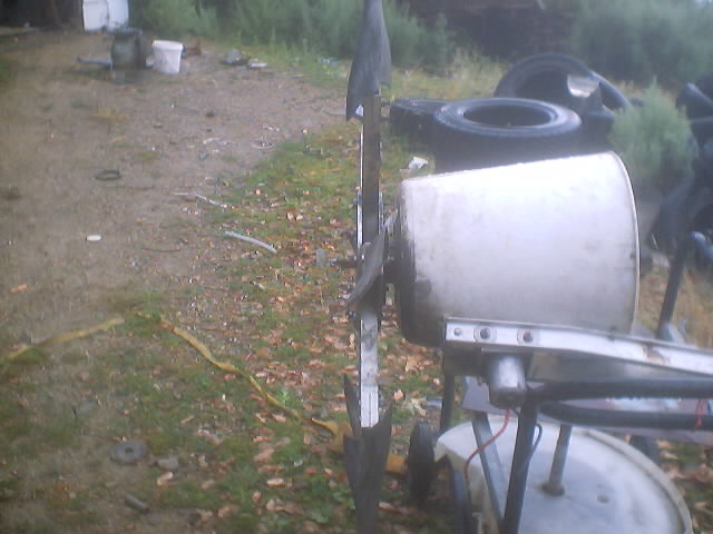

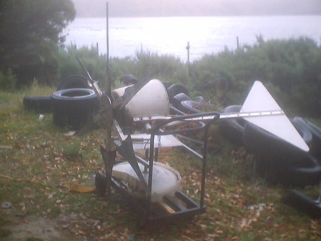

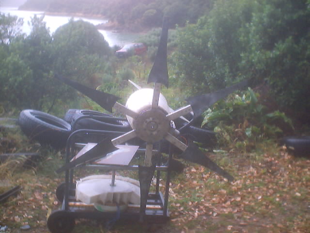

The blades on my windmill for the second time have come loose on the shaft and touched the tower. Being relectant to buy new blades (ex eco innovation) I have shorterned the blades. I would like to fit more efficient blades but as this mill has no furling I see my best obtion is to build a complet new mill. In the mean time I would like to get this unit up again .
What I would like is a educated guess as to what I could expect in the way of its ideal RPPM so I can choose a stator winding.
I have included pics the active area of the blades is now 410mm the dia overal 1.4 M . the blades have a standoff that is the differance.
I have this time put a flange on the shaft so the comming loose of the friction drive that was supplied is eliminated.

Have you considered giving PVC blades a go. In all honesty, there really isn't a lot of difference in performace of comercial blades or home made pvc/timber blades. And if you have a lot of wind, you can get away with very simple blades and still make good power.

We are in a high wind area very gusty and as the hills are very high and steep all my less than ideal sites get channeled wind sure at times comming down 45 degrees. The neighbour with the Aeromag has actually gone though 6 different mills Bergly and other brands. Must get him to cataloge history one day.
The present unit has no furling so I see that PVC blades would destroy themselves.
I have looked at modifying this unit but see better start scratch when time permits.
Your site is giving me great ideas on the design I will use. would it be a idea to borrow a Aeromag blade and cast a mold ? ( if neighbour willing )
The present unit wiill and has been great to gather info and familiarise myself into the world wind power. It was fitted with a 80sp stator this is equivalent 16 turns/coil I have today started on stator 12 turns/coil assuming a faster mill. Also I have have managed to twist one pole so will try that for anti cogging.
May even try the unbalenced three phase idea
This unit is only any use for experomentation.
