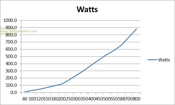

For those interested that are not sure how to interpret the table above, I've made a graph from that same data showing it's optimum operating output. As stated above I used a 36 pole stator wired in Delta mode uncut with a black rotor cap into a 86 ohm load.
Horizontal axis is RPM.
The steeper the rise in operating output power vs RPM the less efficient the stator will operate.
Will upload further graphs to prove my point once I created some new data tables with loads which are too low or too high resistance for the stator to remain efficient.

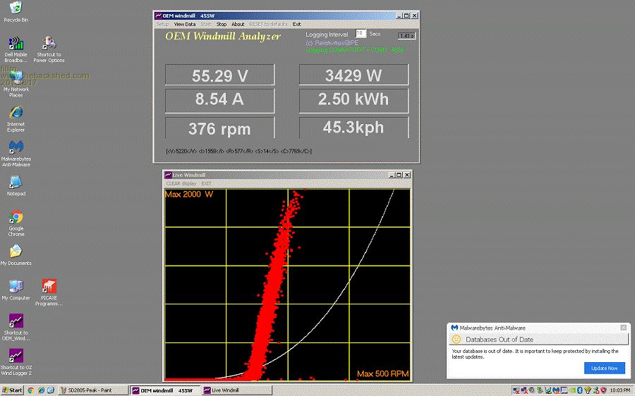

Below is probably a bit of a plug but of no use here as 99.9% of the audience and members here are not the buy it ready to go type and more build it DIY. Also watching for new posts in the wind section here is at an all time low so please don't be discouraged
Anyway what the latest 1kW - 2.5kW OZ Wind Turbines can output into a 48V / 24V battery and all at under 400Rpm with no Epoxy.
The logging screen is for a 2.5kW has been collaged as only 1 peak can be shown at a time but these are absolutely one of the best Alternators. Everything is kept at very low RPMs and in control and coupled with the unbelievable torque of the GOE222 Airfoil it makes them the a very high performance turbine. In 20 - 25klm it is just ticking over at 1kW into the batteries.

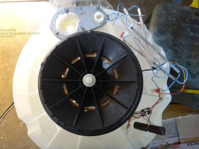

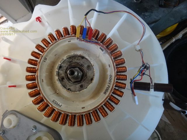

For starters I work with these Fisher & Paykel washing machines as a job and know how they work down to a component level in the motor controllers and motor operation. So understand PWM theory etc.
The data you see is what I got from a single 36 pole copper stator wired in Delta using the new version Black rotor cap.
See photos of test set up (instrumentation not in photos).
The back rotor cap you can see in the lower photo have been used on F&P machines built in the last 7 years, so not many been scarped. This may explain why haven't seen a black rotor cap yet.
My point with doing testing into an 86 ohm load (in same photo to right of black cap) is that it's the most efficient load match over a given RPM range. I'm not saying the FET switching system is a good idea under extreme conditions.

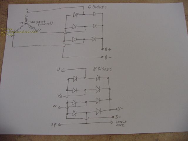

Star delta switching should be very simple with these alternators.
We have the situation where shorting the windings will have no deleterious effect on the wiring due to the inductive reactance... and here it gets interesting.
This shares the same characteristics with car alternators in that respect, so it is not unreasonable to find that the addition of two diode only will allow for automatic star delta switching.. totally seamless and no electronics in sight.
So this can be added to any star connected mill, provided you can access the star point.
The diodes will go from star point to the pos and neg rails... like in this pic from my playing with alternators story. http://www.anotherpower.com/board/index.php/topic,492.0.html
Quite a few of the high power alternators use this now, it relies on the emf of the star combination falling below the delta combination. This will occur naturally, and normally you will see current limiting there, but now with the two diodes added, we will increase the current as the rpm increases until the new delta current limit is reached...... fiendishly simple, and i don;t have a unit to test it on, but if it works for car alts, it will certainly work for these long salient poled devices.
............oztules
Edited by oztules 2017-06-02

Hi oztules
That is a simple solution which I'm now keen to try out.
I'm heading away for a long weekend, but on my return will try this out on a 36 pole copper stator with black cap and let you know the results.
Will even try it with a capacitor doubler to get an even greater power output operating range. Lower cut in voltage at start up then higher current output at high RPM level.
Good work on your part for taking the time to post this to this topic.
