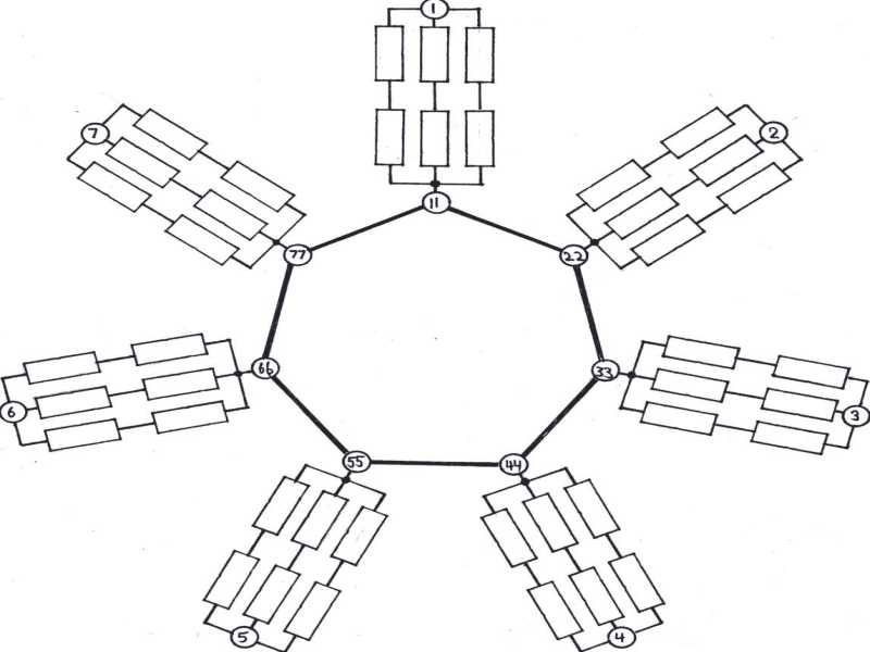

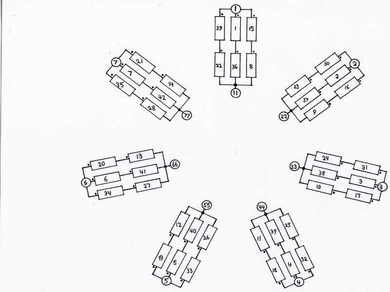

Here is the circuit of my arrangement:
The little rectangular boxes represent the individual coils and the numbers in them are their relative position around the stator. The black dots show the start end of the coil winding. The circles show the tagstrip terminations and their corresponding numbers are within.
The above circuit is how an independant 7ph 2p coil arrangement looks like.

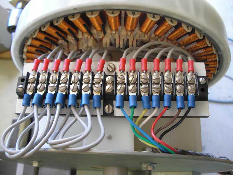

The next pic shows the diagram for a star connection:
And here is how the links for star are located on the terminal strip:

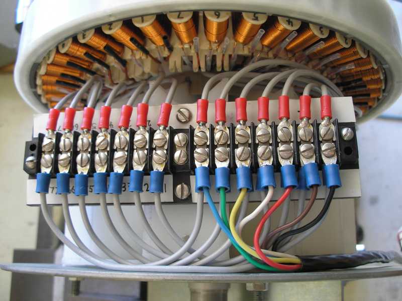

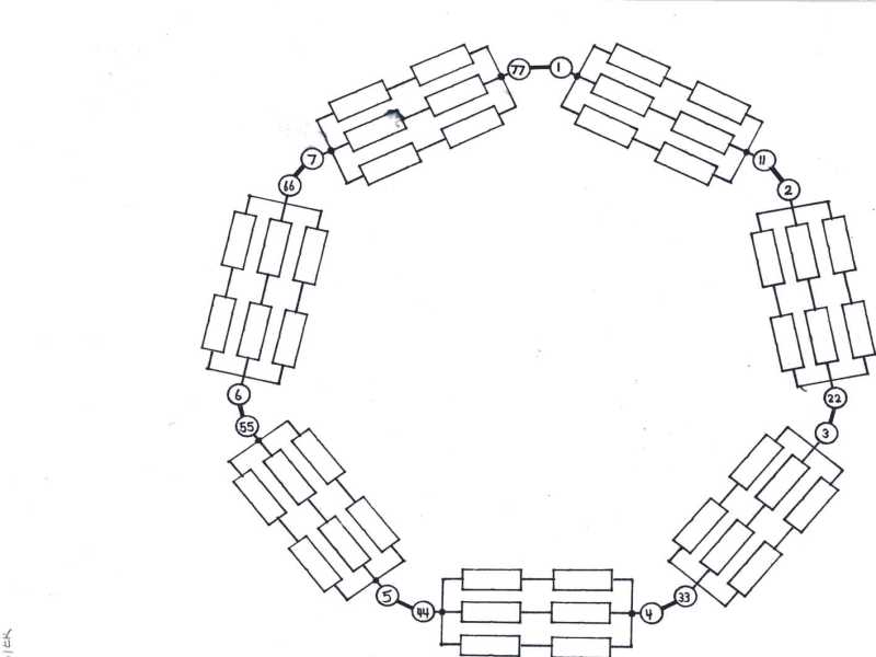

Next pic shows the delta connection diagram:
And here are the links shown how to do that:
I found it easier to visualise the connections when all 42 coils are shown on the diagrams. Of course, it was not possible then to do anywhere near as neat a graphic job as Gizmo did.
