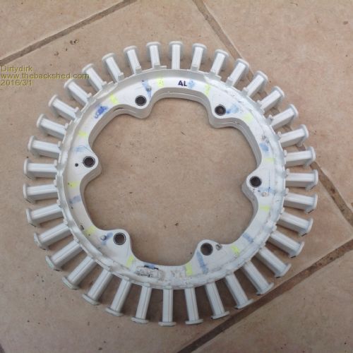

In the UK all staters have aluminium windings so are hard to reconfigure,I am therefore thinking of rewinding the coils with copper wire . Q should I rewind with the same gauge wire or go thicker or thinner

Weird that UK LG uses aluminium, would love to see some pictures.

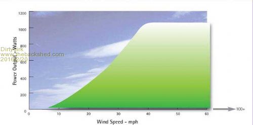

Pacwind Seahawk

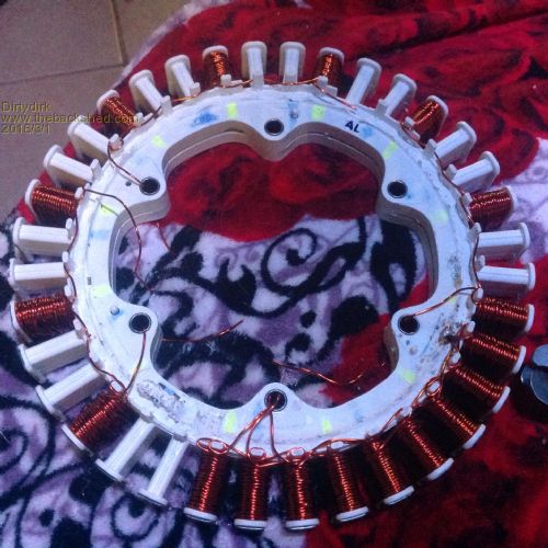

Starting the big rewind 1.6mm

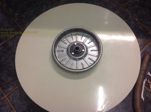

The hub on the bottom plate of my Seahawk/packwind vawt

Got to stop got a blisters on my fingers 42 turns per coil 1.06mm

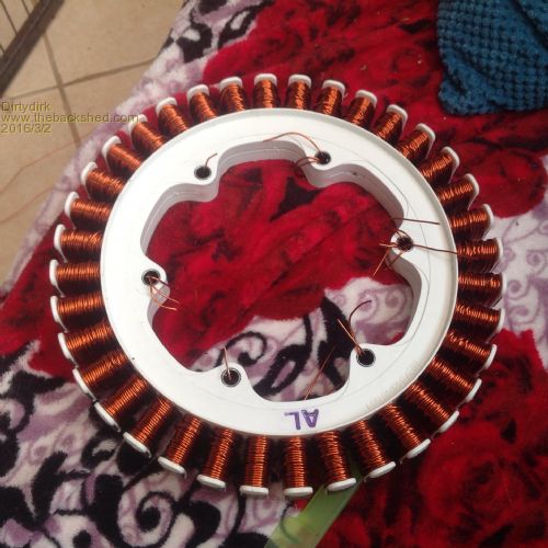

We'll I'll never do that again
Coils are a bit scrape but should do for now
