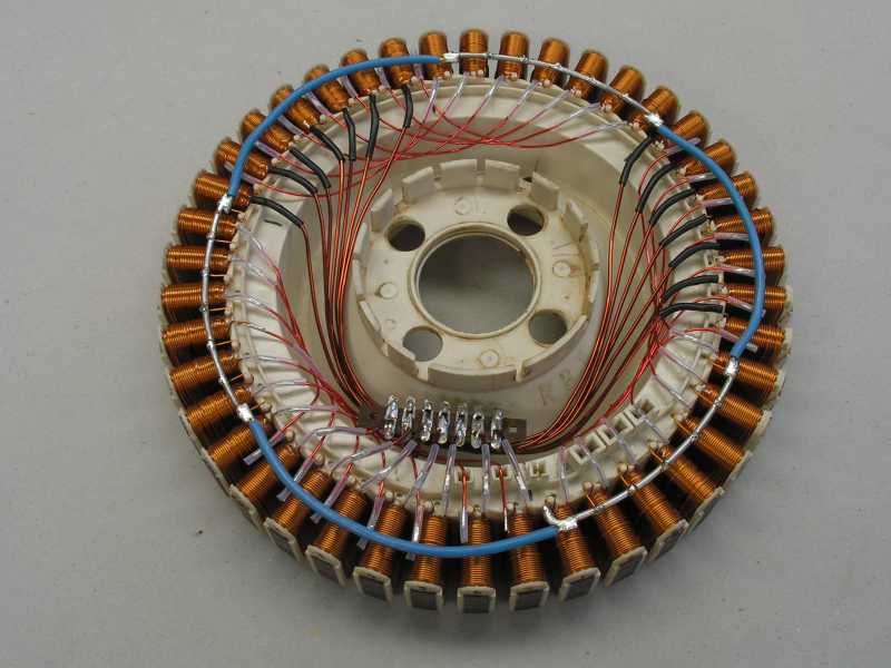

It's a bit hard to see where the wires are all going but it looks like you have 2 pole fingers in series which would make it a 7 phase 2 pole, or am I misunderstanding the picture?
Also it looks like you've connected the star points together, is there any reason for that?

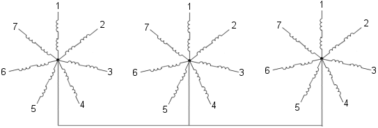

hello everyone thankyou for your time and help can see were we might have gone off the beaten track a bit this is my first time rewiring one of these stators could some one please explain this diagram http://www.thebackshed.com/windmill/images/stator-star.gif as this is what i have done looks nothing like the picture above

Well the web link you have there is for a three phase. If you put a 7 phase magnet rotor on that there will be no output, but it shouldn't provide a huge cogg though, I recon you have a short somewhere. Can you do an ohms test between the phases? If there is a short it will show up with irregular readings between each phase.

Hi Mark,
We seem to use different terminology and I'm not sure who got it right . Anyway, you saw right, there are 2 something in series and there are 3 of these in parallel on my rewired stator.
edit: It seems I had the words "phase" and "group" confused, I just checked back on Glenn's description.
Why would you *not* connect all the star points together?
The way I understand it the current flows out of one end of a (any) coil and returns to the other end via the star point to complete the circuit. So, it flows, at any one instant, on the phase at its positive cycle part and returns via the phases on the negative cycle to the star point. There is only *one* starpoint in three phase machines and I see no reason why that does not also apply to multiphase star connected wiring.
KlausEdited by Tinker 2007-12-13

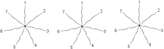

I think there is some confusion on what we are calling the star point. On the photo of Tinkers 7 phase rewire ( excelent work by the way, very neat ), you can see the star points as the silver wire, there are threee of them. This is the star point that needs to be connected together. The blue wire, which is connecting the 3 star points together, is not required. But that said, there is no harm in having it there either, it cant hurt. Put simply, the three stat points in Tinkers stator will all be at the same potential, so connecting them together with the blue wires wont have any effect.
eg
is the same as

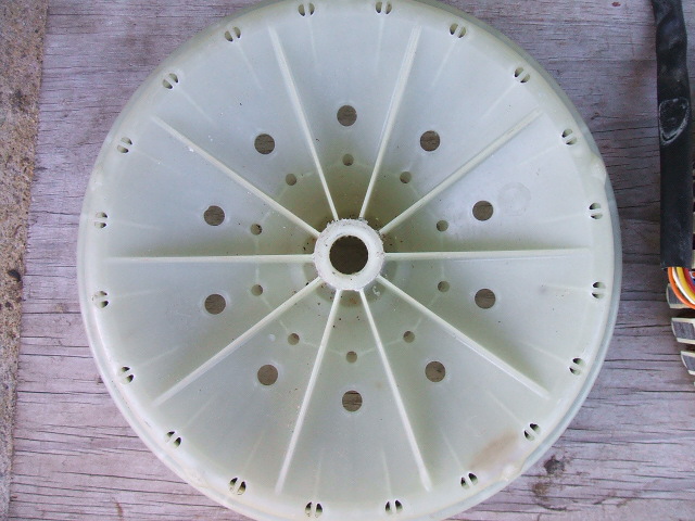

Hi here is a photo of a 7 phase 2 pole conversion as per The backshed diagram,when used with the the new stator(420774P)cogging is reduced greatly.Hope photo helps cheers.

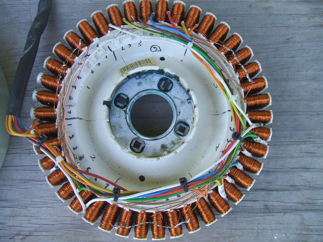

i got hub with the stator. I'd look over the stator for any wrong wiring but looks good to me? also sanded back edged on fingers for less clogging?. pic
By dazler
hand spun it get 25 to 30v 2 to 3amps (max hand spun)
dazEdited by dazler 2007-12-15

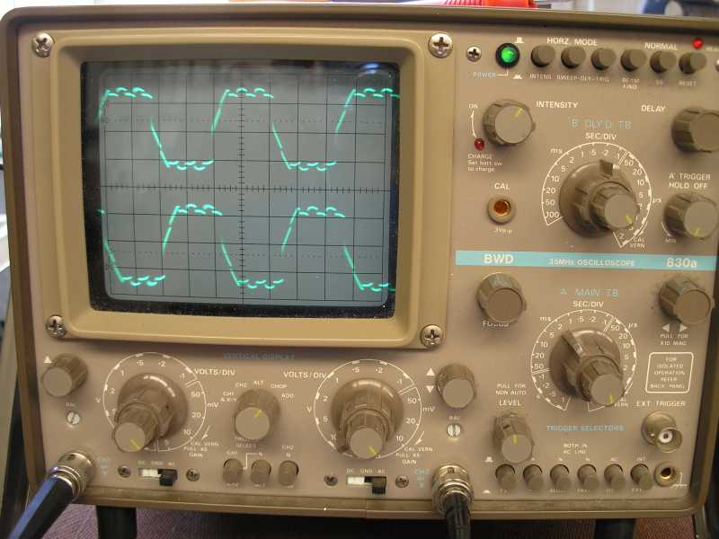

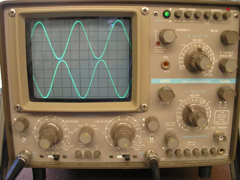

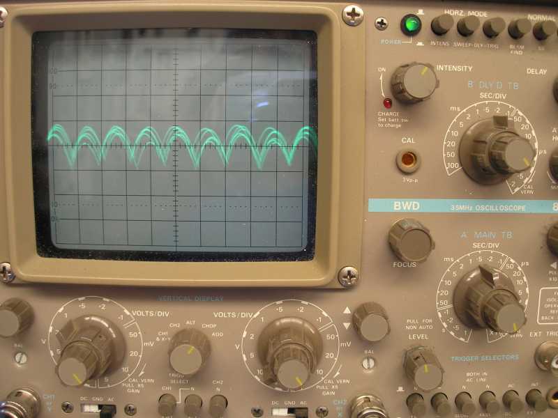

Hi Gordon, below are the wave forms you were interested in. First one is unloaded generator 40Vpp, 122Hz @300RPM.
First and second phase shown with star point as common.
Next one is as above but loaded to 5.5A
Last one is the ripple on the DC at 5.5A load ( it looks the same @ no load)
Thanks for suggesting that, the loaded trace certainly looks interesting. What do you think causes the little 'wiggles' on the squared off trace tops? And, could they be responsible why my overrated schottky diodes get warm on a heatsink? The diodes should be stone cold at that load.
Posted: 10:18pm 14 Dec 2007
I could be wrong but I think those little squared off ripples on the top of the peaks are the rectified loads from the other phases. At the peak, the phase your looking at is taking the load, along with 3 or 4 other phases. I think you are seeing the other phases switching in and out. If you apply more load then this flat top should get wider and you should see more ripples.
I think this is normal, and the same thing happens with 3 phase but its not as obvious. Its not often we come across a 7 phase AC source.
