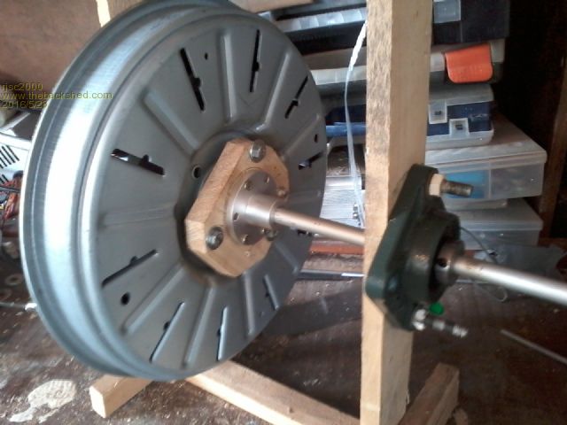

rjsc2000
Joined: 17/12/2015
Location: Portugal
Posts: 13

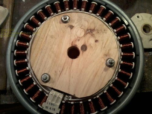

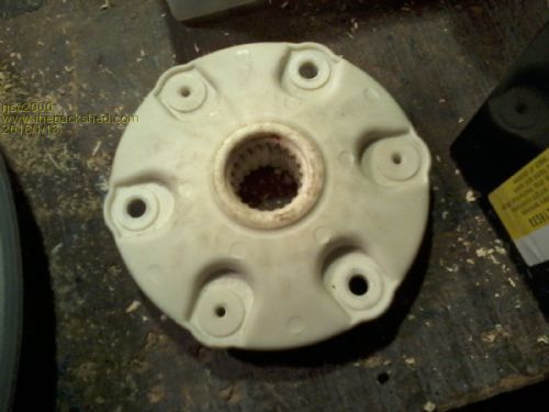

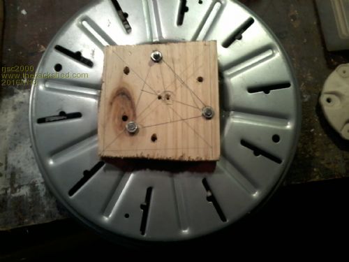

Posted: 11:02am 13 Jan 2016
Hi
Here goes the photos. Remember that I'm not an expert :D
The part that comes with the motor
The Rotor
The Stator
govertical
Joined: 11/12/2008
Posts: 383
Posted: 01:09pm 13 Jan 2016
Hi, nice start. I use 3 bearing hubs and 5/8 drive shaft.
https://drive.google.com/file/d/0BwO5zSDThdxFWWNfbHVRdEp4T0U/view?usp=sharing
Two bearing hubs with long bolts attach the stator to the frame on one side of the frame. You need to attach the mag hub to drive shaft.
https://drive.google.com/file/d/0BwO5zSDThdxFOGwtOVM5QUF4SDg/view?usp=sharing
The third bearing hub is attach to the other side of the frame. Then I use a plastic shim to center the stator.
https://drive.google.com/file/d/0BwO5zSDThdxFbHV4SWZlcFF3alk/view?usp=sharing
I hope this helps, I look forward toward your results. Keep at it, you can do it.
Edited by govertical 2016-01-14

rjsc2000
Joined: 17/12/2015
Location: Portugal
Posts: 13
Posted: 02:46pm 13 Jan 2016
  govertical said   Hi, nice start. I use 3 bearing hubs and 5/8 drive shaft.
How do you attach the mag hub to the drive shaft?
I understand the part of the plastic shim to center the stator, but what do you do after you center it? You mark the holes then?
govertical
Joined: 11/12/2008
Posts: 383
Posted: 03:15pm 13 Jan 2016
Hub with set screw
Hi, I was able to fabricate a hub with set screw to mount the mag rotor to the drive shaft. Fabricate the frame and mount the stator, keep it as centered as possible. Use the the drive shaft to align all the parts. Then mount the mag hub to the drive shaft, keep it as centered as possible.
The holes on the stator adapter plate should be a little over sized then use the plastic shim to center the stator to the magnet hub and tighten the bolts. Once the frame and stator mount are fabricate, it will be easier to visualize the all the other required parts.

govertical
Joined: 11/12/2008
Posts: 383
Posted: 03:41am 14 Jan 2016
bronze bushing
shaft collar
Hi, this may help with the parts you may need. Bronze bushing will replace the bearing and a few shaft collars could be glued to the wood to create a hub with set screw to mount the mag hub to the drive shaft. I look forward toward your results and these are just suggestions. Cheers.
Place a small piece of copper under the set screw and it will prevent the set screw from marking the drive shaft. It will make it easier to disassemble.
When not using the generator I leave the plastic shim between the magnets and the stator, it helps keep everything centered while in storage. Edited by govertical 2016-01-15

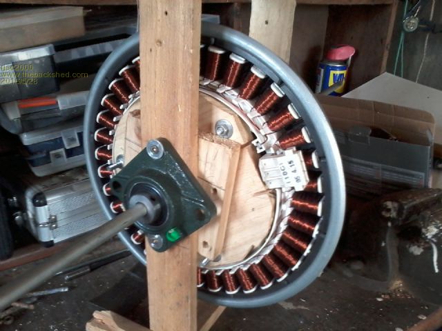

rjsc2000
Joined: 17/12/2015
Location: Portugal
Posts: 13
Posted: 04:39am 14 Jan 2016
Thanks.
At this moment i'm more concerned how i will center all the pieces and make sure the magnets won't stick to one side when assembling.
The plastic shim will help but i think the stator and the rotor and the shaft must be perfectly centered so that it doesn't stick to one side.
