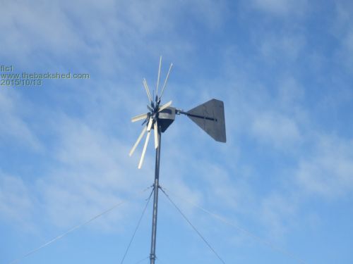

have finnaly finnished developing the right stator setup for my windturbine, it is a similar setup to what Davep68 has decribed, I wish I had seen his test results before I started building mine, I must have pulled down my turbine 10 times in the last year or so to test diffrent stators etc, anyway,,, now I have installed 2 x .6mm 36 pole stators, the first is direct drive and is electrily cut in half,with each half wired in delta, cutin rpm is approx 140rpm, the second stator is cut in 3/3 ,and each third is wired as star, and it is geared up 1.5 times, to cut in at approx 75 rpm, both stators are fitted with the black rotor caps,with the stronger magnets, there is a slight loss of rpm in light winds due to the extra loading from the stronger magnets, but a large gain in power once the windspeed increases, I have gone away from useing the 42 pole stators as there always seems to be more cogging with them when compared with the 36 poles, even after decogging. The turbine has 8 blades ,with a diameter is 2.4 meters,with a swept area of aprox 2.3m, peak rpm is approx 500 rpm it is useing a 1000watt 45-90v dc input gridtie inverter.So far it has reached 855 watts on the ac output side of the inverter, so thats about 925 on the dc input side, and the turbine was nearly at its furling point, so I hoping to get about 930 peak ac output when turbine starts furling, finnaly I am happy with the output of the turbine

Gday Dave,yep I had batterys hooked up to my windturbine ,Im on the grid, and I know they are a must have if you are off the grid and don't want to live by candle light ,this is just my experience with them. I was useing them as a voltage regulator,the turbine never seemed to perform aswell through the batterys,to much wasted energy going into the batterys to keep the inverter going and the voltage up,I had solid state relays to stop the batterys being cycled too deep,to try and make them last, really just a pain in the ass, blew up 2 inverters, and a charge controller,made my own dumpload resistors etc, I was trying to do things on the cheap but it ended up costing heaps in money and wasted time looking after batterys and replacing cooked electronics and cooked batterys,when I found the actual windturbine gridtie inverters online it was a relief,they come with there own dumpload resistor,just hooked it up ,and forgot about it.so much easier,,,they work well.So Im not really a big fan of batterys at the moment,but who knows what the future holds, with the way the power companys in this country ripp everybody off, we may have to go off grid one day in the future,our gridtie system at home is about 4.2 kw solar pv and 1kw windturbine,and a 300 litre solar water heater, ,the testing you are doing with the f n p stators is good,very handy for any body wanting to work out what setup they may need for there f n p wind turbine or hydro, cheers Fred Edited by flc1 2015-10-17

Just an update,turbine has recently put out 957w ac, ,, more than expected, I did'nt see if was furling, not at home at the time.
