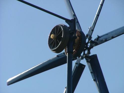

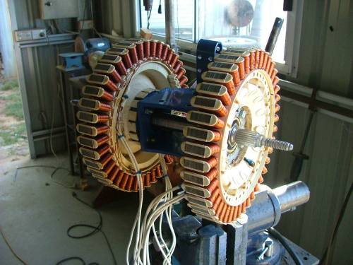

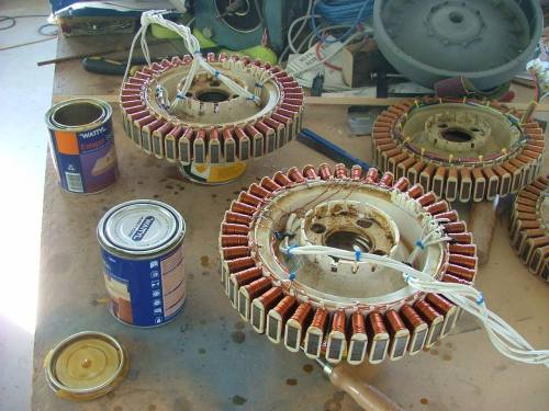

Finished the dual stator windmill this weekend. I re-wired the two stators in a staggered configuration as discussed in this thread http://www.thebackshed.com/windmill/forum1/forum_posts.asp?T ID=749&TPN=1, then gave them a good coating of clear varnish to protect against the weather. The stators are not decogged, and its a 3 phase arrangement, but I was pretty sure the large turbine would overcome the cogging.
Next I bolted them to the new nacelle. The shaft has had its spline extended by Trev ( See his web page, click on his Windmill Parts page. http://www.thebackshed.com/foundryandfibreglass/)

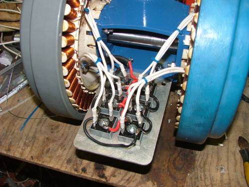

Then I connected the 4 3phase rectifiers.

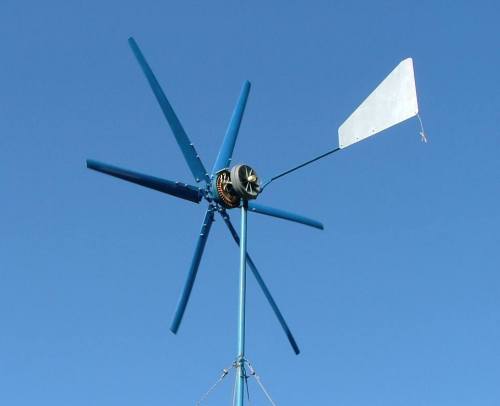

And lastly the finished windmill was put up on the mast. I used my new 6 blade turbine ( see http://www.thebackshed.com/windmill/forum1/f orum_posts.asp?TID=744&PN=1 ), this has been driving a single stator for the last week and made more power than the stator could handle, a few times I saw the power peak at 8 amps but the turbine continued to speed up, the stator was a 7 phase 3 pole 60 series wire, so was working pretty hard.
Initial results look good. In a light wind the mill was feeding just over 1 amp into the 12v battery bank, and started easily. Later when the wind picked up I saw 15 amps a few times.
