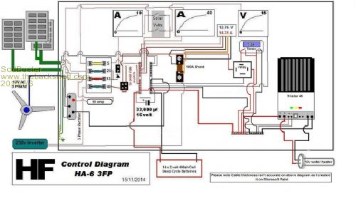

Thanks for your comments. I have only recently acquired a regulator/controller and dump load which I now have installed. Previous voltage regulators were home made and less than reliable. Dump load is a triple element water heater.
Check out latest version of diagram ( not finished yet )

Sorry This is the link for the diagram Wiring Diagram

Nice circuit drawing in MS paint, it can be a good tool once you have mastered it .

Thanks PhillM will do that next time she's down. Just done a simplified wiring schematic in Power Point much easier wish I had though of it sooner

Done it again forgot the link

Great schematic; no rat's nest!

you dont show a stop switch to tie the 3 phases together before the rectifier. have you got one or dont need it?

I don't have a stop switch the automatic furling system combined with the manual furling system I made. So far it works a treat and leaves me totally in charge, as long as i'm their to close it down in high wind conditions. Often wonder how long it will survive as it furls on and off almost continually in gusty conditions which we have had here for last couple of weeks. Great for generating but causes a lot of resonance in the tower. Have thought of stop switch but would fear damaging the stator or burning out the cable from tower down.
