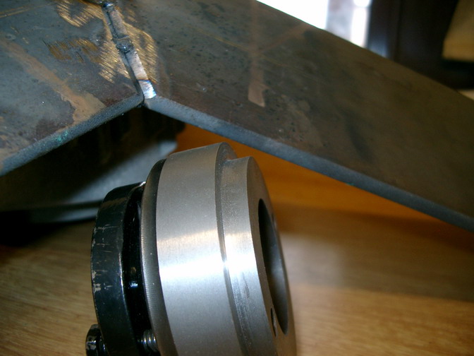

Hi Guys
Could you please have a look at these pictures,I have made some alterations and would appreciate any ideas before I weld it up !!

G'day philmountains,

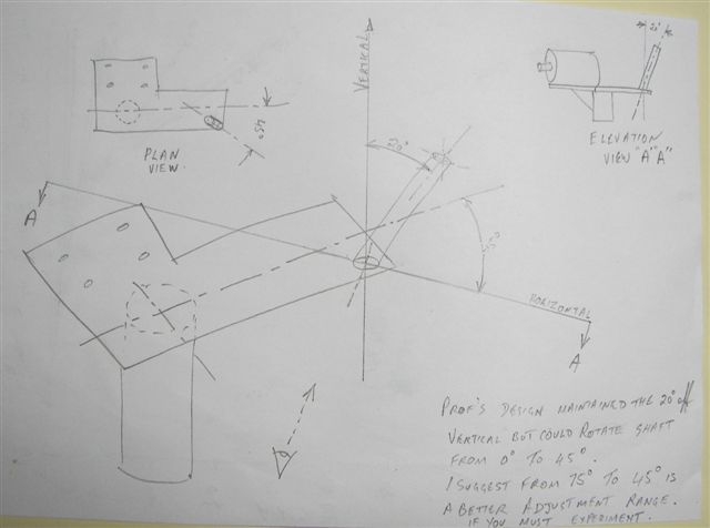

Just quiring your furl pivot. In the pic it seems to be angled 20deg but only directly back. If this is so, there will be no weight acting against furling.
Check this sites bit on furling and the diagram shows the pivot as being 20deg off vertical and at 45deg off front to back axis.
In your pic the top of the pivot pin will need to be moved further out to the left. Perhaps by cutting the back tack weld and pushing down on the plate to bend it downward? May break the side tack welds but I hope you can understand what I'm trying to say.

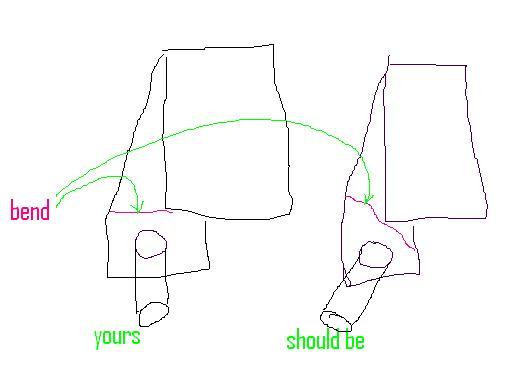

Posted: 11:10am 13 Sep 2007
Here's a ruffy of how it could have been made.
Cheers Gill _Cairns, FNQ

Thanks Gill,I printed off your diagram,which made "Furling" a lot easier for a novice (like me)to understand than Hugh's book.
I did not weld up up the Yaw bearing,as I did not know if it needed 45 degree to work, you have now helped me to push this project along a bit further.
I will grind off the tacks from the pipe/Yaw bearing to the plate and set it to 45 degrees tomorrow night at work ,I know this is not what you had in mind but it will give me 45 & a 20 degree angle is this still right ?

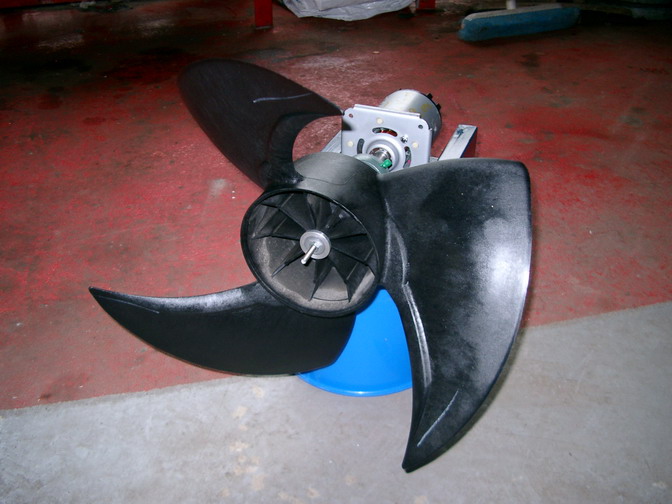

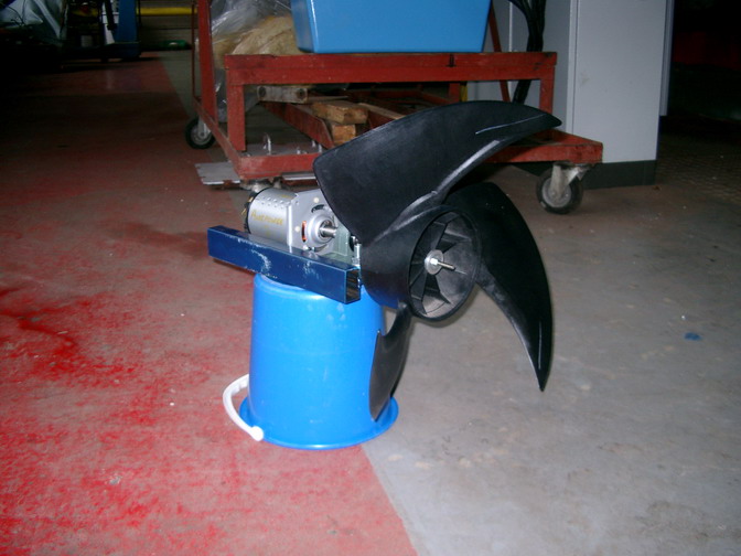

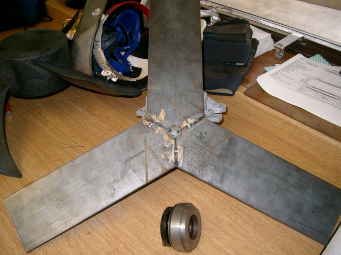

Here are a few more pictures a couple of the blade/prop mouting plate I made up and the last of another smaller mill with a bade set up I found in a old chiller unit,
This will need a bit more work on the blades before it will work I guess !!! I love to see other people ideas so here are some of mine
Thanks again Gill for your help.
Phil

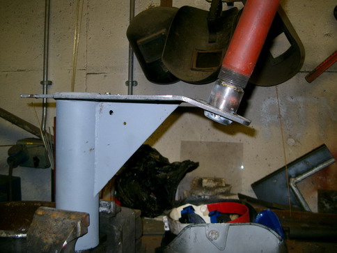

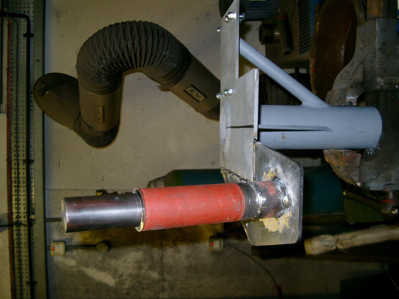

I have managed to do a bit more to the project this month,Not too sure if is all OK though ?
Firstly I welded up the yaw bearing angle to what I thought was 20 degrees found out today it pulled whilst welding and is now 28 degrees !!! is this a big problem ,do I need to light up the cutting torch !!!!!!!I wish i had made his with a hinge mech now as it took me ages to try and get these angles(what does the 20 degrees angle affect sorry to be ignorant )
Also the boom and tail weigh 10 kg is this far too heavy ? I used 3/4 inch red band tube ,I was worried it would bend, now I am worried it would need MPH wind to furl this weight !!!!
Thanks again you guys for all your help and advise

Posted: 11:16am 10 Oct 2007
Phil,
Those angles look way to much. I guess you have seen the way it is calculated. Have a look at

Posted: 12:33pm 10 Oct 2007
G'day Phil ,
Afraid I have to agree with Trev.
I'm thinking you may have got the 20deg and 45deg mixed up?
That's 20deg off vertical in the direction of South West(for your mill)
With a tail of 10kg and that 28deg(looks like 45deg) you will need a massive wind to furl. I think best to give it another go.
With a 10kg tail weight i'd even try 15deg.

Thanks Guys for your advise,a bit sick, but knew it was going wrong.
Can I just recheck with you before I do some serious gas axing, 15 to 20 degrees is the side angle and 45 degrees is the tilting back angle .
Also was thinking about tail boom weight, I was thinking of trying to use ,say first five inch, cuttng out then welding in some thinwall ? by the way the tail is made from a spare sheet of perspex that was laying around !!! its so hard when dealing with scrap builds !!!

Here's how I would have drawn your first sketch.
I see your second sketch just shows measurements. If they are from Glenn's plans on this site then that would be correct.
