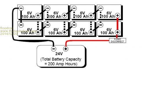

My question is: On the diagrams, cross tied banks show the positive lead going to one battery on one end, and the negative going to the opposite end. But on my setup, the Positive and Negative leads connect more like Buss-Bar style.
With a cross-tied bank, is it OK to connect pos and neg leads to a common bus bar, or must they connect to 2 individual battery terminals?

Sure..
The dotted lines is the cross-tie. Exact same as my setup, but mine has 1 more row of batteries.
Notice the battery feeds go to 2 battery terminals. If my parallel connections at the end battery rows go to a buss bar, I assume I can just hookup to the Buss?

what they try to do is give each battery the same total cable resistance. So if you trace a path through the circuit past each battery the total length of cable and number of connections should be the same for each cell.
