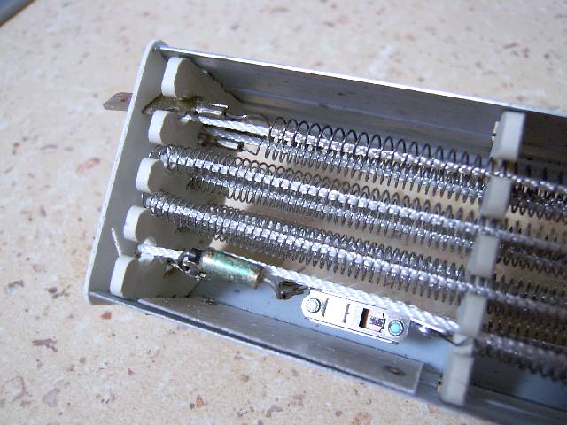

Posted: 02:23am 04 Sep 2007
Hi Everyone.

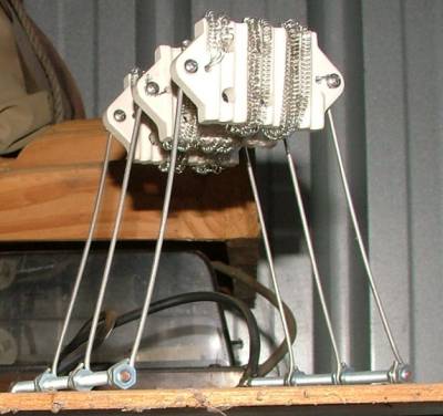

I've used the cheap old jug elements before too. I unwind the coil, gently so I didnt stretch out the spiral, cut it in 4 and rewound is like the pic below. I used 3 jug elements together, on a couple of lengths of 1/4 inch allthread. The allthread becomes the dummy loads terminals.
Light bulbs can be a bit of a problem as dump loads, they have a negative resisance sort of effect. Once the filament starts to glow, its resistance is not linear with voltage. eg, at 6 volts a 12v bult may draw 2 amps, but at 12 volts it will only draw 3 amps, not linear as you would expect from a dump load. And bulbs can blow, leaving you without a dummy load. If you break a bulb to expost the filament, and apply enough voltage to make it glow red, measure the current, then gently blow across the filament, the current will increase! Its the same princible used by the hot wire mass air sensors in some modern injected vehicles.
Posted: 02:50am 04 Sep 2007
That looks great Gizmo.
Do you use those elements in air, or submerged? But I really like the very neat way you have connected them in series.
Other source of resistance wire might be from an old hair dryer, toaster, or Tangi type fan heater. These would run quite hot, especially without a blower going. But submerging the elements in water (or oil) will vastly increase the power sinking capability.
The actual resistance wire itself should not be expensive. But I am sure most of us can fairly readily scrounge some for free with a bit of thought.
At least you know that whatever it came from could support 240v across whatever length of wire is in there. That is a pretty good basis to start from.

Posted: 12:51pm 19 Mar 2008
hello to everyone

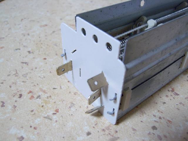

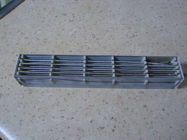

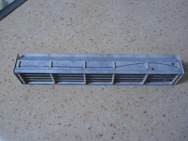

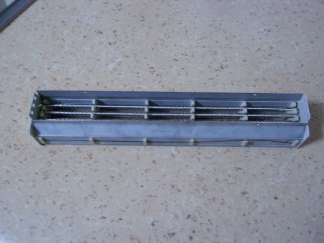

I was looking around for a shunt/dummy load for the f&p for a long time and today it came: F&P's own heating coil of the smartdrive: nicely sealed in a glass tube, no need to insulate it, just get enough together for the load you need and connect it parallel.
The tube sits in the bigger electronic board in the aluminium tube, I found 2 different lengths; one 20 ohms the other 28 ohms, perfect!
regards to everyone.

Gill
Joined: 11/11/2006
Posts: 669
Posted: 01:36pm 19 Mar 2008
G'day Harald,
Good discovery. I note the board has it labelled as 'BRAKE RESISTOR' which makes sense as hot water is fed in from the hose connection. I'm guessing it is for stopping the tub from spinning like when the lid is lifted during the spin cycles.
In this role it would be back EMF braking.
A concern I see is that when used in the washer it dumps heat into the bulk of the water inside the heat sink, but as a windmill regulators dump load a different form of cooling may be needed.
Have you given it a try using it as a non-water cooled element?Edited by Gill 2008-03-20

carl1
Joined: 16/04/2007
Posts: 79
Posted: 11:17pm 19 Mar 2008
Hi Gill, this element is like a normal resisitor, it is not in direct contact with the water in the washing maschine. it's just a long spring, housed in an insulating tube. You even can pull the wire out and shorten it. It's a perfect power resister, dump load for air cooled application and doesn't cost anything.
Power resisters like these would be quite expensive to buy.
