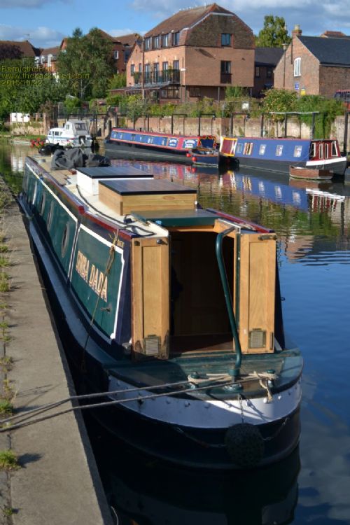

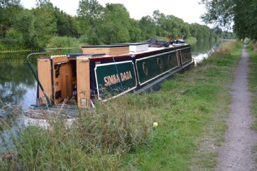

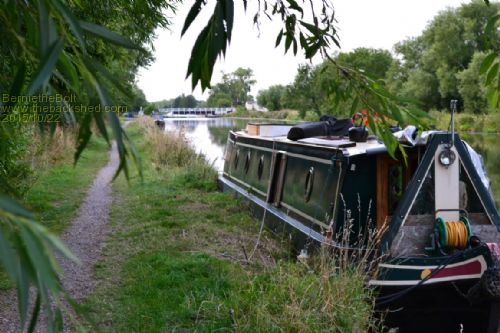

Here art pictures as promised of "Simba Dada"

Posted: 12:03pm 22 Oct 2015
She's a nice looking boat Bernie
Posted: 12:12am 23 Oct 2015
  Gizmo said   She's a nice looking boat Bernie
Agree with Gizmo, nice looking boat indeed.
But the method of steering her - standing up at the aft end - must be very tiring on long stretches or in bad weather. Does you boat have a forward inside steering position?
