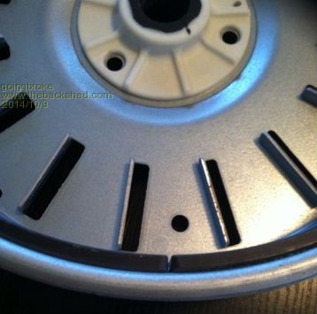

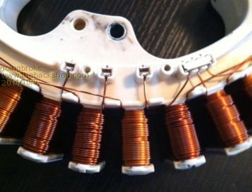

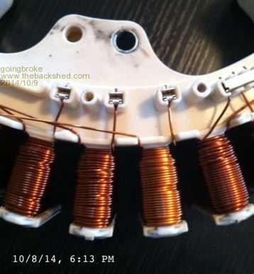

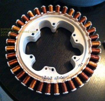

Hi all, I really need your help. I am trying to help my Grandson put together a VAWT. Trust me if I have a chance to get him to stop playing video games, I am all in. I told him if he could find a motor we would go from there. Well this is what he found. I have check this forum and others and found very little about 36 coil stator. And to be honest I have not seen this type of wiring set up. If some one could point me in the right direction to learn more it would be great. We are looking at charging a 12V system or if we can produce enough maybe a grid tie.

Its a good find. Similar to a F&P Smartdrive, which we commonly use for home wind turbines.
But need some more info first. How big do you plan to make this VAWT, and what type. Also, what about a HAWT instead, it would give much more power.

Hi Glenn, Thank You for all your great input. I have done some basic testing on the motor. And you are right is has plenty of out put. I hooked it up to a 3 phase rectifier to check DC output buy hand turning. It did good 75+ volt DC, but like I have read here, under load it gets very hard to turn. Unless I totally misunderstand that the rewiring would lower output put increase amps and make it turn easier under load. By the way I check out your VAWTs very nice job..

You can re-wire it and yes, you need higher RPM to make the same volts and will give more amps at higher Rpms because of less coil resistance, but as for making it easier to turn under load " NO " If it producing 100w at 50rpm @24V and you halve the stator " Basicly " now it produces 100W at 100rpm @ 24v , the input load ( torque ) will be almost the same give or take a few grams/Oz.
In a nutshell " it changes the Rpm to give the same output , input load stays the same" This is how to get blades to perform better and not be stalled.

This looks exactly like the stator of what we in South Africa know as the DD (Direct Drive) made by LG.

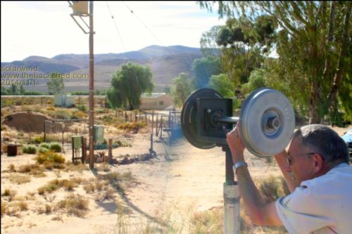

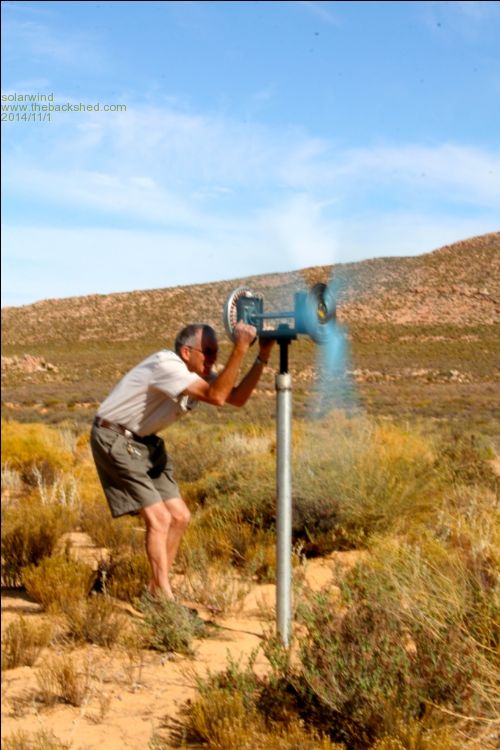

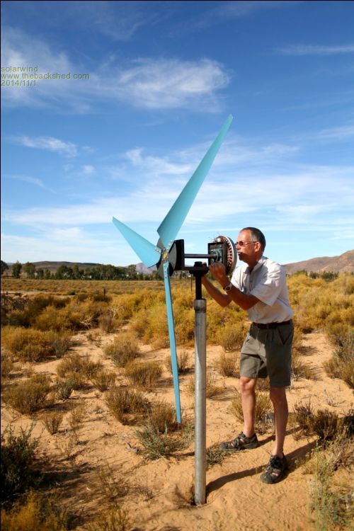

I have bought a stator and the magnetic rotor from their service and repairs department and have started to make an alternator using a shaft made up by an engineering firm. The whole assembly is in a metal box with plumber block bearings, one on each side.
My blades were cut out of pvc pipe from a design elsewhere in the forum.
Had a few tests without a tail by holding it head-on in the wind by hand.
Hair raising experience!
I split the 36 poles in half. Then re-divided the 2 x 18 poles into 3 sets of 6 poles in series (for each half). The original star point then forms the star point for one group of coils. The other half is also connected in star, by connecting the original 3 input wires together. The two star points are then connected together to form a common point.
At the splitting point, you are now left with 6 wires: 3 for the one half and 3 for the other half of the coils. These 6 wires are fed to 2 x 3-phase bridge rectifiers and their dc outputs are in parallel. (Could also be in series if higher voltage out is required). The two halves each represent a three-phase alternator and the connection as described gives a 180 deg phase shift between the two star windings. By doing this, the ripple on the rectified side is very small.
Turning it slowly by hand at about 1 rev/sec lights up a 24V automotive bulb of 21W and about 27 volts is measured. With the blades on in a stiff breeze, I measured up to 78V.

First steps I took, was to use a permanent marker and marked all the poles, starting from the original star point (this is the place where you'll see a common connection on one of the terminal blocks on the stator). I just started and marked them R,Y,B,R,Y,B,R,Y,B,.....and so on till you reach the last one (pole number 36 in my and your case). Now you'll notice that all the coils marked "R" are connected in series till the last one, all the coils marked "Y" are in series and all the coils marked "B" are in series. (Three sets of coils; 12 "R" coils, 12 "Y" coils and 12 "B" coils). If the stator is to be divided into 2, it means you'll have 6 coils of each "R", "Y" and "B" in the one half of the stator and 6 coils of each "R", "Y" and "B" in the other half of the stator. Starting from the common star point, count all the coils up to and including the 18th coil. Between the 18th coil and the next half of the stator, 3 wires needs to be cut in such a way that the two halves are electrically disconnected from each other. Now there will be 6 wire ends. Connect 6 flexible flying leads to the cut ends.(Remember to carefully scrape off the enamel on the wires before attempting to solder on the 6 flying leads). Next locate the 3 original wires next to the star point where the power was connected to. Connect them together AND connect them to the original star point. You now have two halves, each with its own star point and each with 3 flying leads. (This resembles a so-called Y/Y6 connection which means 2 star connected sources, differing by 180 degrees, hence the 6 or 6 o'clock). The 6 flying leads have to go to 2 x 3-phase rectifiers (3 leads from each half of the stator are connected to its own rectifier. The DC output of each rectifier is connected in parallel with the DC output of the other; i.e. (+) to (+) and (-) to (-).
