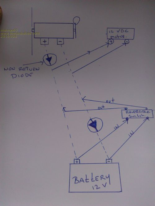

hi.I have a 2 core cable coming down from my 12 volt turbine to the battery.I need to know how I can use those same cables to individualy power my brake motor.Can't figure out which way to use the diodes to stop turbine powering brake motor.thank you.

Wont work, you need to get at least one more wire up to the windmill. 3 wires, a common, one from the generator, and the other to the motor, which can be reversed with a bit of clever stuff. Do you know any auto electricians?

I had that figured out have a 3 core cable in place.brake system made from disc and caliper.justctryongvto find out what motor I need to pull calipervcable.thx
