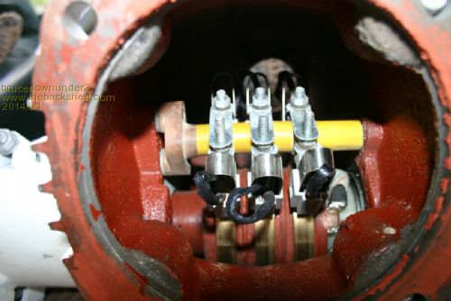

Can't sleep ,, anyhow , this is a picture of the Exmork slip ring assembly while I was retrofitting it with brass and stainless steel hardware-the factory stuff was allready rusty during shipping!!.
As you can see ,the brass slip-ring assembly is around 30-35mm dia, this is perfectly central ,of course. So, getting a cable ,steel or copper down inside there is no problem , just enclose it in a 8mm brass tube ,so the other cables don't rub on it.
