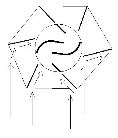

i have seen a system that uses a scroll as the savoniouse, there are numerouse blades set about 200mm apart on the outer circumference of the rotor, these can be varying in lengh

What you are doing by increasing the height(length) is increasing the torque but only by the fact that you have increased the capture area. This tall height is primarily to make up for lack of torque because it is designed for higher speed.
So basically a short fat savonious will have higher torque and slower speed and a tall slim savonious will have higher speed but lower torque for the same capture area.
I'm calculate that by adding the fixed vanes they increase the capture area but maintain the high speed turbine profile. Very clever!
Be aware that these vawts are aerodynamically designed, your sketch was not. Their turbine has multiple blades also aerodynamically profiled, your sketch showed a simple savonious. Whilst I now see what they have done, I would be cautious of just slapping something together that looked close. Still a very interesting project if you're prepared to get into the figures.
Good luck with it.

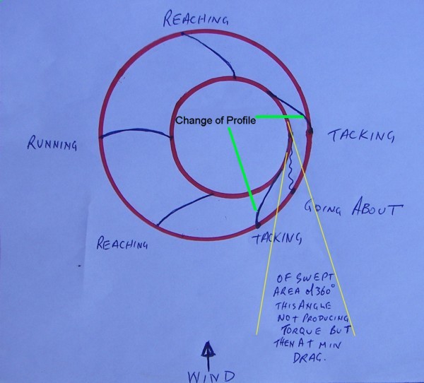

I am of the opinion that for a VAWT to be successful it has to harness the wind from most all of it's swept area. If it fails to generate torque on it's approach to wind it is merely a drag machine. The example I would liken it to is a sailing yacht. What degree can the America's Cup challengers sail into the wind? Is it not something like 5deg??
With a 360deg change in relative wind direction to the turbine blade, I feel that like a yacht's change in sail profile to suck out the power, a VAWT needs to change each blades profile as it changes angle to the wind too.
Hence my inclination to a flexible blade skin. But I dream to much.
The used of deflection vanes to make the wind change to suit a fixed blade's current angle must reduce the available power. If it sacrifices some power to apply it to a smaller swept area for the purpose of higher revs, well and good. But I can't see where vanes can increase power over a turbine of equal capture area, and certainly not 3 times the power. Perhaps on a poorly designed drag machine.
One thing for sure, designing a new successful VAWT won't be easy.Edited by Gill 2007-12-19

This is my idea of changing profile. Applied to Glenn's early HAWT
Edit: Ooops! topmost sail/vane is back-to-front.
If you've ever done any sailing you'll immediately understand the terms and aerodynamic profiles. In basic theory this should produce torque for most of the 360deg.
In reality there are considerations of relative wind flow as well as changing flow through the turbine itself. Still I feel a turbine with an adaptive flexible profile such as this will cope with these without the need for the DIY experimenter to have a degree in aerodynamics and a wind tunnel.
And before you say it, I agree, All those working parts are a minus.
But any comments on the principal idea? Edited by Gill 2007-12-21
