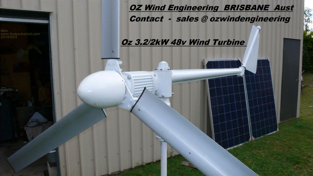

As usual with Chinese stuff, they almost got it right. With Huaya and Exmork The Nacell & Tail is rock solid but..... Blades
I have also taken on the Huaya Distributorship on the East coast , I now Import them as Nacell and generator, then put the Oz Wind GOE222 blades on a Heavy duty 10mm steel blade 2 piece hub with laser cut 16mm steel clamps, 2 piece meaning you do not need a 10t puller to get it off after 6 months. I have in stock 1kw 24v & 48V and 2kw 48v kits ,Controller +Dump load This is a 2 stage PWM wind solar with LCD screen and I can fault it. PWMs to the 2kw dump load and works extremely well as a battery charger, the 9mtr tower comes with every thing ( guy wires are 8 mm with 16mm turnbuckles. I won't put prices contact me if you want more info there , pictures and vids will be on my web page
I will also be selling the as replacement blade hub assemblies separate to people who want better output or the blades have delaminated as they can do being 2 piece and glued , the mount with all these is on a 10 : 1 taper 24.2 to 32.2mm Dia.

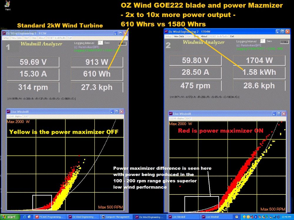

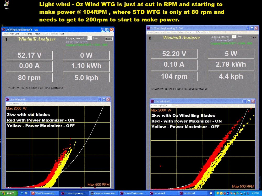

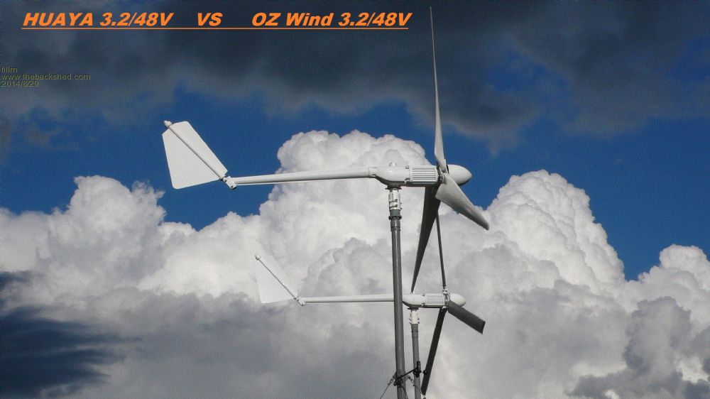

The Genuine blades look fantastic but it stops there with performance , they can not track the wind and need a howling gale to even come near the rated output . I have 2 2kw/48v flying here being logged 24/7.I have told the factory their blades are poor performers , but they sell shi#laods, so why change .
What I see most of the time on light wind days is the Oz Wind 2kW with the GOE Blades spinning while the other is stopped, sometimes it tries to get going in a puff but buy the time it starts the OZ 2kW has been making a some power, and coupled with the Capacitor "Power Maximizer " and with 24/7 logging I always see a reading of 0w/hrs verses 100wh ~ 400Whrs, this all accumulates to a lot of lost power in light wind. This might not seem much but to off-grid people it can mean a lot.
Huaya do manufacture a brake for the 3kw turbine its a multi disc cable operated and neatly sits behind and inline with the generator.So the generator end shaft will be different. In my opinion it may make the blades sit to far forward from the pivot/tower and with the std blades it could cause the head to get a constant yaw to the opposite side to the off set, and do 360s like the 2kw, but maybe even worse ... will see when I get one up. This constant yawing to the wrong side happens constantly on the 2kw std, will the bigger ones be further affected with this, I would think so. I call it "Blade Paddling" for the sake of a better word as this is what it appears to do. I have video footage of it and will have that on my web site when that gets going. The GOE being a constant cord do not seem to have this problem and lock on to the wind direction.
I am working on furling mods ...

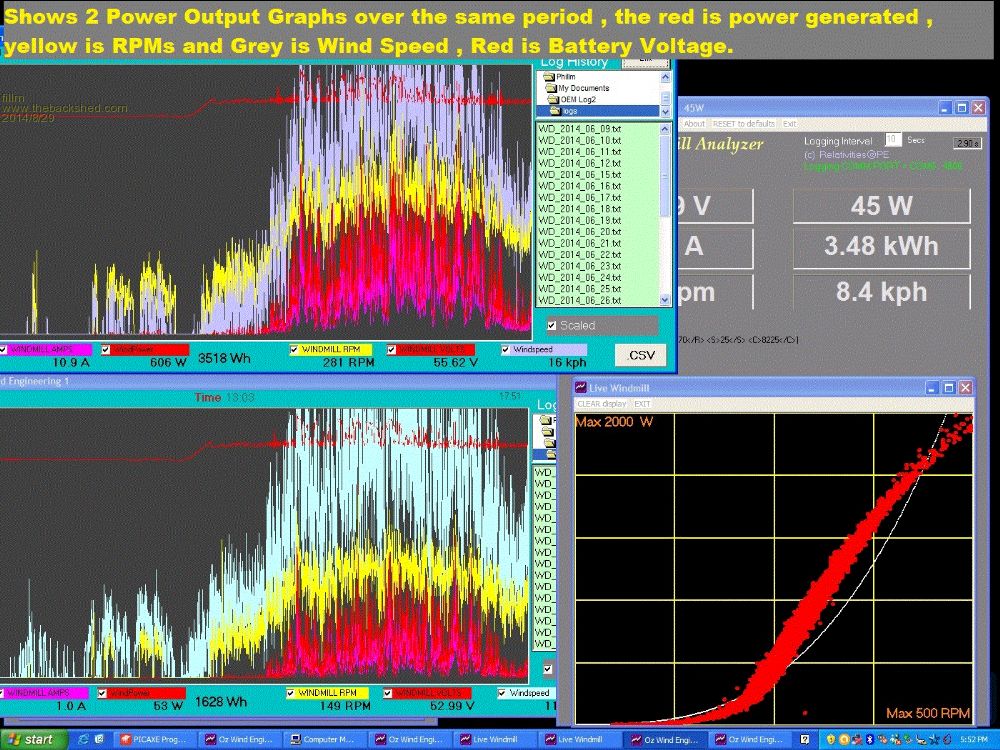

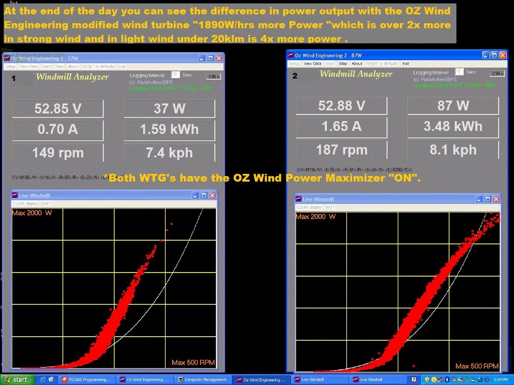

I have logged the OZ Wind 2kw pushing out 2.3kw in 40 ~50klm while the other is struggling to get 1.8kW, its constant yawing all over the place just kills it. From what I see these generators can punch out the rated high power 24/7 and not be affected by burn out like AXFX ( unless shorted in high wind to try to stop).
I have a set of Oz Wind Blades on a "2kw First Wind" in WA that has been through 140klm hitting 55+A @48v all night on one occasion , this is a high wind zone and the blades were made to 3mtr dia , its has been doing great.
Anyway here are some pics and screen shots of the output comparisons, so I'll let the figures say it all. I will say this as well , if you think the numbers are fudged or false , I only wish it were the other way around as then I would not need to build the blade hubs and be able to sell them as a 'top performing wind turbine' a lot of work goes into blade and hub design, building and balancing to make these a top performer.

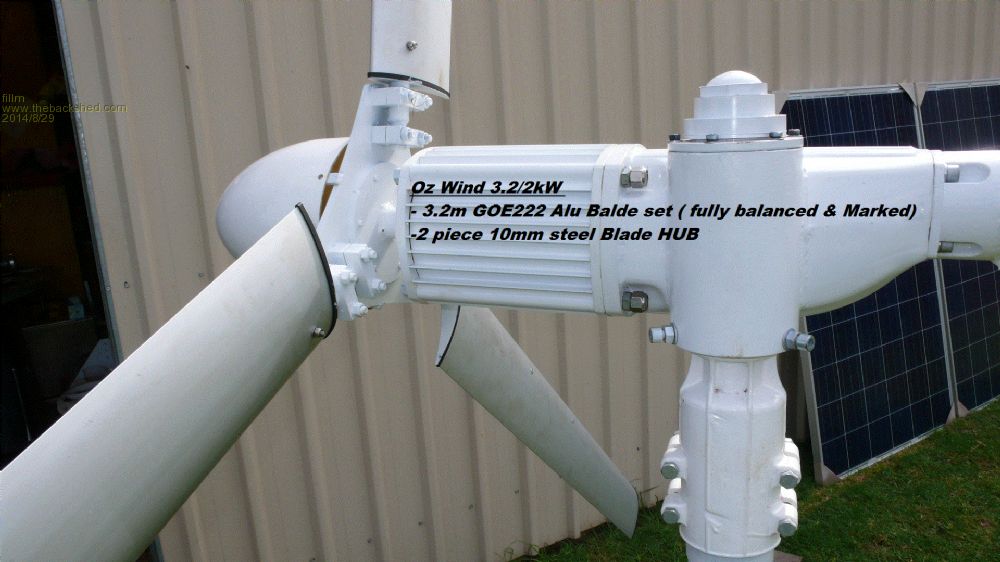

And here are some images of the Oz Wind Engineering 2kw /48V

Verry impressed with the blade performance at low speed as that is what we have most of the time, as for the furling as the Monkey said "that remains to be seen", the Chinese controllers have in the past been disposable items so if you can get that part sorted out it will be an unbeatable combination, from gentle to the roaring forties down south. nice engineering on the new hub it will be a real winner. from a service point of view you could suggest to the makers a parallel shaft and key to make servicing easier as tapers are a pain in the neck to dismantle.

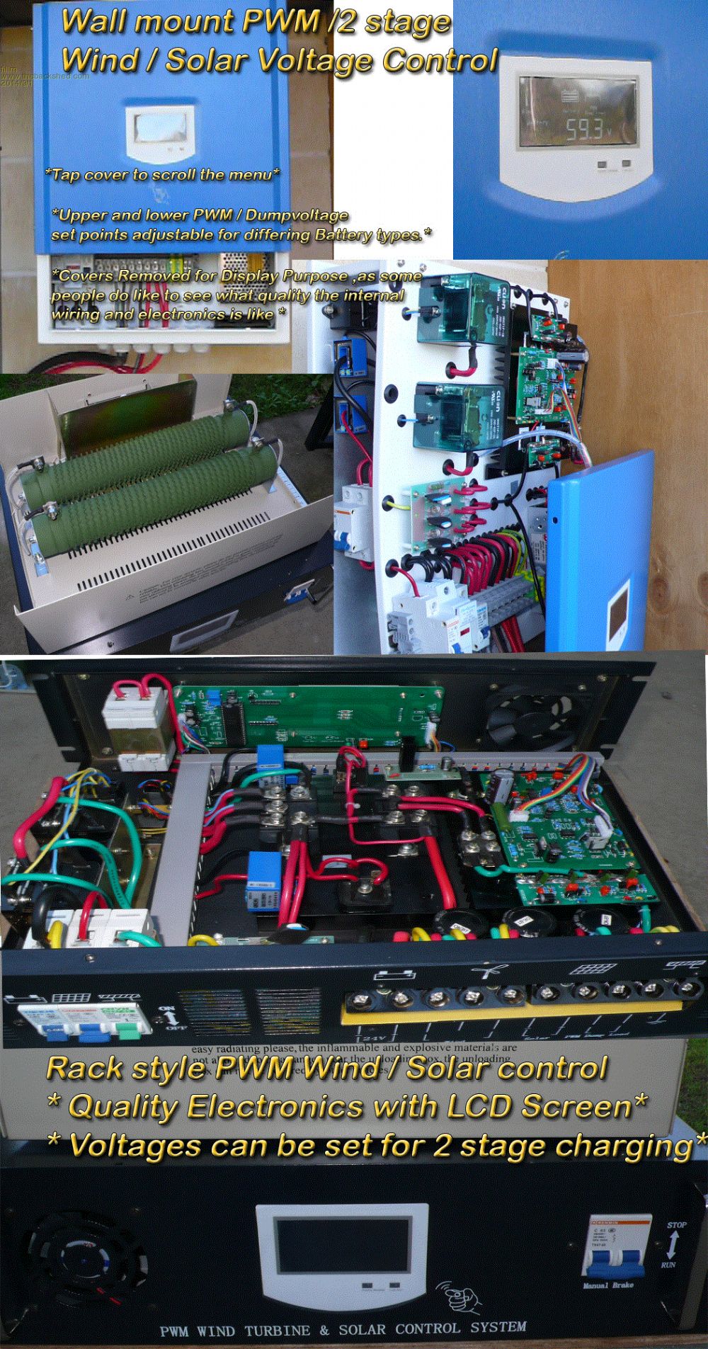

Below is a PICTORIAL view of the controllers. I have selected these types because of their quality over the usual relay type / single voltage dump loads. These will be included as a complete package (Turbine , Controller and Tower) .... as well All will be available separately even to the Nacell / tail / and on etc as spare parts.
Anyway, I have been sitting down in front of the computer for days and days learning how to put pictorial information with text overlay together in Photo-shop. Sorry if it looks like an add ... well it is and labeled accordingly ..... Sorry Glenn delete it if you wish. I have put some pictures of the controls and with the lids off as I know some people here are interested and might like to see whats inside.
I have had the 48v/2kw PWM Control connected and working for over a month and it has been through a couple of good tests. With 2 x 2kw Turbines flying in high wind there are quite few spare Amps floating around. This turbine does not have the GOE Blades fitted, so it sits in the background. But the controller still sees the overall system battery voltage and reacting to that at 58.6V which is Bulk / Absorb the PWM kicks trying to keep that voltage. Then at 60.2V all turbine power is diverted to the 2kW Load Bank very seemless and all with Mosfets. I have had these fitted with 25 Turn adj Pots for fine tuning Dump voltage set points for different battery types. The big relays that can be seen are not used for control , they keep the unit connected to the DC via the breaker switch , so if it trips or is switched off, the turbine load is diverted to the dump as diversion.
With these control unit it can also be connected with 600W of solar , I know that is not much but it can be ordered with a Higher solar input.
I like to test everything that I am confident it all works as it should , in saying that I do not get every turbine then test it for 6 months and sell it as a new unit but I do go over each unit and the GOE blade sets will be balanced in my work shop.

Thanks Phill ,
Different controller to mine ,sort of similar components .
Dump load , neraly the same , my resistors look brown ,but similar
Mine can accept solar as well , but I think 300watts,from memory.

Hi Phill
The controller looks very professional in construction and robust, but I must ask if there is a fail safe should the electronic controls go down, as things fail at the square of the number of components and there is quite a few components in that box.

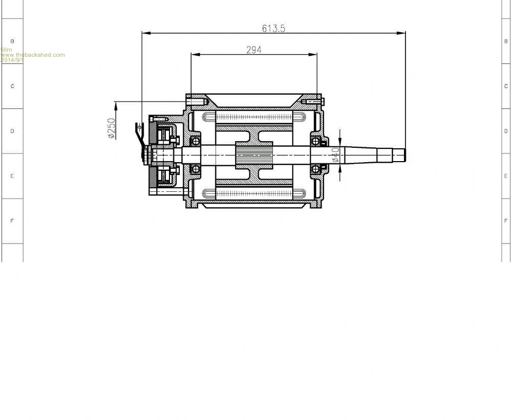

Bruce - This is how its done with a genuine brake as I mentioned in my post, its is a multidisc type of brake attached to the back of the generator and cable operated . I would suggest you need to think more along the same lines and actuating it at tower base via cable. I would not mount calipers on the gen end , the torque when braking will shear the generator housing , that is why huaya developed this brake type.
You could then activate it with you electric linear actuators . I have some here I used in the Liquid resistor .... There are a many ways to do this.
Bob , these controls are very well laid out , the wiring neatness is unbelievable.
I am pretty sure if it looses main power on the 2x 100A large relays the turbine power is switched direct to the resistors
I will be getting a set of pictures done for the tower next. Its heavy duty
3kW Generator showing brake

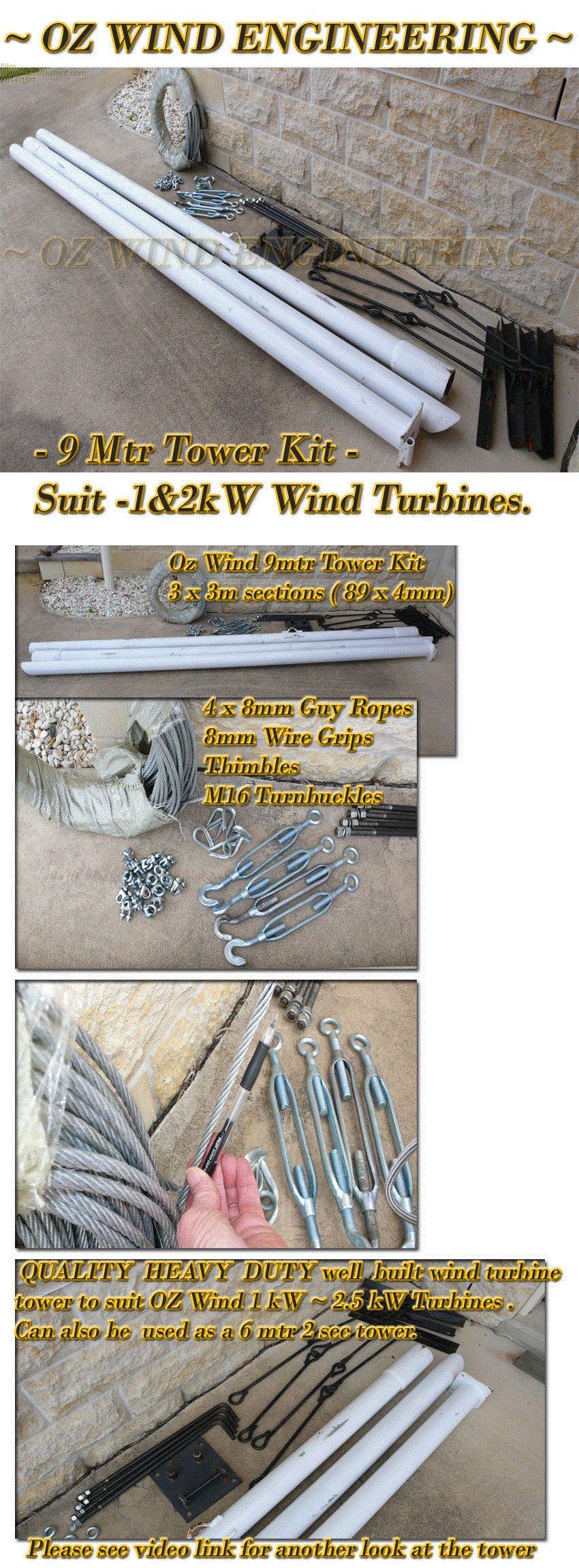

Hi All,
I will just finish off this Advert thread with the tower kit that suits these wind turbines , it is 9mtr x 3sections the spigot together with 45deg cuts on the pipes , this is a clever idea that keeps pressure on the slip joint and keeps it in position . The pipe wall is 4mm so it all Heavy Duty .
All the parts are designed for strength , the wire guy ropes are 8mm and the turnbuckles 16mm , pretty much everything is supplied with the kit except an easy solution to fit a gin pole for raising and lowering. I have taken this oversite up with huaya and they will be addressing it by using a 76mm pipe joiner that will adapt to the tower base or lower section.
This picture is also used in my ebay add, so if you want to see the Video LINK HERE

Posted: 01:27am 01 Oct 2014
Hi Phill
The tower is very impressive should stand up to our occasional savage blows. It will be interesting to see the gin pole adapter,one thought I had was one of those long throw jacks they use in small floor cranes as they are very reasonably priced and would take a lot of the drama out of raising ang lowering the machine. While you have them in a cooperative mood suggest that they galvanize the base and fittings as I have seen masts come down through corrosion, one of mine and it narrowly missed the kids when they where little, one of the anchor points corroded through and gravity took over.
All the best
