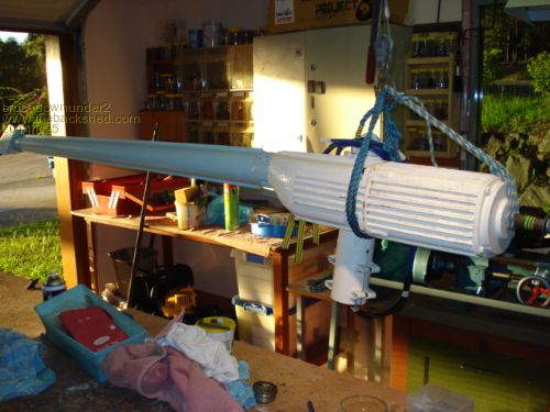

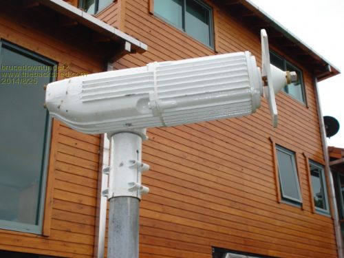

Bryan,and my other interested mates, this is the Exmork body and fron blade hub .
I thought of attaching the disc to the rear of the blade hub and hydraulic caliper to the body of the exmork --plenty of room and I could also set the master cylinder with it's oil reservoir close by-I have all that gear.
For those not quite understanding my project. The Exmork 's tail does NOT pivot, like our backshed and otherpower makes. Just the fin pivots .

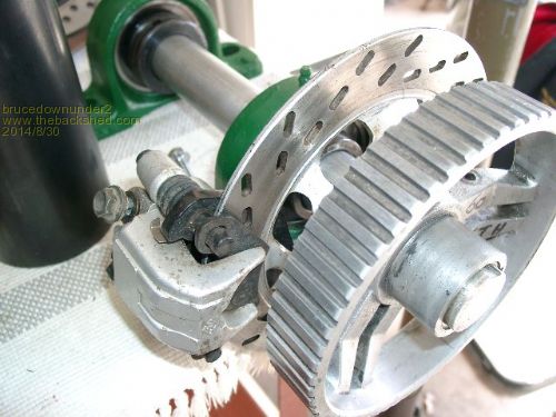

Imagine this disc and caliper mounted behind the Exmork blade hub . the disc attached to the blade hub and the caliper attached to the body --plenty of mounting points. Then the caliper's hydraulic hose to the brake fluid resevoir .
That disc and caliper ,along with the hose ,hydraulic master cylinder and push rod came off one of those fancy italian motor gusi bikes, very strong and big ,so she should do the trick?
There would be two ways of activating the disc brake.
1. A dc solonoid that operates the plunger in the master cylinder .
2. a pull wire through the center of the slip ring assembly down the tower to a hand operated lever or remotely activated solonoid lever /cam assembly to on/off the brake.

Hi Bruce,
Sounds like you have a great plan in the making. Now I did find that test jig and can test it on a brake drum as I don't have a disk brake here. I reckon I do have a few solienoids here that will do the trick. Now tomorrow I will sort out a 3mm cube neo magnet and 1101 hall effect sensor and get them in the mail to you so monitoring rpm will be a breeze.
