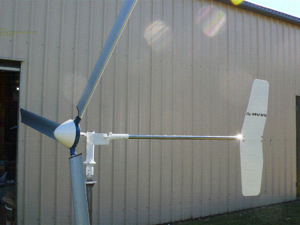

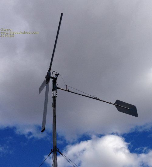

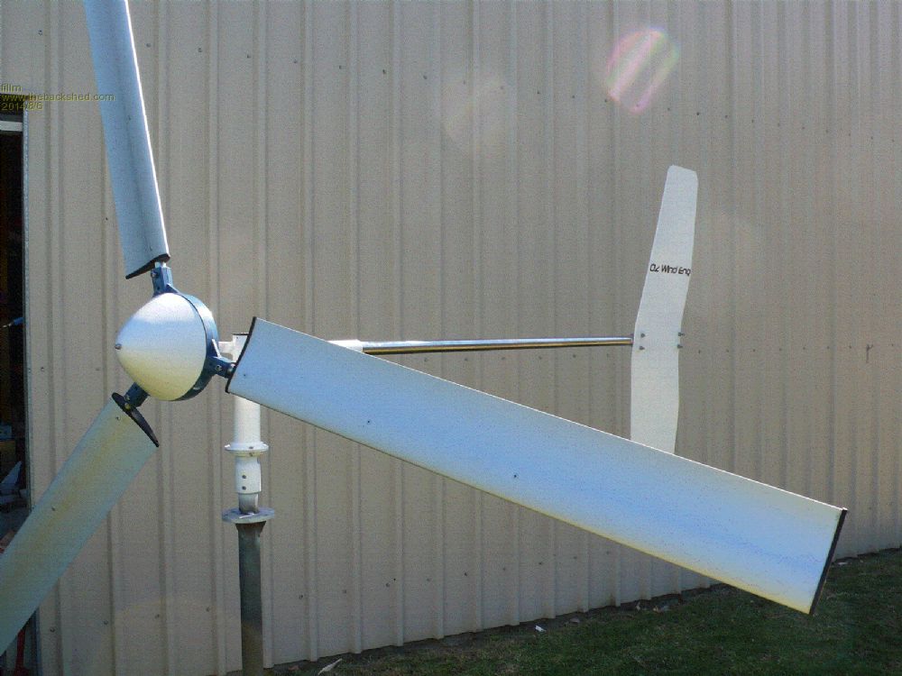

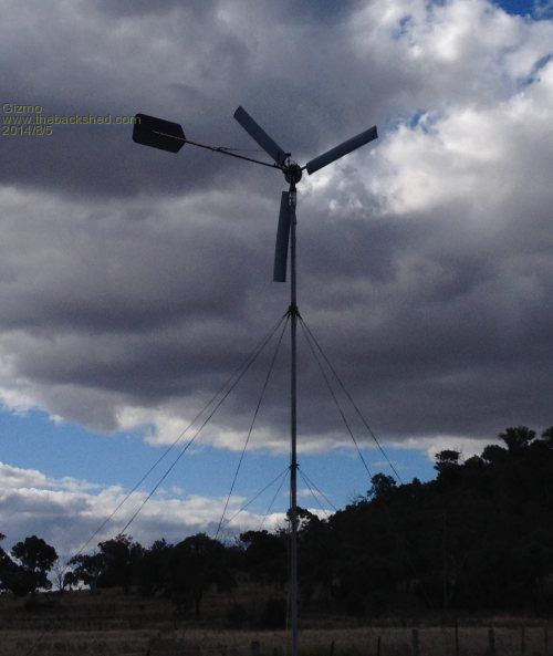

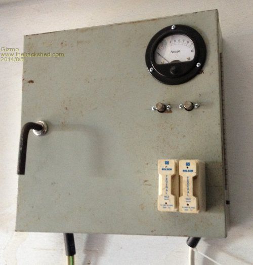

Thought I would share my current windmill. Its a pre-production OEM type that I've had for a while, with a few recent modifications made using help from Phill. Phill has spent a lot of time sorting out the problems with these mills and the end result is pretty good.
The mods include changes to tail furling angles, etc, and I've added a pull to furl cable. I'm still running the standard turbine diameter. Mine is set to furl early, and I see about 500 watts max. I want to keep it that way for now, the winds out here can get nasty. I've also added a LED garden light to the nacelle, just for fun.

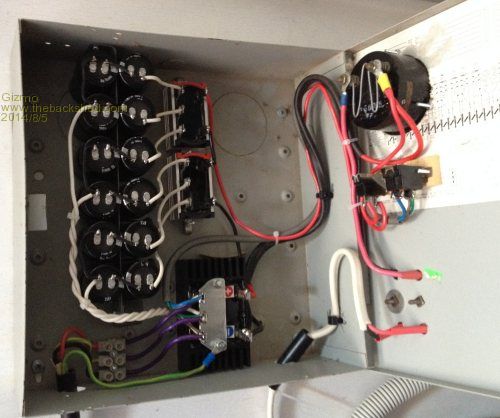

To run the mill at 48 volt I'm using a cap doubler with parts supplied by Phill. Mounted in a old alarm box, includes a amp meter, couple of old house fuses, and a switch to bypass the cap doubler, and another switch to short the windmill if needed. The old fuses do act as fuses, but also a quick way to isolate the windmill from my 48 volt battery bank. I get a lot of wild electric storms, and a pulled fuse provides over an inch of isolation, on both neg and positive.
The cap doubler is working most of the time, and can supply around 5 amps at the higher speeds. Once the winds pick up the windmill output voltage is high enough to drive a larger 3 phase rectifier directly. The cap doubler means I'm making use of winds below the usual cut in speed of this alternator/batter combination.

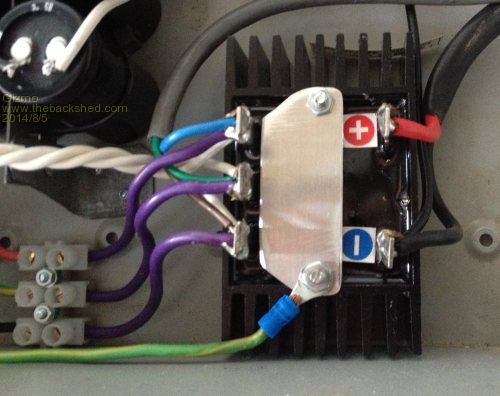

The last photo shows a spark gap plate mounted to the main rectifier. It gives a 1mm gap between the 3 phases from the windmill and ground, again more lightning protecting and easy to construct.

Gizmo,
the wiring looks very neat, i wonder if the solar light would help keep fox,s away with it changing position ect, would you be able to use circuit breakers in place of the old type fuses or are they better as a slow blow type.
cheers stuart

Posted: 08:24pm 05 Aug 2014
  jkis said   Gizmo,
cheers stuart
The fuses are really there to act as a isolation switch. Pulling the fuses gives a 1 inch gap, which is way way more than a regular switch or circuit breaker. Another option would be a big knife switch, but I have heaps of those old fuses.
