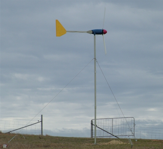

Picture of mill ONE, before tail mods
Sorry about the changes, trying to get the pic size rightEdited by KTee 2007-07-15

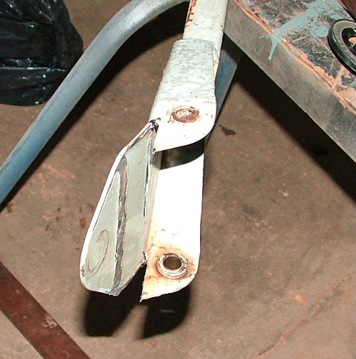

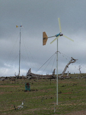

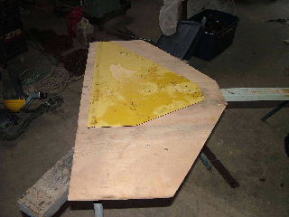

I've got a few pic's for you, they say 'a pictures worth a thousand words'
you can see how Dave (my brother) cut the tail arm to get the added 10 degrees. just weld a filler in the slot and a splash of paint if you are so inclined.
The tail size
The tail was cut from some scrap ply in the shed. I think it was 7mm thick
Pic of the 2 mills, mill ONE is in the fore ground.
