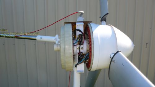

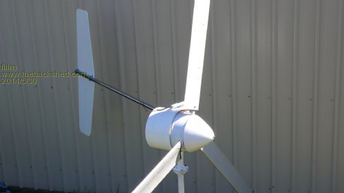

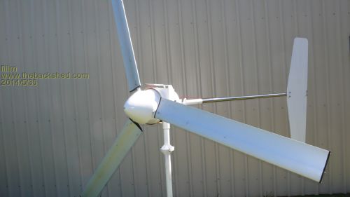

Well thought I would share a few pics and show of the latest F&P Dual from Oz Wind Eng, it seems to be a bit quiet of late as no one seems to be show and telling anymore.
I recently revamped my original F&P design to simplify it to what I think are the best settings for furling and all the rest that I have learnt over the years and then to have most of materials laser cut in steel as well coupled with the GOE222 blades.
Even with the laser cutting there is still plenty of hands on work, and it was not as simple as just knocking it all up over a weekend or two, and there has been some major learning curves with fiberglass and getting it all to fit just right.

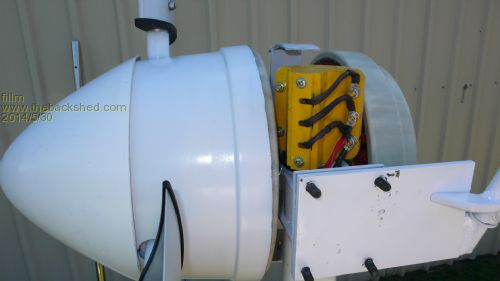

I call this one the "Ultimate" as it has basically the best of everything I can throw into it, with the motors being 1 x 80S and 1 x 100S ( Twisted poles for decogg ) , they are rectified at the mill head and then through 50A Slip Rings / cowlings and then the "manual furl" for positive shut down when required .
The Kits are all in the " Kits & parts " page and have been there for quite a few months now so if anyone wants more info then you can contact me there.
I still think the old F&P is one of the most reliable wind gens out there , I have been down a few roads of Axial Flux and sure they can punch out some good figures but also have a lot of problems with overheating and burnout common place and have proved that a couple of times. Build it strong and The F&P will sit in 100Klm wind all day every day !!!

Pillm,
Great looking turbine. Your attention to detail is apparent. I really like the weather protection you've incorporated.
Have you had the Ultimate up and running or is this the first of the new design?
Curious why you rectified 'upstairs' as apposed to running 3-phase to the controller?
Hope you'll keep us posted. Really nice.

  Quote  Curious why you rectified 'upstairs' as apposed to running 3-phase to the controller?
My guess is, Dual stators = 6 phase, and a single 3 phase slip ring, so easier to rectifier and just use 2 slip rings out of 3 for DC down the tower.
Rather than using 2 x 3phase slip rings.

fillm
Joined: 10/02/2007
Posts: 730
Posted: 12:58pm 30 May 2014
There are cowlings as mentioned,.... but first I ever heard of a stator falling apart from UV , the tub and other plastic bits ...Yes. Why would some one store one on the ground in full sun ?
Anyway... If you did want to protect it better then a bit of paint would be the first to spring to mind.
Pete .. you are right , 6 slip rings is just to many.

Phill,
Looks great! The wire running towards the tail has me intrigued, is it for a LED or a furling sense cable? Easily confused!

Posted: 01:26pm 26 Jun 2014
Sorry Phill, just read the phrase "manual furl" and I can see the red string going down. I believe a F&P cannot be braked electrically to stop a run-away after furling failure, am I correct? That is a pity as a too-high power indication can be sensed.
