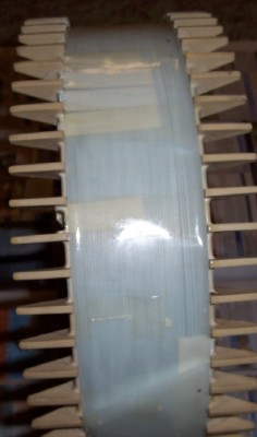

Pic of the first stage of re-configuring the windings --more to come,,,

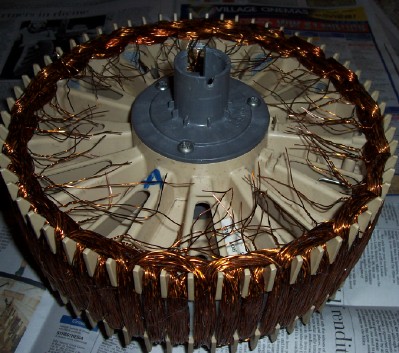

Ok,, over that bout of computa stress-- now ,,down to business.
I unwound the 1st and 2nd coil windings completly--u could keep the wire or discard it -I discarded it ,,as all the crinkels and bends will add bulk to the final windings..
I will cut and "tail-out" starts and finishes of the coils I want to connect to bussbars for series-parallel connections-- same as F&P re-windings...
You will have to purchase some appropriate enammeled wire to re-wind the second and third phase winding coils --- or re-use the recovered stuff , straightening it out carefully ...
So, that's about it ,, a time consuming job ,but quite simple , every coil has 38 turns , so that means the frig door should be opened ,,Oh ,, what the heck !!!

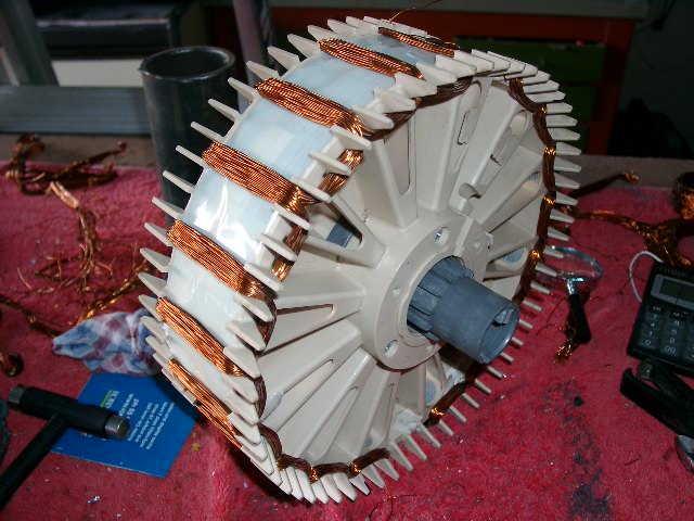

Hey Bruce,
well that was a pain in the ass.
Here it is finised, hooray
prepare yourself for sore fingers. There is a little trick that all rowers will know leukoplast your fingers first.

Hi Gill, 20 coils in series by three phases.
20 magnets
each coil has almost the same length of copper as fp, 60 coils on seeley 42 on fp, so roughly 50% more copper.
Magnets Don't seem as strong, stuff em anyway I'm going neo.
