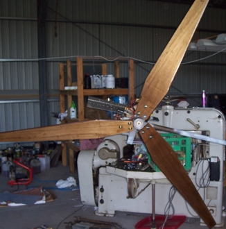

Testing a lightning rod grounded by cable versus grounding it via the tower.
Here
And one that is robust to say the least.
Here

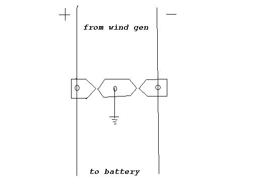

Seems like your in a lighting hot spot. Don't think I'd be relying on a fuse for static protection, that's not it's job.
If you are not always around to disconnect(best), here's a device that may offer some static discharge for protection. Make out of heavy copper. Points don't actually touch but are very close. If 12V, set to car distriutor point gap or just a little less, never more, say 20thou' (0.020"). Rain & weather protection essential.
Alternatively, try a 'Gas Discharge Surge Arrester'.
Altronics cat_RS-5424 . DSE once stocked them as cat R1804 but can't find them listed now.
For the 3 lead type, the two outside leads go to Pos and neg, whilst the middle one goes to your tower earthing stake.

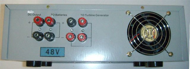

As for the regulator, It could be that the 2 red and 2 black leads are DC. The larger 2(if so) will be the DC charge to the battery. And the 2 smaller(if so) could be Voltage Sense from the battery. This Voltage Sense must come direct from the battery terminals and not via inverter or charger connections to be of any value. It can be a smaller wire, say like car & trailer wire.
The 3 red AC would be the 3 phases, with no order of connection there. And for the black, I can only think it is a neutral/earth wire. I doubt that it is vital, a bit like the Voltage Sense wire, could be left disconnected without bringing the show to a grinding halt.
Remember all this is guess work. I don't know the setup and haven't even seen a picture, but trying to help as best I can.

Just a thought, that may not be Voltage Sense, it may be a general purpose DC supply that has low voltage shutdown. In fact that is the more likely use. A multimeter will tell the difference.
Connect with nothing in it. If multimeter reads battery volts then it is a general purpose output supply for lights/whatever.

Found a pic of a 48v one
Is this what you have Slick?

Yeah Highlander exactly the same they say theyre no good any idea? So the balancing of the hub and blades how? On the ecoinovations site they have one pulled apart and it shows sliprings so im hoping mine is the same mk1or mk2? If i have sliprings the wires will not twist is this right? so ecoinovations fitting a rectafier is this instead of using the charge controller box? Tried doing this in list form but no idea**&&## Thanks paragraphs didnt work either. Gill this is the ones jaycar are selling next to the cows idea Edited by slick 2007-07-08
