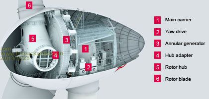

Posted: 10:17am 28 Dec 2013
Windmillfriends,
Where do we start thinking about making small windturbines, working with the same intelligence as the big turbines?
Maybe a model of the Enercon E-126
Regards Jorn
