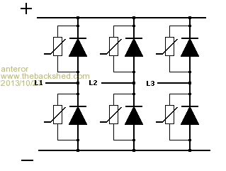

Here is a diagram of tree phase rectifier.
You do not need those varistors (voltage dependent resistor, VDR), which are connected to the diodes in parallel, when you use heavy duty bolt diodes.
