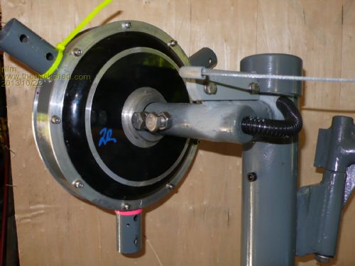

Heres a picture of the manual furl mod for the 500w mills , this works VERY WELL for positive shut down or to leave running at 1/3 power..As I have said previously , if you want to contact me on the latest mods then please do.
