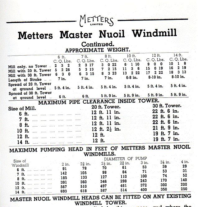

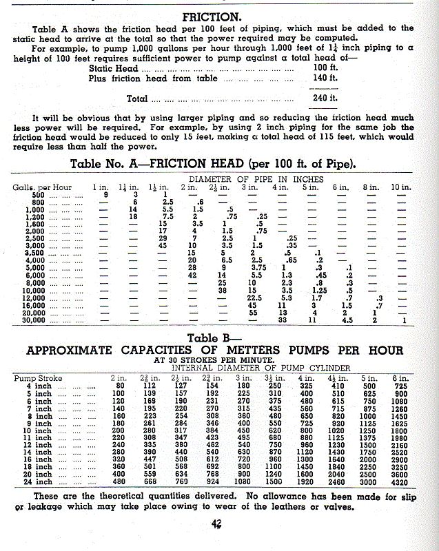

should be enough info here to get you close, you need to know the stroke length that the pump rod travels as a starting point.
30 strokes a minute is no far off, most windmill have the furling set at the factory around that speed or a little faster.
edit: obviously non return valves, accumulators, and getting the pump as close in height to the waters surface (if you are pumping from a dam) and a well set up float and foot valve make a lot of difference to the amount of water pumped and the height and distance you can pump it.Edited by yahoo2 2013-10-04

Thanks for the table. Lots of interesting stuff there, appreciate your help
Raymond.
Posted: 03:57am 03 Oct 2013
Personally i think the table is next to useless for the mill at hand, as where do it show the crank travel or the gearing used for the data presented.
Well and fine to post data sheets but it needs to relate to the mill in use.
Its a bit like posting data for a brand of wind turbine and expecting it to cover all mills.
I worked for a water windmill company about 20 years prior to Mobi owning the same business, and the simple math still applies of pump diameter in relation to stroke length and strokes pre minute = displacement in volume/time.
Count the strokes and calculate the volume displaced.

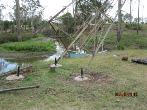

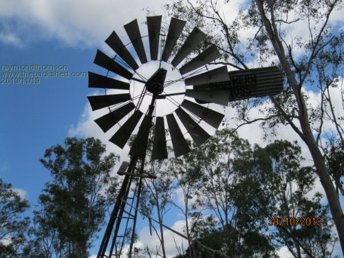

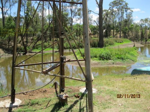

We finally made it! The windmill is up and running thanks to all who contributed information.
The raising process was a bit hairy requiring both truck and tractor in tandem because of damp grass. But the legs were exactly on target and all was well.
Climbing up to put the oil in was an interesting exercise and not to be repeated too often.
The old bore did not perform so the plumbing was re-arranged to suck from the nearby dam. We are in drought conditions and drawing from just a few cm of water but it is working well. I might get the bore attended to when the water table returns to normal but it is very old and a blast of water down it produced a heap of rust so we might stick with the dam water.
It has been a great experience and satisfied the objectives of aesthetic appearance, preservation of an Australian icon and of course the practicality of pumping water.
