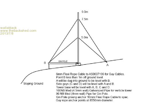

Firstly, a quick drawing of the tower...
Basically the main tower is 100Nb and the gin pole is 90NB pipe, both medium.
Rule of thumb is generally to keep all guy wire anchors level wit the base of the tower so hence the above high ground gin pole, this is ensuring "B" is level.
The first guy rope is at 5m and the top guy rope is at 7.5m.
The VERTICAL tower is constructed from two pieces of pipe, 1 @ 6.5m (standard length) and the top piece being 1 @ 2.5m.
These two pieces of pipe will be fixed together using an AS2129 slip on steel plate flanges welded to the end of the pipe, each flange has 8 x M16 bolt holes.
The guy cables are 6mm 7 Ton BS flexi rope cable (Steel, Galvanized) and to AS0607196 regulation.
So all this is up to specification and strong as an ox my main concern is the base.

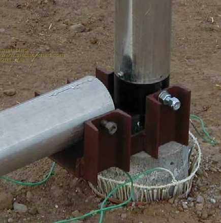

The above image is another one I semi like. Nice and solid but totally relying on bolts to keep it all together. has the advantage to be checked very often and any maintenance can be done at ground level with zero fuss. I guess it also had less part really as it is only two plates exactly the same and a pole from the ground for it to swing/mount on.

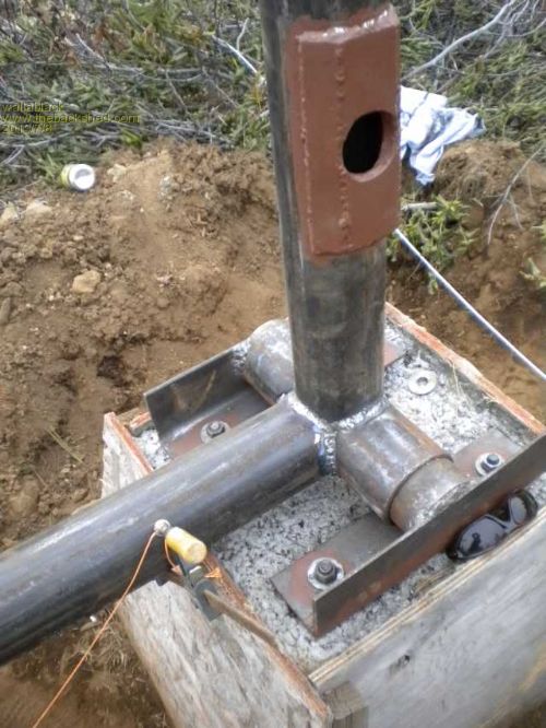

And above is the third one. I like this idea but there is a hell of a lot of fabricating and you would need very good welds. it just looks like too much to go wrong.

Yes, I like the middle one ,second one ... You can disassemble it for re-painting ,etc.
Easy to make, fairly adjustable if the holes are a wee bit larger ..

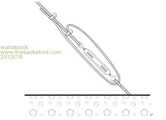

Cold Gal everything inside and outside (if possible) then use Epoxy paint on all steelwork... Guys --get your top ends Swaged onto gal thimbles (those heart shaped things ) . Bottom .,leave a bit of slack for adjustment and tighten with "crosby" clips (those things with a u bolt and a saddle ) .

Using bolts to secure a tower is asking for a failure as tower vibrations can and will loosen bolts....

No gussets for the welding and look at the plate where the hole is cut, welds around a pipe causes stress's that can and do fail and as the pipe is welded @90 degrees it would of been easier to bring the wires out where the sun glass's are.
Just remember Murphy(that great guy) is just around the corner and ANY bodgy work will give him a reason to come around. When welding pipe towers it is OK to weld ALONG the pipe but to weld AROUND the pipe is asking for trouble down the track if that weld isn't properly supported using gussets or a clamp that goes around the pipe, then that said clamp is welded on one side ALONG the pipe and guy wires can be attached to that point.

That diagram in the first post is a bit misleading, It does say A B & C must be level but the diagram looks like A is higher up on the slope.

I am using 3 swages (copper/nickel coated) per guy rope end at the top, it is also necessary to use thimbles to ensure the guy rope is not bent on such a sharp angle as this would cause unnecessary wear. Also the reason I am using flexi cable to AS0607196 specification. Non flexi cable would break and this is recommended for guy ropes with high strain. It also has a breaking strain of 7T so it is spot on. I never knew they were called Crosby Clips so we learn something new every day huh. The bottom will be double looped with the use of Crosby Clips and again a thimble as the drawing below depicts. The tensioners I am using have rings in each end and a 40T load rating.

The second one relies wholly on that one single bolt, great idea with the two plates but the "swing mount" bit could go an upgrade.
The third pic...I am pretty sure there should be more than those 4 bolts to secure it to the footing. "Bolting" the base to the footings will be done with long "J" shaped hooks threaded on the end to form the "bolt". The bottom of the J will be almost at the bottom of the footing slab.

  Madness said   That diagram in the first post is a bit misleading, It does say A B & C must be level but the diagram looks like A is higher up on the slope.
Yeah it is a bit misleading, I just whipped up a quick drawing on paint.net to give a visual explanation rather than trying to explain it and confuse everybody.
C and D are already almost level as the ground is close and the footings will leave them spot on. I am going to dig a trench into the ground leading up to the footing on A as it is a lot higher than the base and I plan to build a small wooden or concrete "box" to keep this trench clean and keep the earth/dirt at bay.
