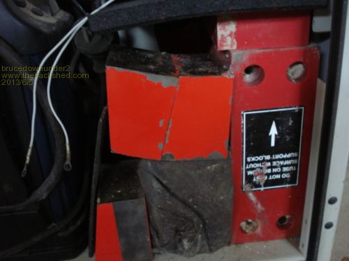

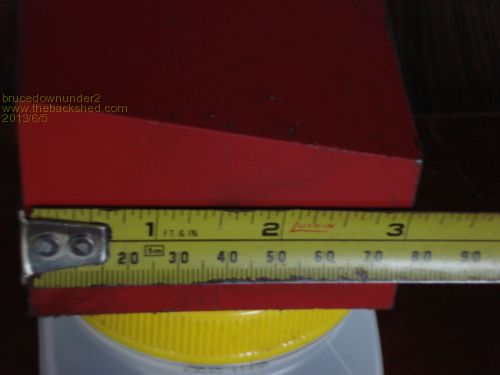

I took some Pics yesterday ,.
I was thinking I could have these cut into fairly large square magnets ,,say, around 75mm square by 25mm thick -I'd get round 36 magnets ..
The holes in the magnets are fairly rough sort of as if they were put in during the mould filling process,,not a smooth drilled hole that a drilling operation would achieve. The two magnetic faces are very smooth "chrome" like surfaces.. If you attach one of these surfaces to a steel surface ,you CANNOT pull them apart by hand.
Bruce
