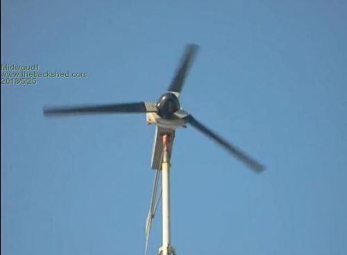

I have an active-pitchcontrolled windgenerator 3 mtr.prop succesfully 2 years .
With an actuator and micro-controller Arduino
- Frans - (midwoud1)

Hey Midwoud,
Nice work. Why you have black-colored blades?
Greetings
Jorn
Midwoud1
Joined: 25/12/2012
Posts: 23
Posted: 04:46am 31 May 2013
Jorn.
I painted it with matt black lacquer, to avoid sun-blink reflection.
And quick snow drop off.
Rgds. - Frans -

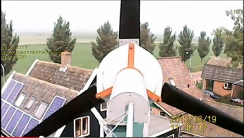

Windturbine cam variable blades
http://www.youtube.com/watch?v=69HZD4rG__U

Midwoud1 do you have to climb up to the generator to retrive a SD card or is there a data cable connected to the generator?
Would have been nice to have a rotatable camera on my generator 24 Metres off the ground.

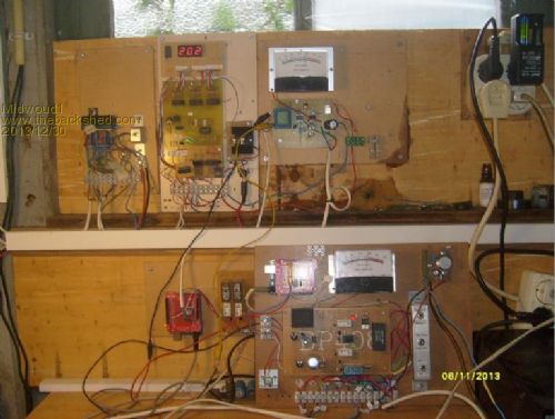

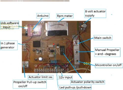

Test setup electronica circuit, active pitchcontrolled blades .
Controlled by Arduino . Constant speed system.
Rgds: Frans.
