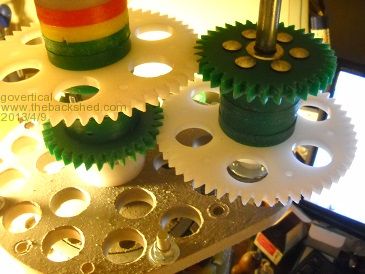

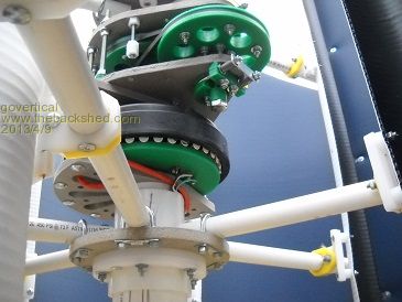

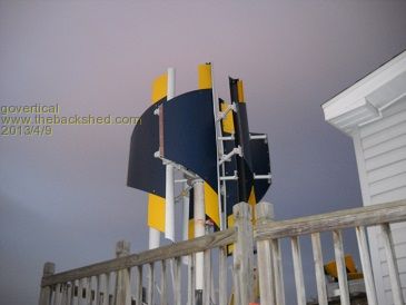

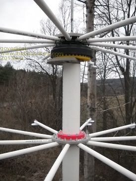

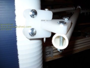

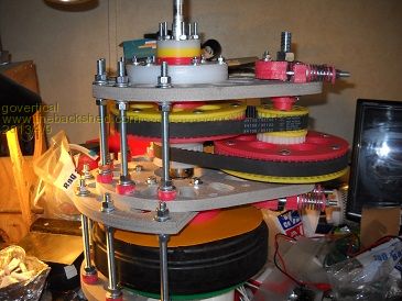

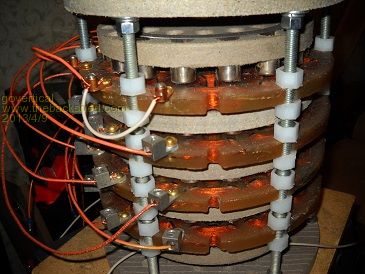

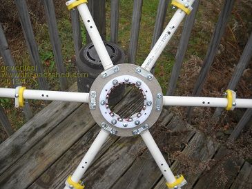

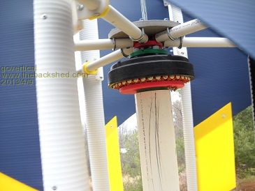

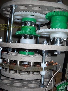

Hi, I am working on a similar project. Just some photos of my gear drive.
The link will tell you about how much power you can generate for a set size blades and at what windspeed. A 4x8 foot VAWT should produce about 5 amps at 10 MPH using a 12 volt battery as a test load.. You may need a power conversion circuit to prevent turbine stall. I have been testing with a modified F&P. I plan to operate more than one VAWT in parallel. I am working on the control circuitry now. I am still testing, good luck with your project and I hope to see some more photos.
goldhunter_2

you have put allot of time into yours just form looking at the pictures nice work. and that link is awesome Mine is smaller its just meant to be a test to see what type of performance I can expect over a several month period before building something bigger but that link you provide will be a handy thing for estimating .
What thickness material are you using to cut those polymer gears out off and aren't you concerned with melting/heating up the teeth in a higher wind situation?
I see your using larger gears like warp mentioned earlier what did you end up with for a final drive ratio on yours?
