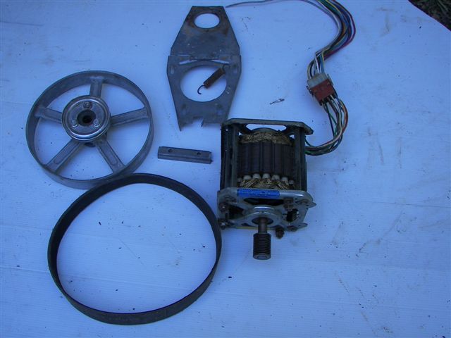

Here are some pics of a PM motor I stripped from a more conventional F&P washing machine some time ago.
It is a General Electric, permanent magnet type, 3 phase Star, and I'm guessing 2 speed.
I did not take down the model number though.
It had step down gearing to the main shaft via one of those flat-grooved belts.
Cogging is not excessive at about the worst of a smartdrive by guesstamation.
Thought perhaps it would be more suited to a waterwheel or perhaps vawt application.
Any ideas or background history appreciated.
Cheers Gill _Cairns, FNQ

Hello Gill,
I have 3 of these motors,I think they were referred to as the "Gentle-Annie" type F&P motors(made by??) ,.
I bought all the leads out and tried different combinations on the test bench,years ago, but from memory didn't go much further.
They are still wrapped up and one day ,I'll set one up again ,as I even made a welded up steel frame .
I cut the grooved pulley off lengthwise,it then springs out a fraction and you can pull it off easy without damaging the shaft.
They are a bit "coggy" ,but as with the new F&P once started they offer no cogging.
I pulled the magnetic rotor out of one and dismantled it . Nice 3 semi-circular ceramic magnets that are bound with very fine steel wire,don't know much about that reason>
Bruce

I'm cautious of stripping it down as I suspect there is little, if anything, that can be done to make it more suitable. That belt drive might be just the thing needed for a waterwheel idea i've been toying with. Would hate to cut it off to get inside only to find it was best left as is.

Gill, The blue rotor which appears to be in three sections also has eight poles,4 Nth,4 Sth, if that is of any interest and I would guess that the wire around the outside is not steel but another non magnetic metal bound to hold it together.
The shaft also presses out of the centre of the rotor and if you were prepared to rewind in copper it could make a good little 3Phase genny.
I had a complete motor but I am only left with the rotor and now looking for an AC motor the appropriate size to install it in.

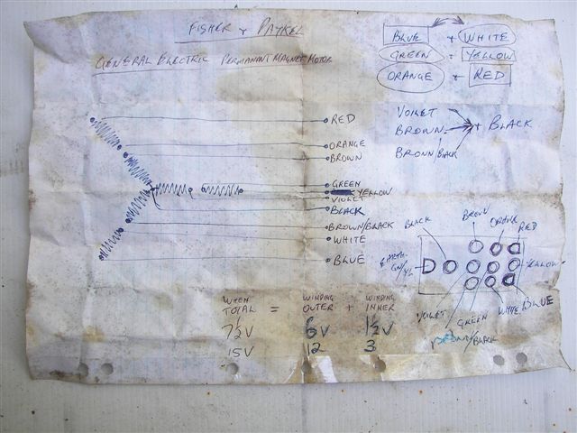

Hi Gill from the brown terminal block remove orange, white, and the green, colured wires[not green and yellow] and join together.This is your star connection. Remove red, yellow, blue,. These are your three phases and then go from there.I will be commisioning my first attempt in 2-3 weeks using one of these on a 1.2m prop. Dont expect too much from these little motors but at low revs on my lathe it gave 1.25 amps. at 30 volts.Five amps would be an absolute max but my lathe didnt give enough revs to get up this high. I did get up to over 100 volts but dont remember the amperage. Good luck. Maaca.

From the comments, I think I would be inclined to connect the inde windings in Delta. Rectify that,then series that DC with the rectified DC star windings. No problems doing this as all perfectly synchronised. Achieves somewhat more amps whilst maintaining volts. Shame to waste windings and a bit more grunt for the mere cost of an extra bridge?
