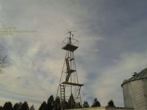

I have this 12v five blade turbine set up just out side of town at a friends place in the country. He has had winds that reached 126km hr or 78mph afew months back when Hurricane Sandy came through this area. We have the turbine wired to a very large fork lift battery bank and its on a 45 foot tower. The furl or over speed control is handled by the electronics which will put a heavy resistance using the dump load. It seemed to work very well as the turbine did not fly apart and still runs smooth. I have designed this varible pitch hub that will also help with the over speed. cut and paste the youtube link. not sure why this link will not work on this forum.

Here is a photo of the 12volt turbine set up in the country.
